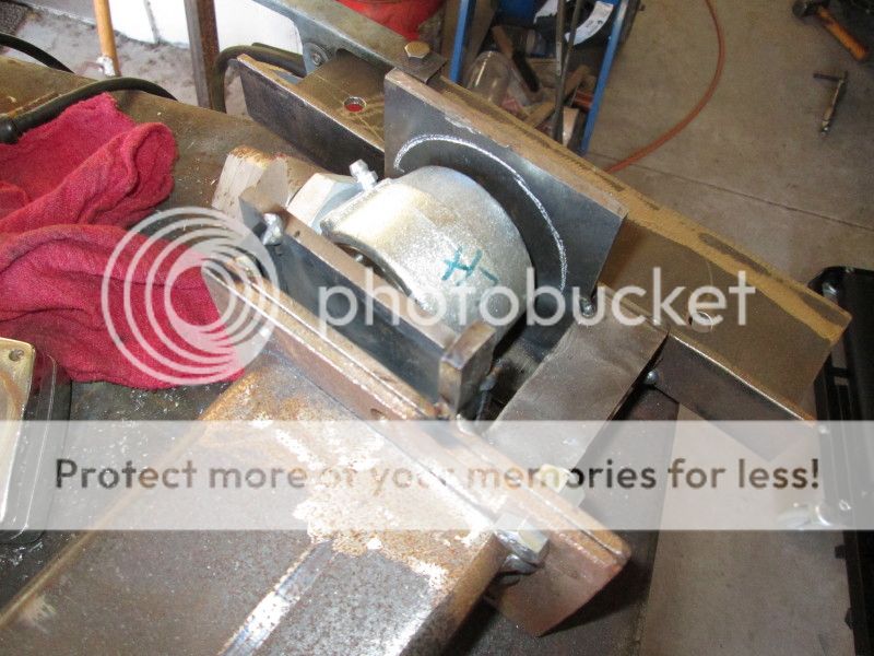

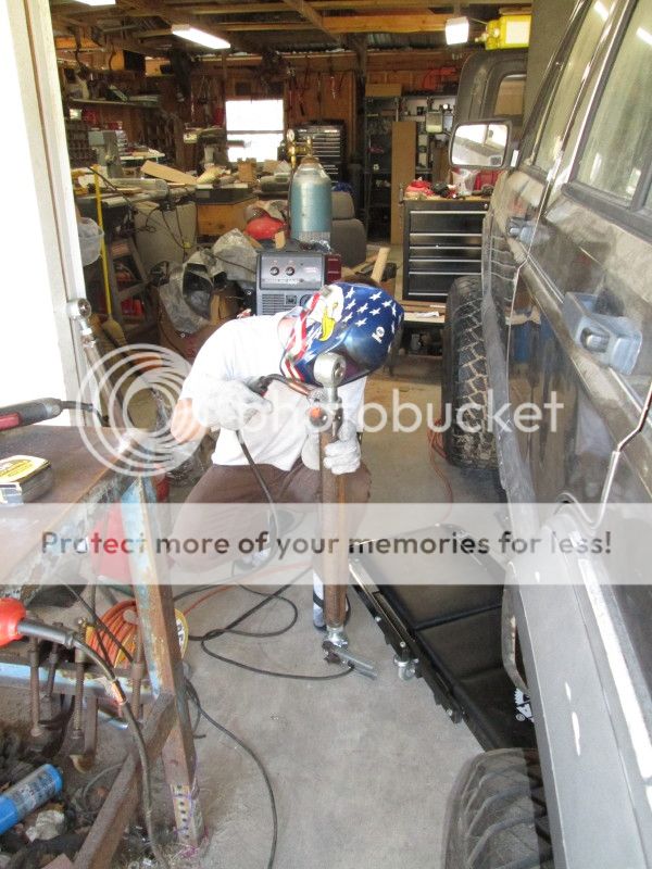

We have been very busy these last few months. The Jeeps have just been sitting. I finally got some time, and some motivation, SIMULTANEOUSLY! Fallon and I started assembling the lower control arms, tacking them to gether so we can mock them up. But where in the world is my jack? I need my jack! It's gone. My neighbor borrowed it 2 days ago, and I didn't even know it. So on to something different...

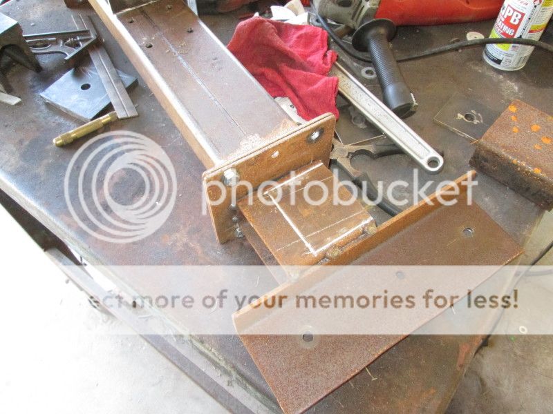

Fallon is cutting out square pieces that will become the brackets at the crossmember.
The pieces are tacked together so they can be made the same size!
The bracket pieces shown are our first attempt and too small (3"X3"). We made them larger at 4"X4".

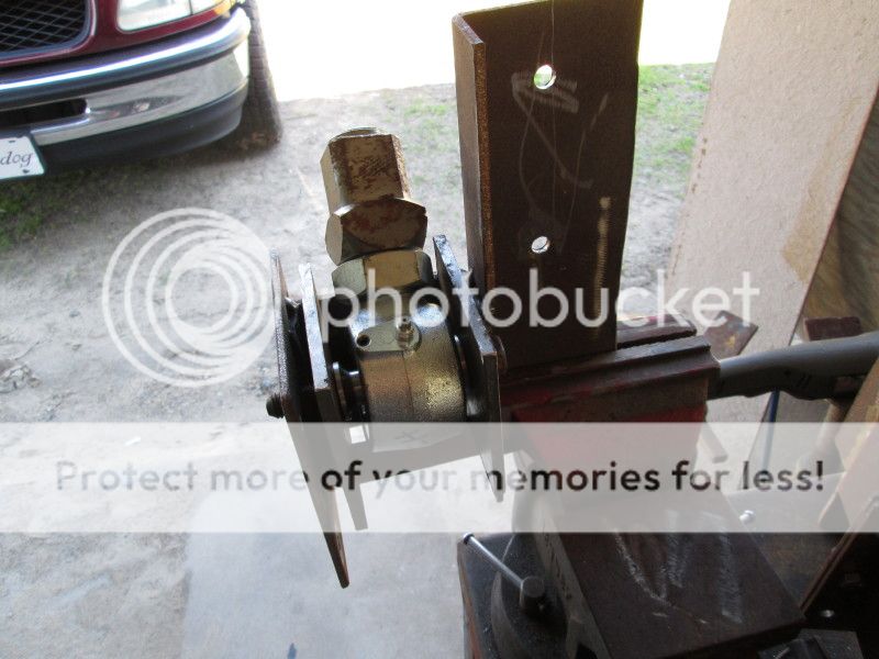

The rest of the pics are just tacking up J joints to the comtrol arms. I discovered that the RH joints were not threaded all the way through the tube adapter, and I had to chuck them up in the vise and use a big wrench to cut the threads.

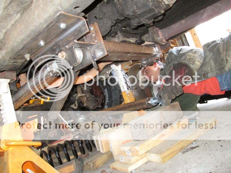

Longarms are installed (mocked-up). I think I will have to make longer tubes! I cut the tubes at 25", with an adjustability of about 2". OA length, without any adjustment, is 34 3/4" from the center of the bolt at the xmember to the center of the bolt at the axle.
How do I figure length for the upper arms?

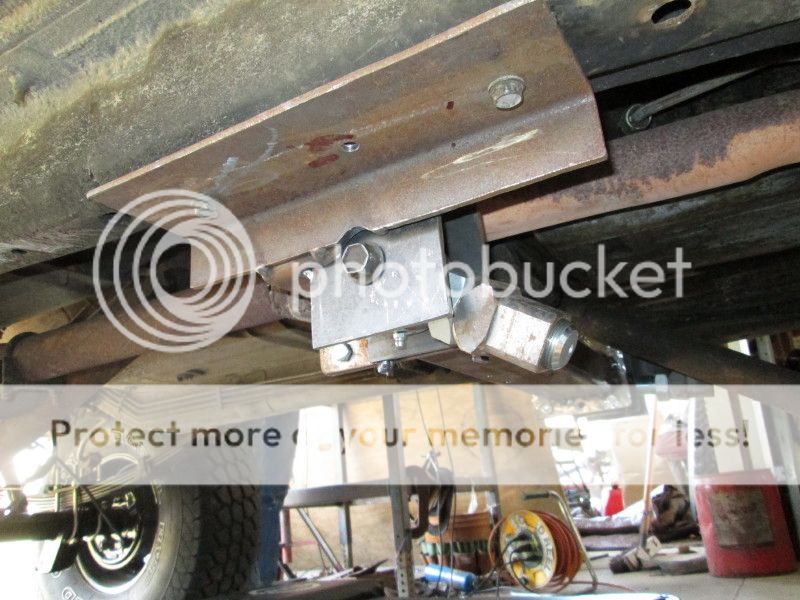

Here is the xmember roughed out. LA brackets will go at the chalk marks.

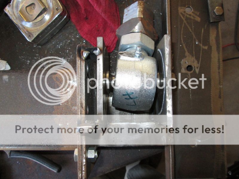

Bracket with JJ mocked-up.
This is the bracket that is evolving! I can't believe it has turned into something so complicated and time-consuming.
Here's another view.
Fallon cutting the tube lengths.
Clayton tack welding the LAs together.
Unit is mocked-up under the Jeep. There is MUCH trimming and finishing yet to do. Don't git'cher pannies ina wad!
Fallon connecting the passenger side LA.
Springs are back in place. Trackbar is back in also. I really want to just back it out of the shop, but everything is only tack welded! Must. Have. Patience.

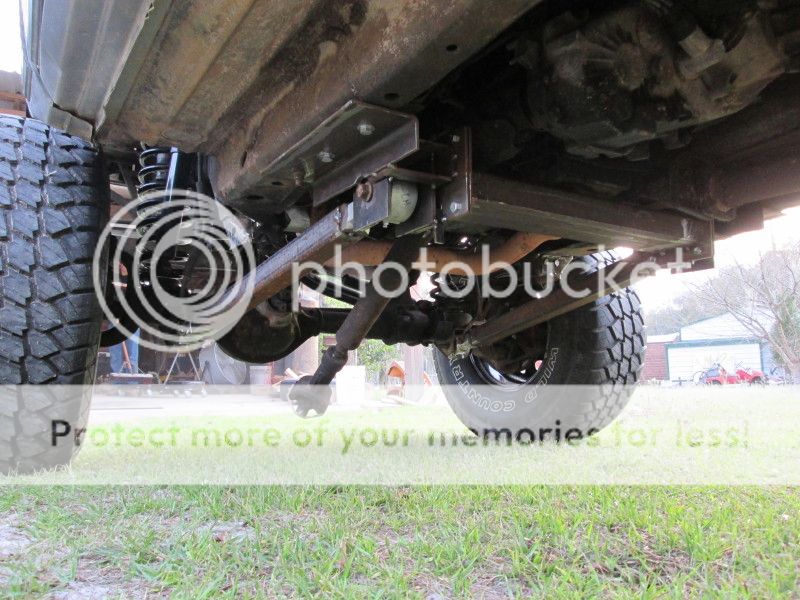

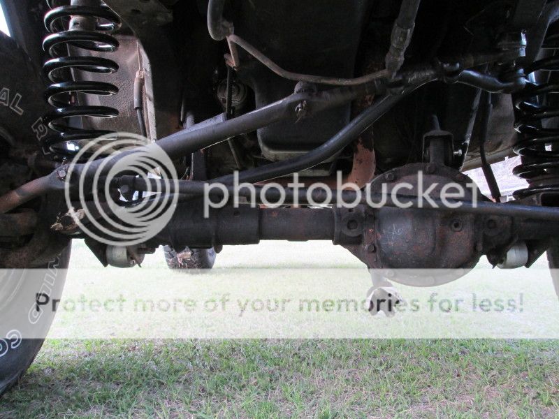

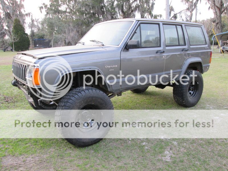

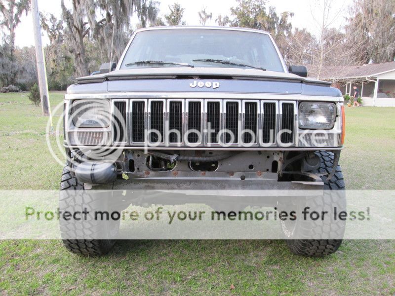

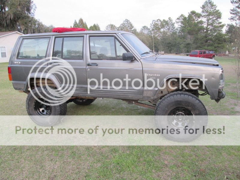

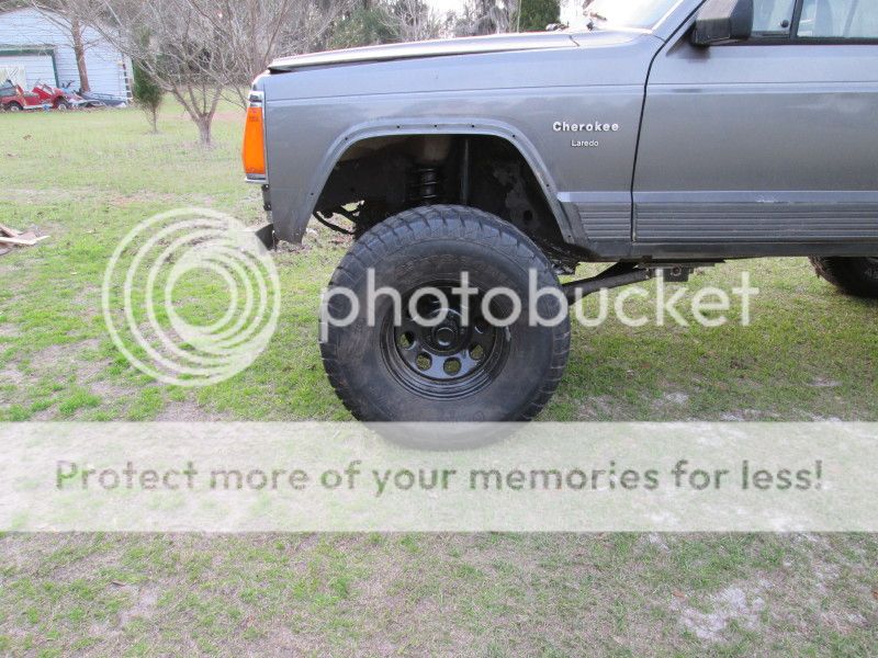

I backed the XJ out of the shop just to do it! It was GOOD to see it out in the yard. Here are some pics of where we are. I need help with determining the front axle position. I think I'm close, but I want to more opinions.
Driver's side.
Front.
Pass side.
Here you can see the tire is not centered in the wheel opening. I think it should go forward a couple more inches.
Here is the trackbar and draglink compared. I think this came out well. I lengthened the trackbar, but I don't plan on keeping it. I plan to use an adjustable one. Unless this hits dead-on!!

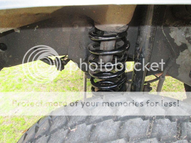

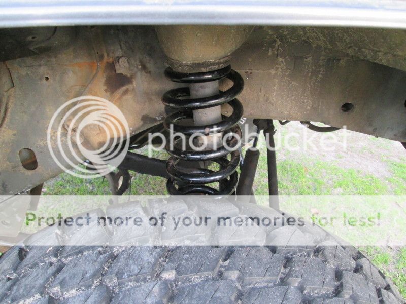

This is the pass. side coil spring. Notice how it is angled. I think this confirms my lower control arms are too short. Can anyone confirm??
Driver's side coil spring.
This is what it looks like under the Jeep.
And some Jeep sweetness!
C'mon, Guys. I need your input. Thanks.

The trackbar and draglink did come out well and the XJ is looking good!
I totally agree the front axle needs to come forward some.
