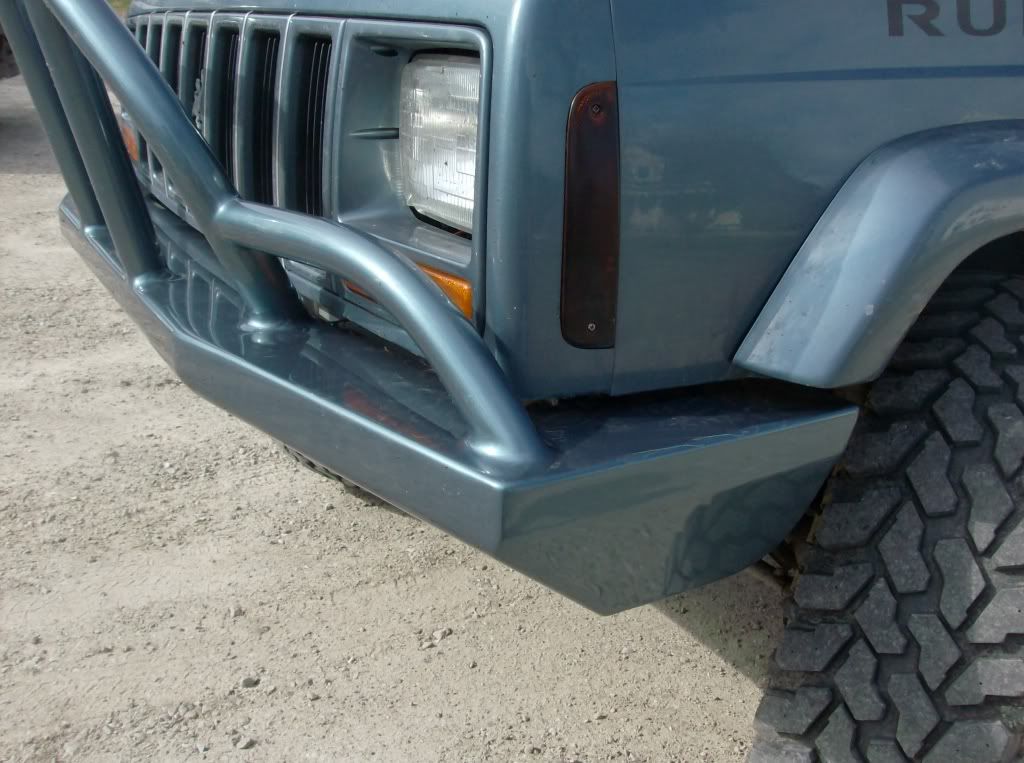

post #72 of 77 Old 04-02-2011, 04:50 PM Thread Starter
Brookhart63
Location: in a Cornfield
Posts: 1,395

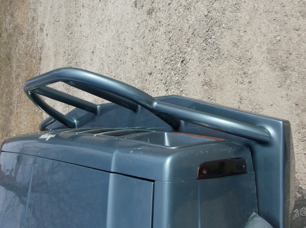

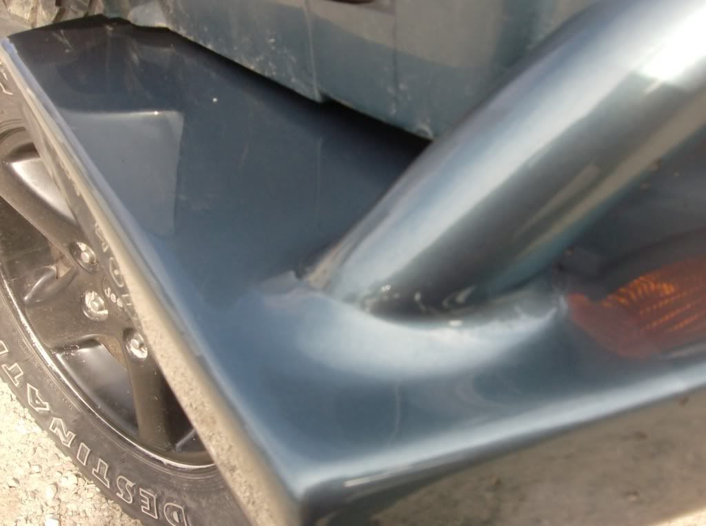

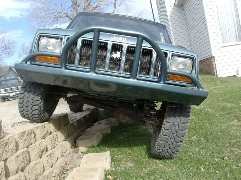

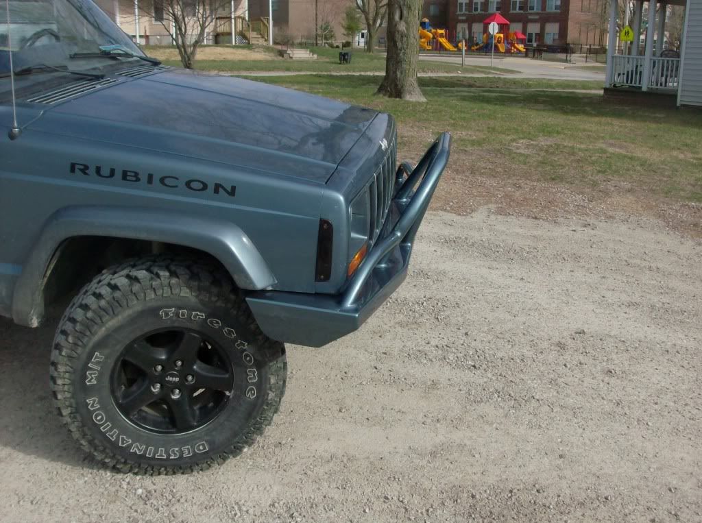

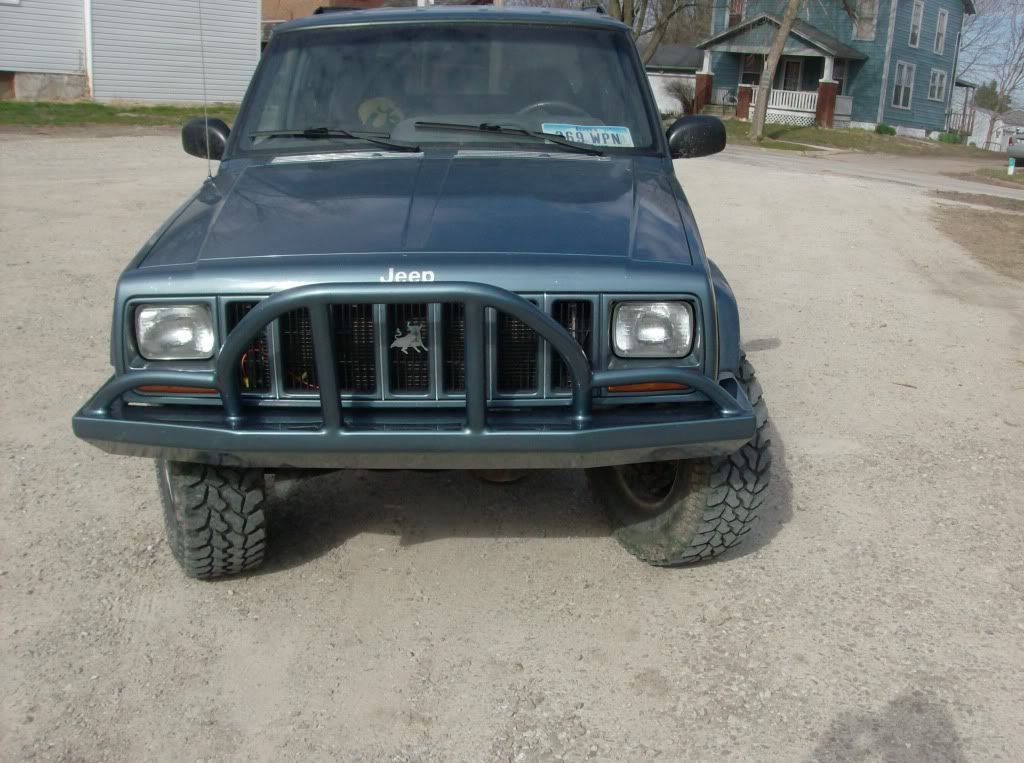

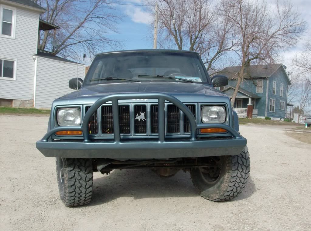

Hello everybody. Finally got this thing done. It was painted by Midwest Body and Frame. Elvis did a great job. paint code PQ7 and this thing looks sweet. My dad was a huge help on this project and he made me slow down and think about everything rather than rush through and wing it. Dad spent 20 plus hours smoothing this thing out. So here it is!
Thanks for the help everybody. I have gotten better at welding and since picked up some hotter burning wire that penetrates deeper. I will have another build in a couple of weeks for the green jeep and that one will be much simpler.
Brookhart63 is offline

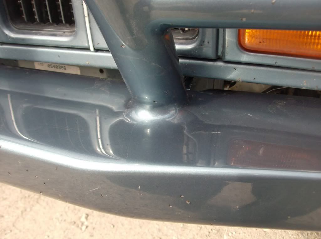

post #73 of 77 Old 04-02-2011, 04:55 PM
The_Blacksmith
1993 XJ Cherokee
Location: New York
Posts: 2,870
deffinatly needed recovery points.
Grinding down welds makes them much weaker.
Thanks Chris!
The_Blacksmith is offline
post #74 of 77 Old 04-02-2011, 04:58 PM Thread Starter
Brookhart63
Posts: 1,395
Yeah i thought about that so thats why the recovery points are going on the unibody tie ins. I didnt grind any of the welds that really hold anything just the ones the needed to look pretty.
