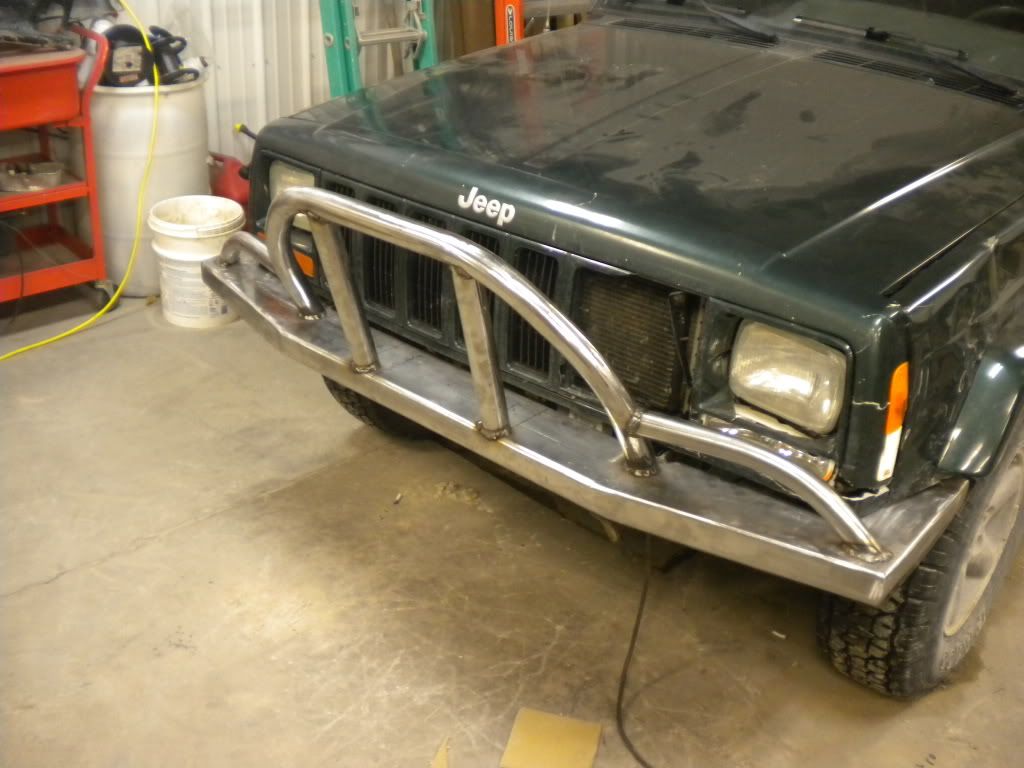

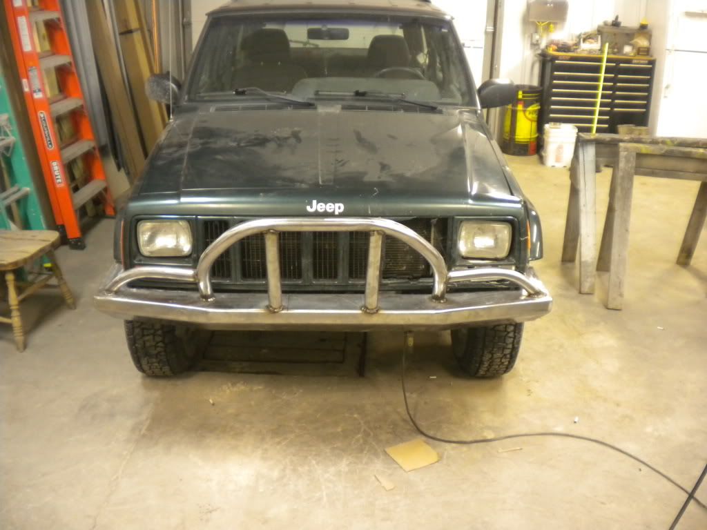

Definitely tie them into your steering box with an aftermarket steering box spacer. I recommend just picking up a set of these(as much as I hate JCR, this is just an example) and then build your bumper off of them.
http://www.jcroffroad.com/Merchant2/...egory_Code=XJB
I just noticed something... If you go with oversized tires/lift on that rig and expect to do some flexing, you'll have to cut those returns along the side shorter. My 33s rub on my JCR bumper ends at full compress on both sides just barely and I added 2 inches of bump stops. Of course you mentioned it's a DD street rig, so you will be fine. It sure is beefy!

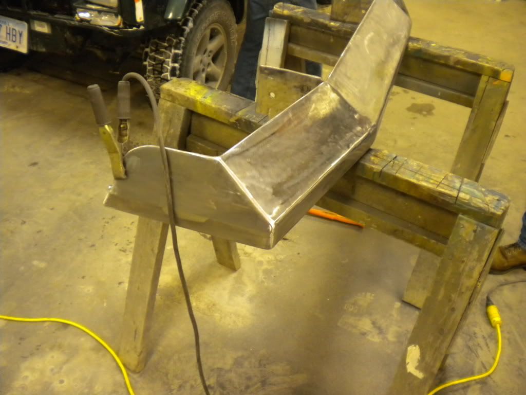

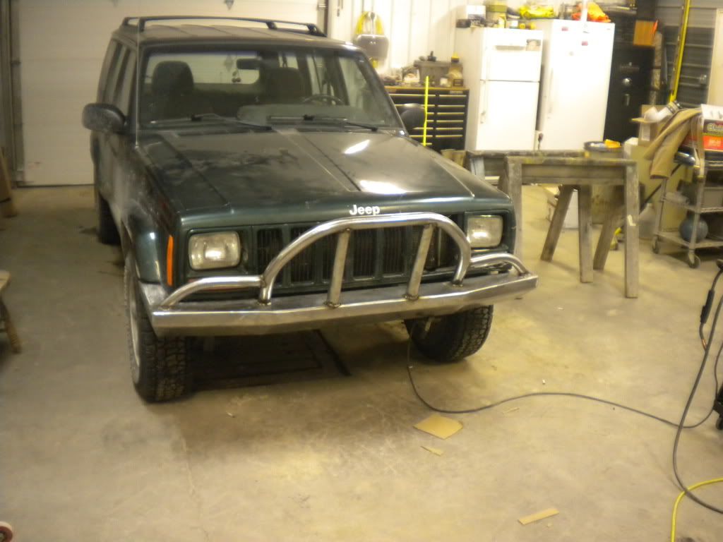

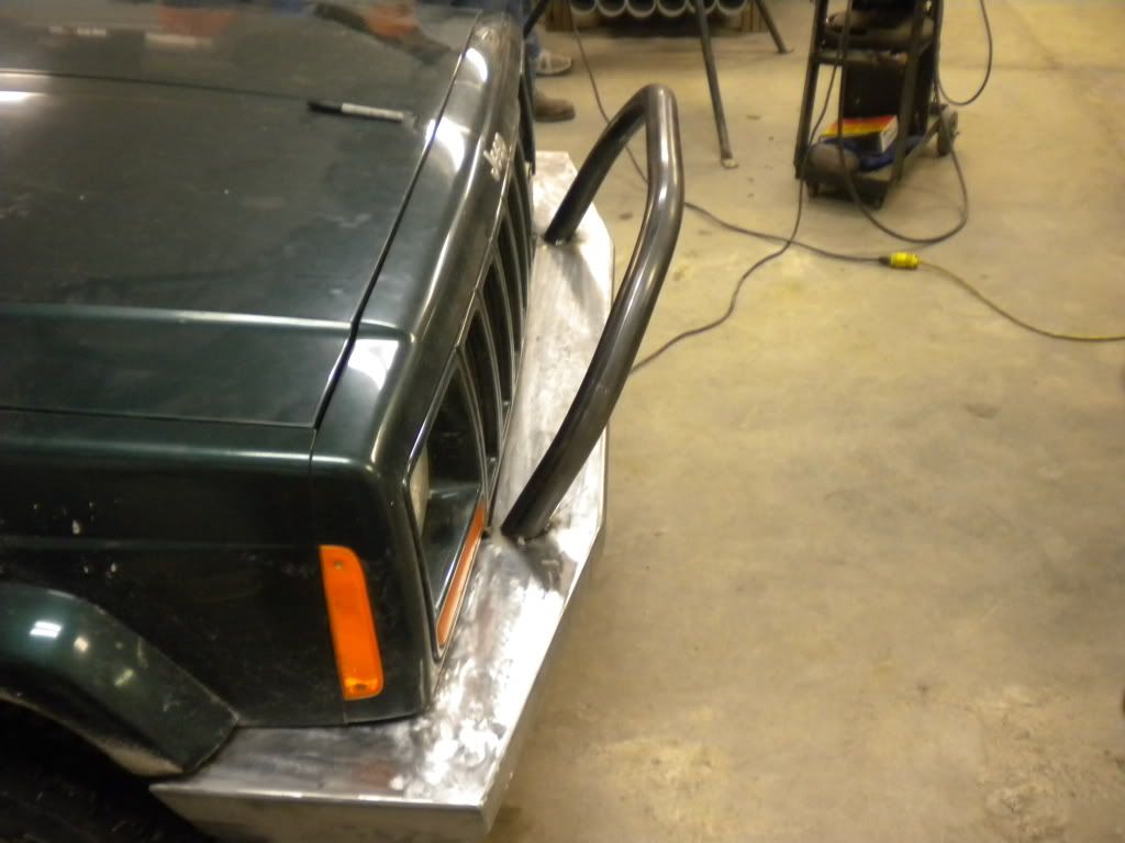

thanks paraleyes and this is all in my dads shop. and to answer your question chris it turns out bob thought that this bumper would look better on a jeep made for offroading....so now i have a new bumper! the first thing we did was start on the brush guard. And today after i found out this was mine i started on longer unibody tie ins that get three more bolts and the last one is sleved for extra protection. pictures coming soon in a couple minutes

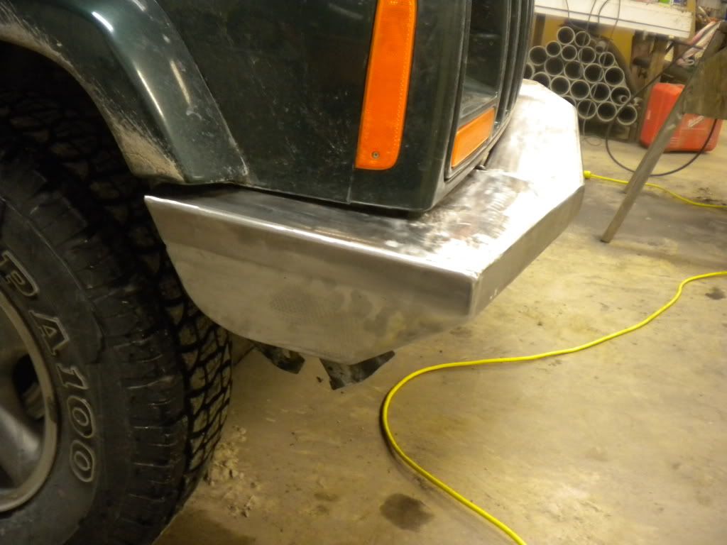

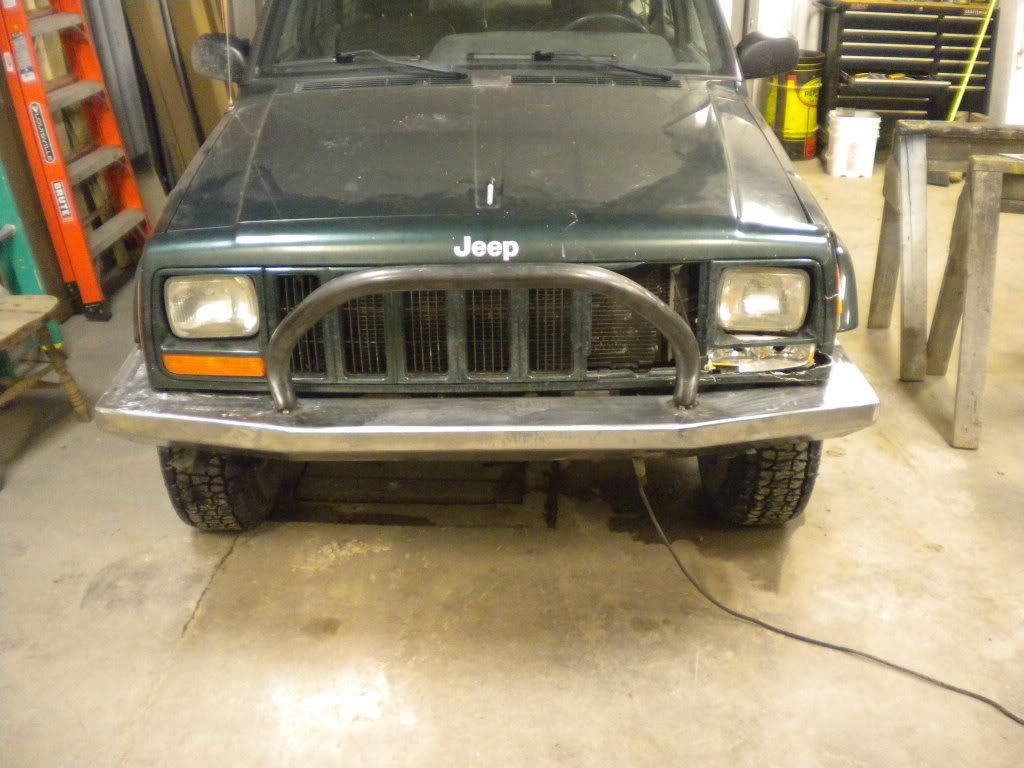

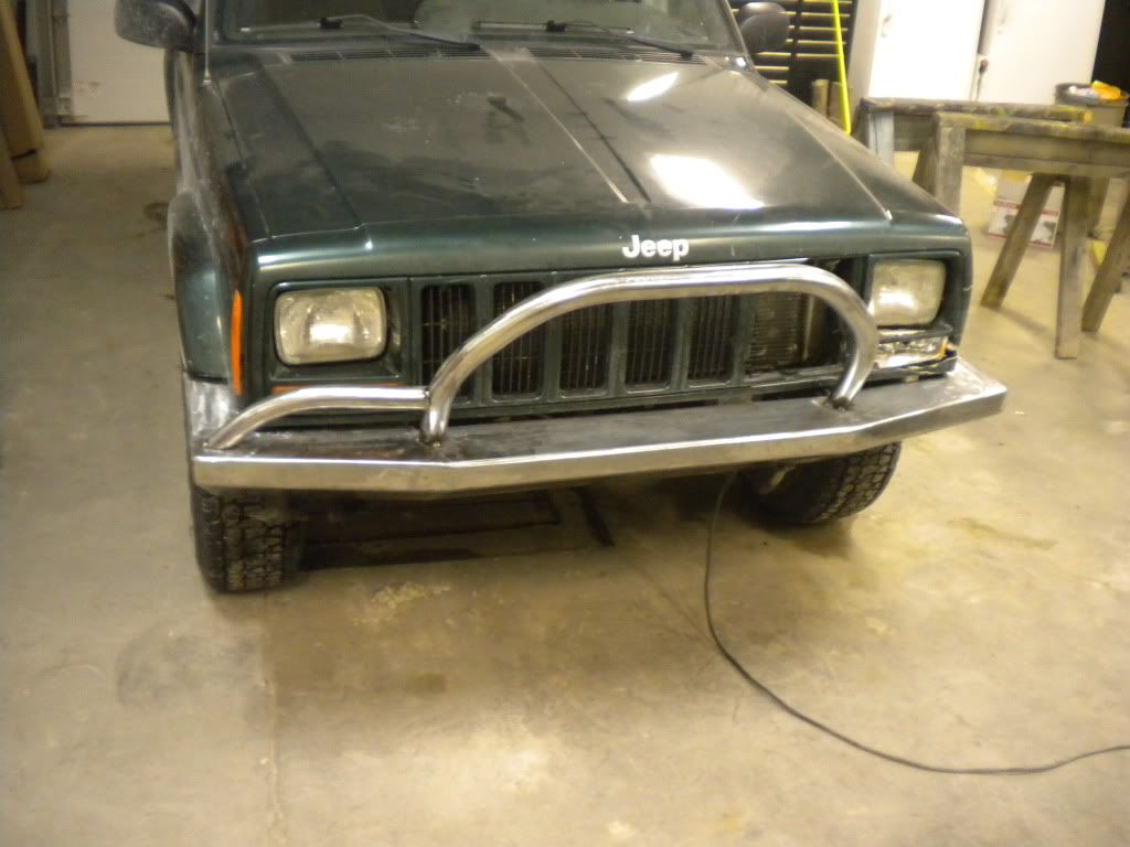

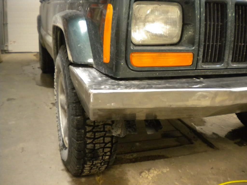

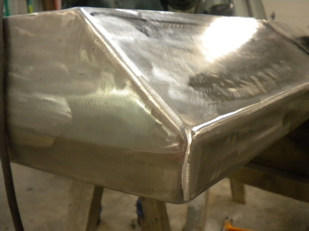

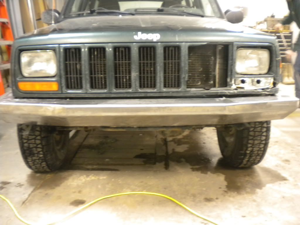

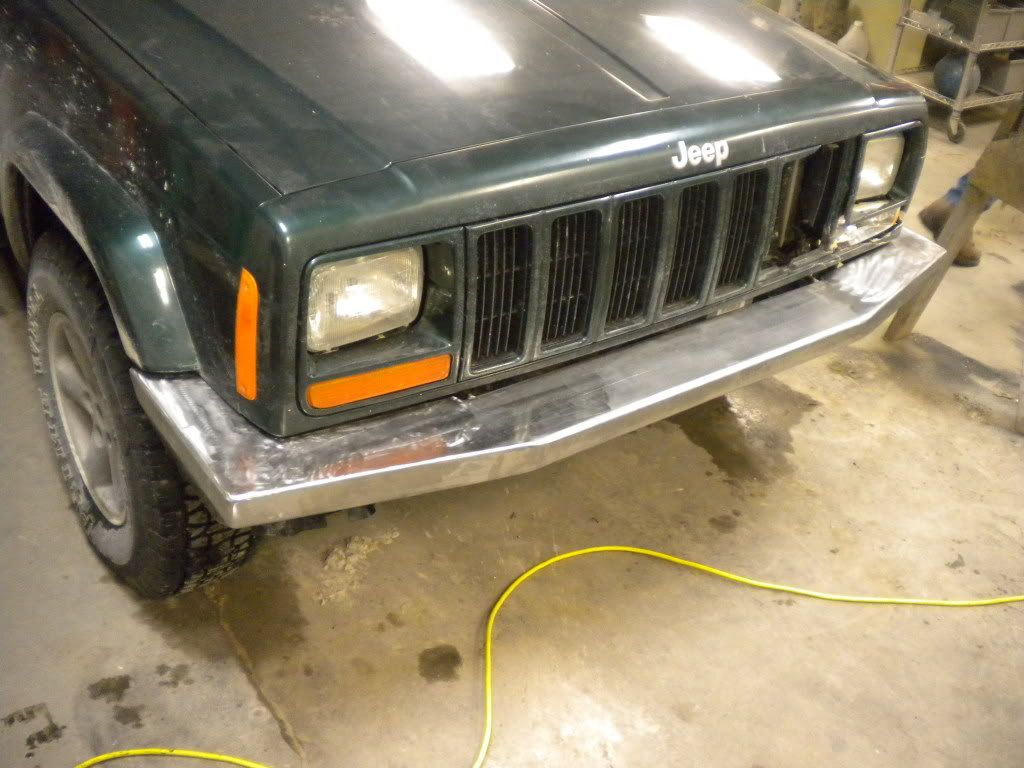

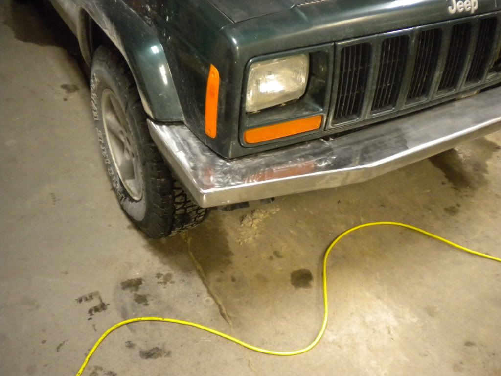

If that was your goal, you failed. The welds make me want to vomit, 1/4" is way too thick, the tie ins make me scared for the lives of all those around you and it kills your approach angle like Ted Bundy killed young women. But hey, you tried right?

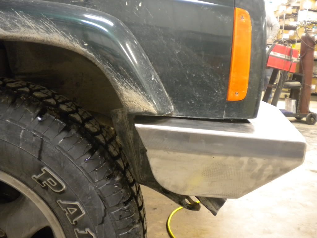

I must say 1/4" IS indeed overkill. 3/16 would have been plenty adequate, especially for the overall girth of the thing. Not to mention almost every single aftermarket bumper manufacturer uses 3/16 for the entire bumper and only 1/4" for the winch plate. You could've saved alot of money going with a thinner metal, and not sacrificed rigidity. The welds look great, the overall fabrication of it seems pretty good. But i agree on the tie in brackets, you should have extended those things in further. Also, why did you guys decide to have the corners, and the sides stick so far out? Now you've got these HUGE gaps between the corner of the body, and the bumper. I would have brought the "sides" in to be flush with the side of the body. JCR did a good job if this in their design of their front bumpers. Take a look at these: http://www.jcroffroad.com/Merchant2/...ntNewPics2.jpg
http://www.jcroffroad.com/Merchant2/...ontNewPics.jpg
I'd cut those "canards" you have going there right off and bring 'em in if I were you. Everything else looks great. I love the edges, and angles. Not bad tho for a first attempt.

I made bumper tie in brackets today that bring the total bolt count up to six. here is the new pictures....
Oops
Thanks everyone for you helpful input
