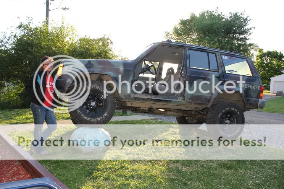

This may be counter intuitive but here is my .02 :
I have a 88 XJ Laredo. I have a 4.5 Rough Country lift, run 31in tires, have the 37 spline axle, and no SYE kit. Since I don't have a SYE kit I did the transfer case drop on it but instead of using a kit I made my own out of steel and grade 8 bolts; it is rock solid. It has been like this for awhile and I have had zero issues out of this setup, but the way in which I use it doesn't lend itself to be prone to breaking. A big factor you need to take into account is how your going to use it. If you plan on running it hard and pushing itself to the limits, your going to wanna build it one way, but if you just wanna crawl around trails and have some fun IMHO tires are the number 1 priority. Here is a picture of how she sits, Hope this helps.
