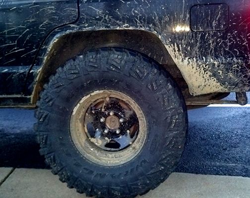

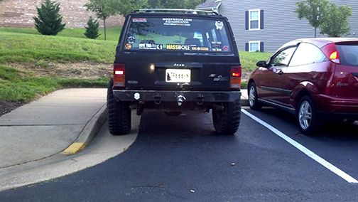

33x12.5s on 15x8s with 3.75 bs and 2" lift (more like 1.5") Rear leafs are original and sagging and need to be replaced though. I had about twice the rear clearance as you can see in these pics when I first installed it. 2" shackles on original leafs hasn't helped keeping them from sagging.
If I was throwing a lift and tires on to go to Rausch Creek in a couple weeks I'd go ahead with the 4.5" if you're planning on running it later anyway. Otherwise personally I wouldn't run any higher than 3" on 33s.
edit: gimme a min and I'll get a better side pic, I have a bit more room in the rear than it looks like.
And you can see what I meant about needing to open the rear up.
I'm getting ready to cut out everything in red. Only problem is I need to weld in new sheet metal since it removes the pinch welds that hold the quarter panel and wheel well together. That's what I meant with it taking more work than bolting things on. If you can't weld and do sheet metal work building a LCOG rig is a lot more expensive. Need to cut out parts of the front wheel wells in and weld in flat sheet for uptravel clearance and need to weld in 2x6x.25 tube after cutting the rockers out too since they get hit so much.
