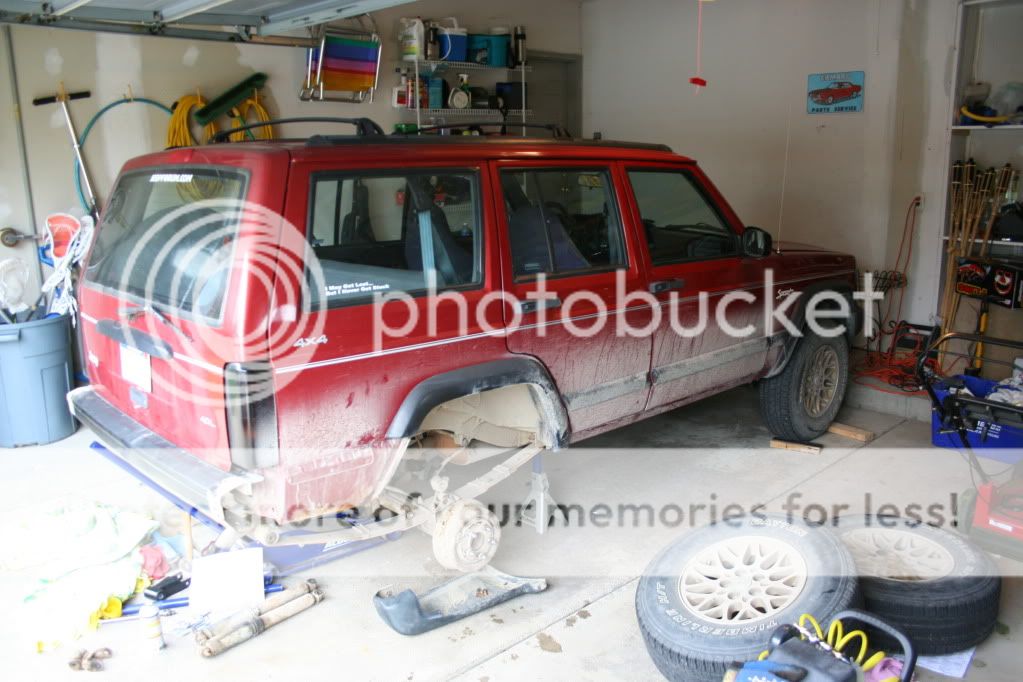

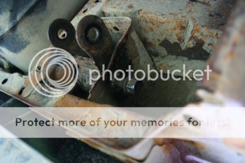

started my lift saturday........... lots of problems. right off the bat, stripped a lug nut, tried cutting it out, didn't work, had to take it to belle tire. drivers side upper shock bolts, both broke off. drivers side shackle bolt, stuck in the bushing. plans are to drill out shock bolts with easy out, and cut out shackle bolt with a sawzall, here are some pics.
31" baja claws ready to go on

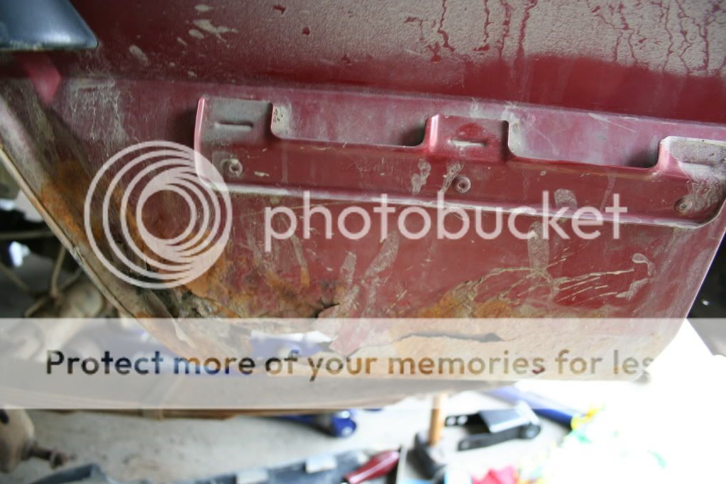

surprise under driver rear end cap
stuck shackle bolt
-Jacob-

i hate michigan rust

that shackle bolt will come out no problem, just torch it for 5-6 minutes and then pb blast, hit with a hammer, then torch for 2 minutes again. then it'll come out

Yeah Michigan weather is not nice to jeeps, my ex bought a 2000 XJ classic that came from michigan, it has more rust than my 90 xj, and was missing the enrite pass floor pan.

dont have a torch, we just rented a sawzall from home depot for 20 bucks, came right out. wore out 2 blades though

im a little bit nervous about my floor plan, it has had a quarter inch of water a couple of times after a hard rain. i'll probably bedline it and leave it that way, everything just costs too much

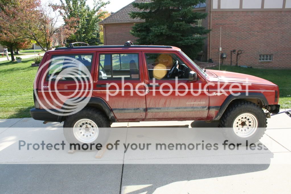

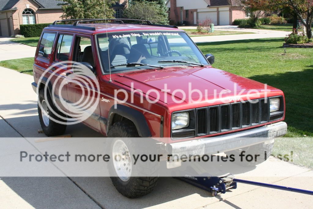

put on my 31s today, rubbed like crazy. im putting them up for a sale or a really good trade for 30s on craigslist. im not gonna lose money on these. worst comes to worst i'll keep them and just lift more later.
