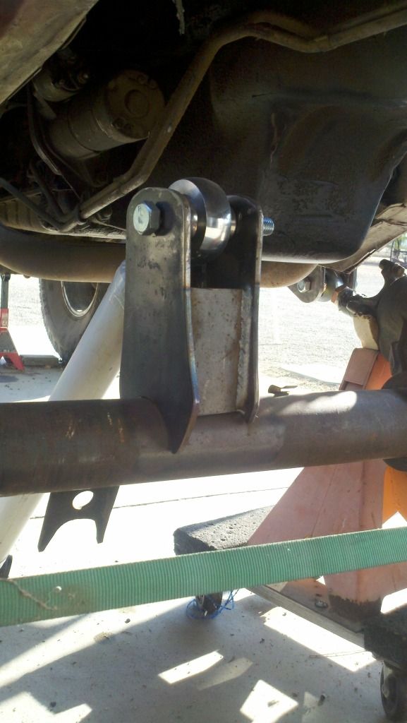

i got the danna 44 set up under the jeep
i ended up having to build my own upper link bracket

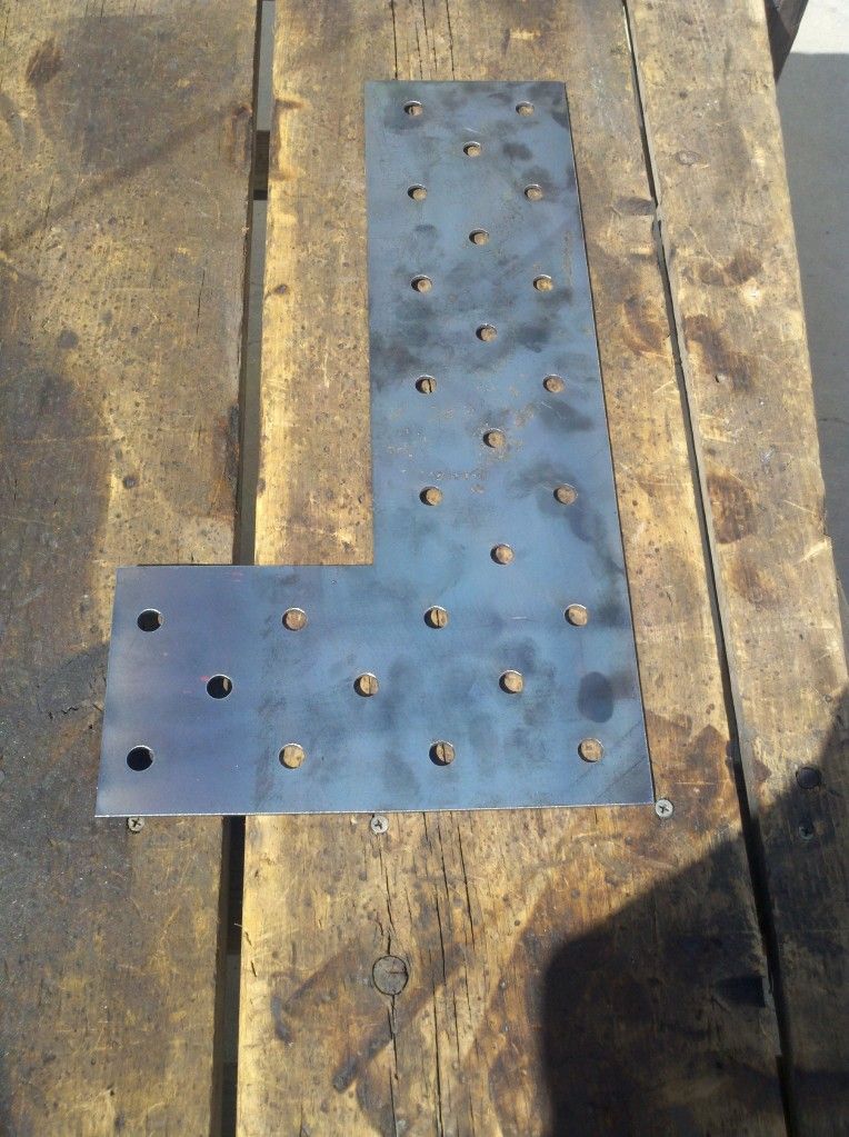

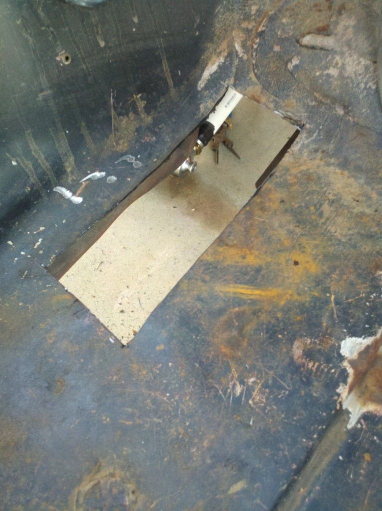

my upper link mount is gonna end up going through the floor so i cut a hole
im gonna plate around the hole so i had a plate cnc plasma cut out of 12 gauge

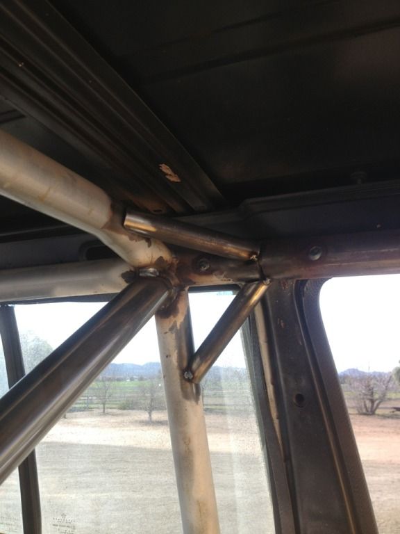

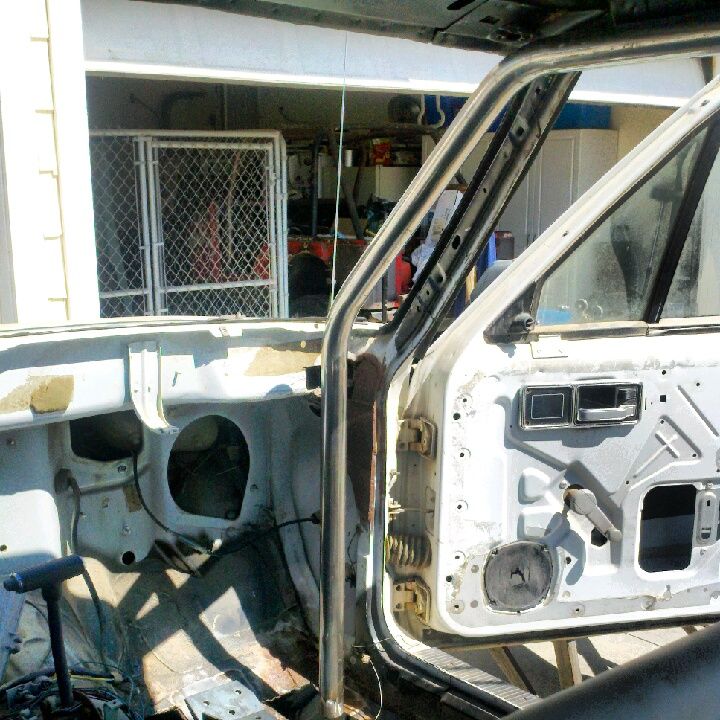

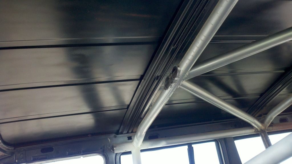

while i was waiting for some parts i decided i would start finishing up the cage work. i ended up having to cut out more of my cage than originally planned
i got my A pillars tacked in place
and just a picture of me welding some link brackets

Looking good man, I like that axles side upper link bracket. What's it made from, 1/4"? Any reason you didn't build in some adjustability? What frame side bracket are you running? I setting my 3link up now on my ZJ and hoping I can get by without chopping up the floor.

ya its built out of 1/4". the reason its not adjustable is clearance, i couldnt get the uptravel numbers i wanted with an adjustable bracket. im using ruffstuffs frame mount link bracket, im sure you can get away without cutting the floor.
heres the bracket im using

im sure you can make it fit, the reason my bracket is going through the floor is to get the vertical seperation i want.

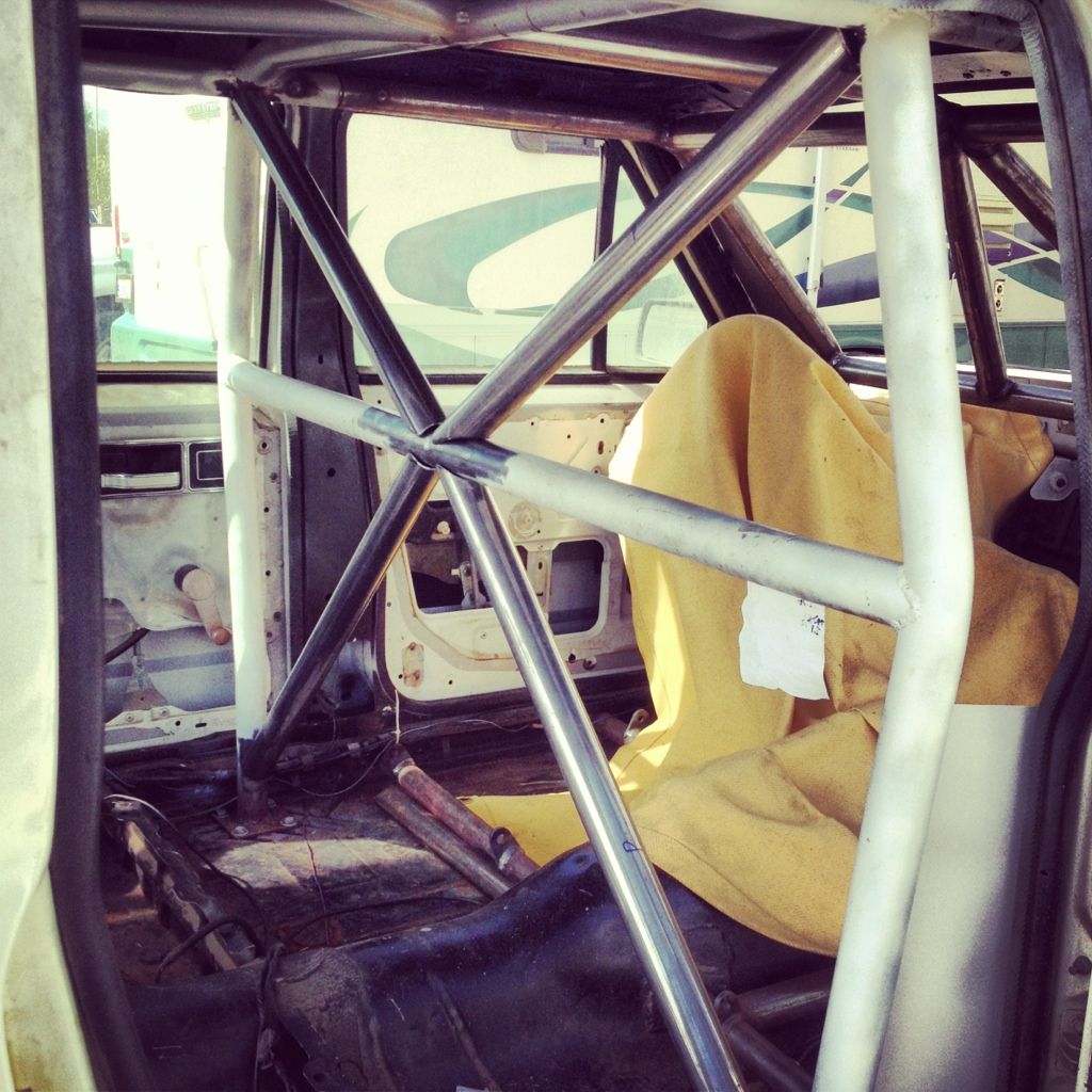

i made a little progress on the cage today

your gonna re triangulate the front over head right?

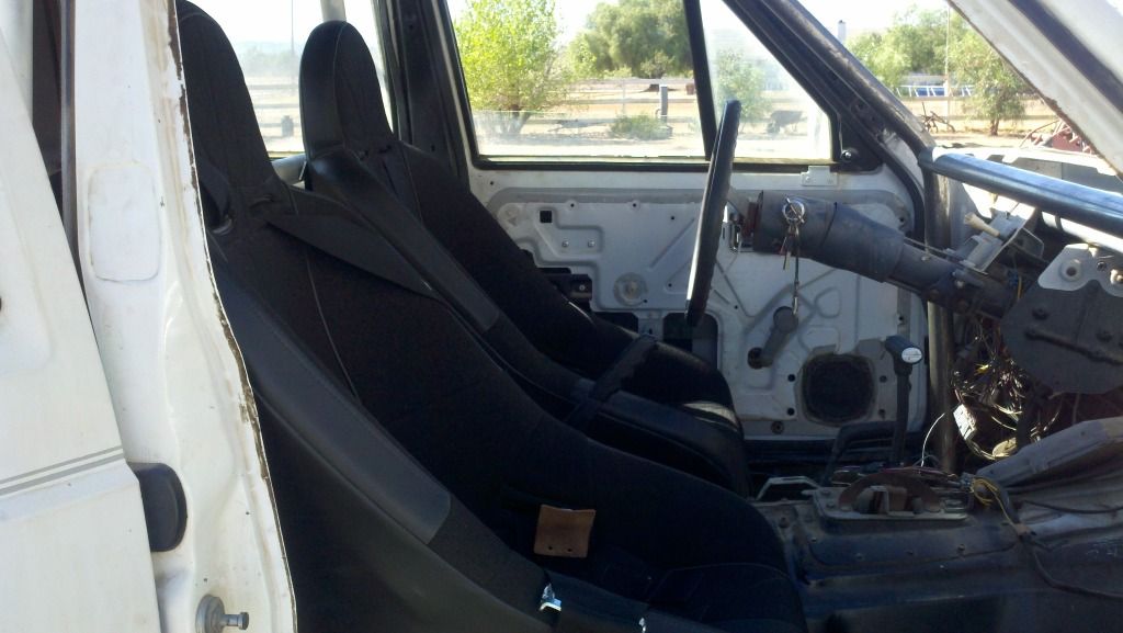

i honestly dont know yet, its gonna come own to headroom. with the old cage work i only had about 4 or 5 inches of headroom without a helmet on and im only 5' 7". i couldnt let anyone taller than me ride in the jeep because there head was just to close to the cage for me to feel safe if we rolled. if i do just run the single tube theres gonna be gussets on every joint and possibly a double A pillar. hell most class one cars run a single tube and i wont see speeds aywhere close to the speeds of a class one car.
you can see this one car just has the single tube at about 2:10

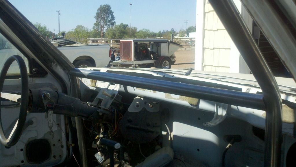

Mounted my seats today so i can check for head clearance with the new cage work

yea but keep in mind its a full tube chassis, with a multi A pillar. id triangulate as much as possible.door bars and all...

slowly making more progress on this thing

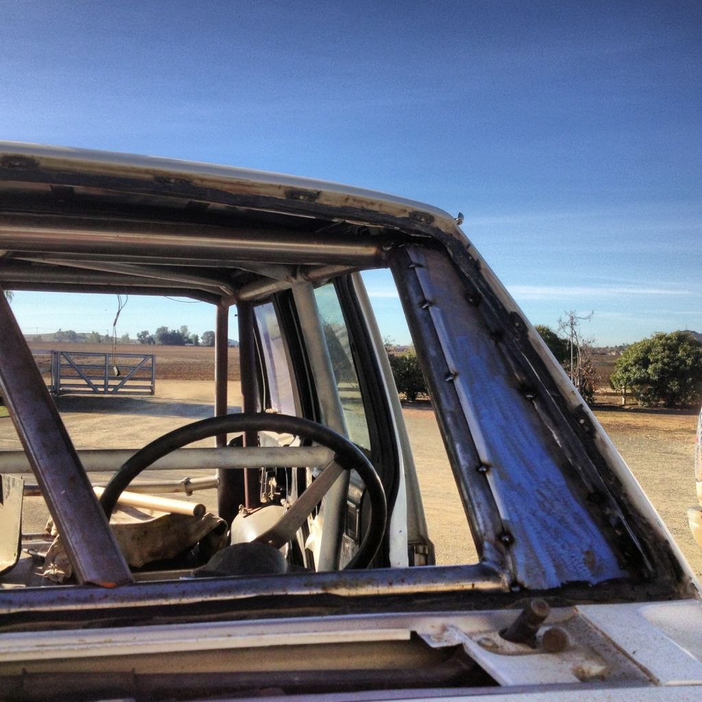

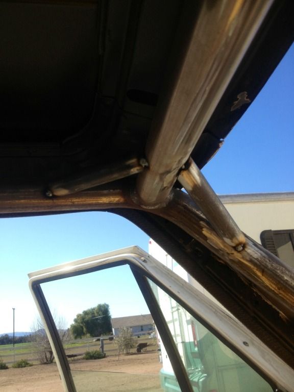

cage to cab plating

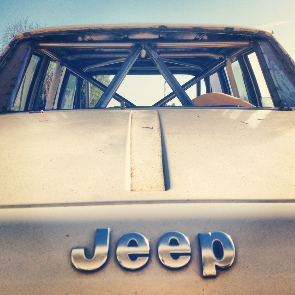

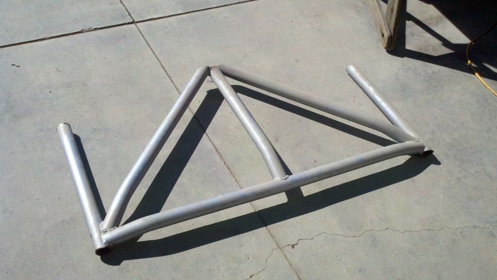

new cage work
1" tube gussets
started adding tubes for the dash
If you're in control you're not going fast enough - parnelli jones
