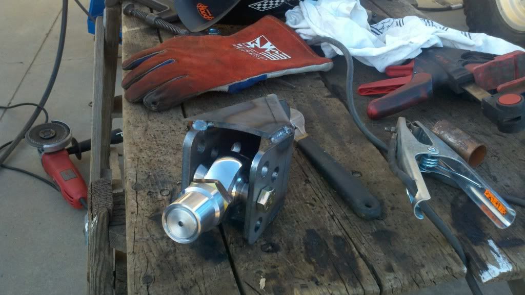

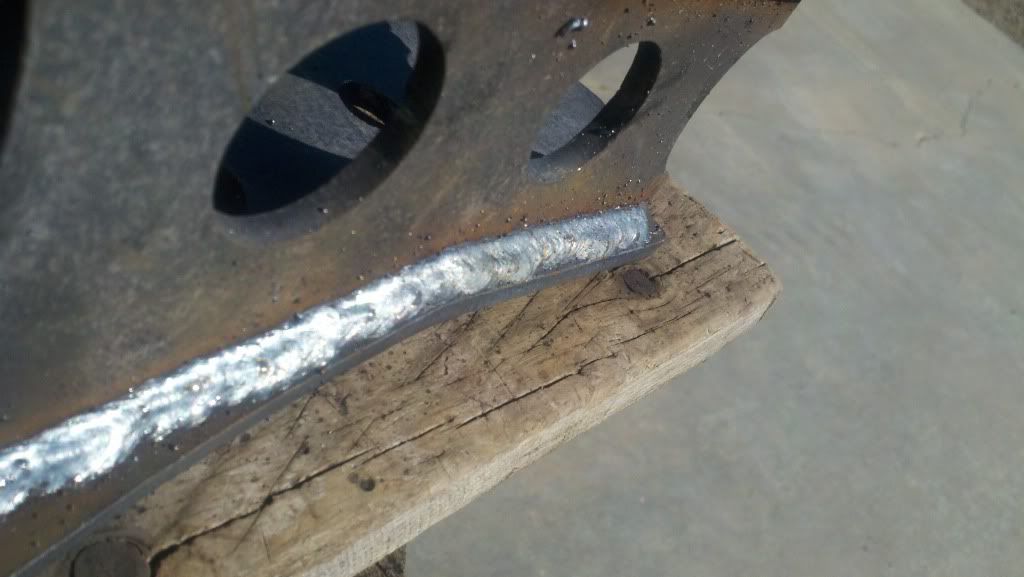

finally an update
first i grabbed a piece of scrap 1.5" tube and cut it to 2 5/8" to help keep my brackets from warping.
the artec bracket all welded up.
ruffstuff's link bracket for the frame end.

post #101 of 197 Old 03-10-2012, 09:24 AM
VegasGT
1988 MJ Comanche
Location: Leitchfield, KY
Posts: 5,395
Haha considering your build I should have thought ahead on that statement. Looking good man!

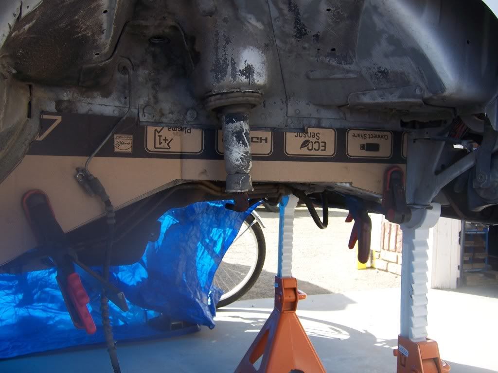

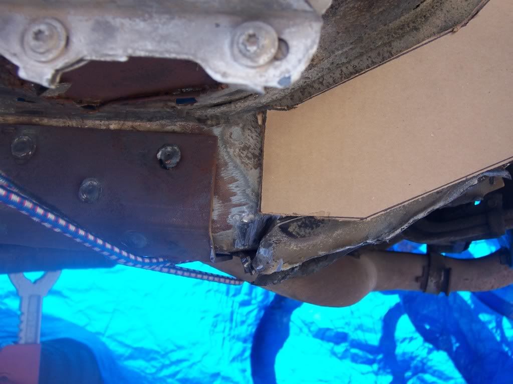

i cut the template out for my front frame stiffners today. I still have to do a little trimming, let me know what you guys think.
should i tie them into my other frame stiffners? i would just have to extend the end about an inch

post #103 of 197 Old 03-11-2012, 06:42 PM
Brookhart63
Location: in a Cornfield
Posts: 1,395
That ruffstuff mount is beefy. Why not tie into the unirails?

post #104 of 197 Old 03-11-2012, 06:47 PM
CTeunuch
Location: Sudbury, MA
Posts: 1,314
Butt them together, then fishplate it, otherwise you create a weak spot that will be prone to cracking. And go buy those Bronco arms, a TTB rig can be badass if built right.
thats what i love about ruffstuff. honestly i have no reason not to time them together but was just curious what everyone else thought.
will do thanks. haha dont tempt me, at this point i just want to get this thing back on 4 wheels so i can take this thing in the dirt. TTB's may still be in my not so soon future when i possibly link it
