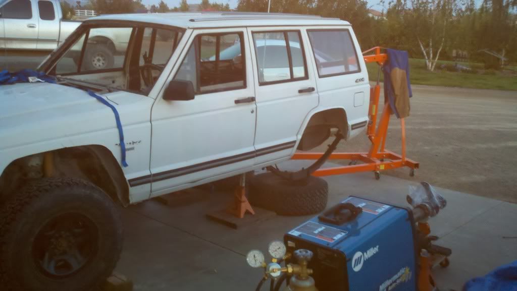

I decided to put the frame stiffners on today since I had it off jackstands.
I used torch and putty knife to scrape off most of the under coating and then used a 24 grit sand paper flap wheel
Then tacked the stiffners on
I got most of the welding done but had to stop early because the wind was blowing the sheilding gas away
