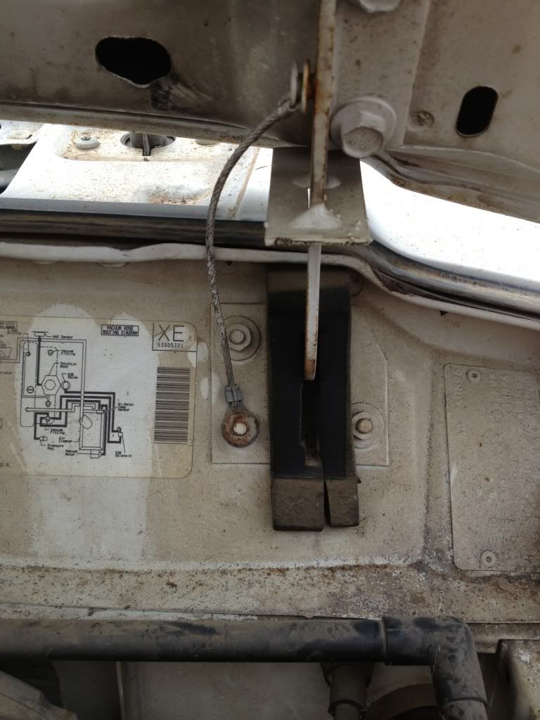

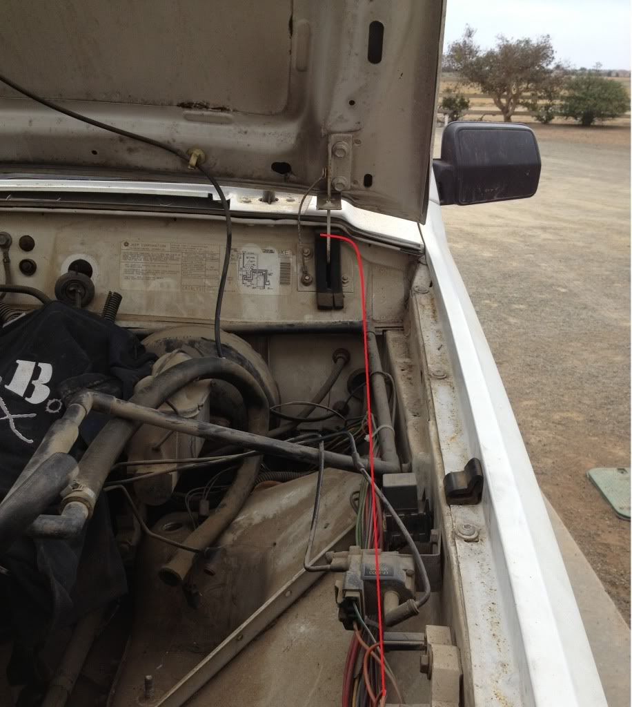

i need some opinions about how to start my engine cage my A pillar lands right about where these 2 vertical bolts are for the hood bracket so i have 3 options
heres the bracket im talking about
option 1: remove the hood brackets and run a straight tube to the A pillar inside and just use hood pins to mount the hood. the only problem i have with that is having to completely remove the hood every time i need to get to the engine bay (if i do this i will probably get a fiberglass hood)
option 2: bend the tube around the bracket on the inside. my problem with this is it would put my engine cage tube farther inside than i wanted it
option 3: bend the tube on the outside of the bracket but that would be a pretty big bend which i am trying to avoid. it would probably have to be almost a 90 degree bend
i'm leaning towards option 1 but let me know what you guys think

COuld you make an option 4- run the tube in location where the two vertical bolts are and relocate the hood hinge? I know stock hood hinges for a 1991 body style Ford f250 mounts to the side of the inner fender. That hinge is plenty strong for an XJ hood and has a spring built into it to hold the hood up geting rid of the hood prop.
that could possibly work, do you know where i could find some pics to see about where they go on the inner fender?

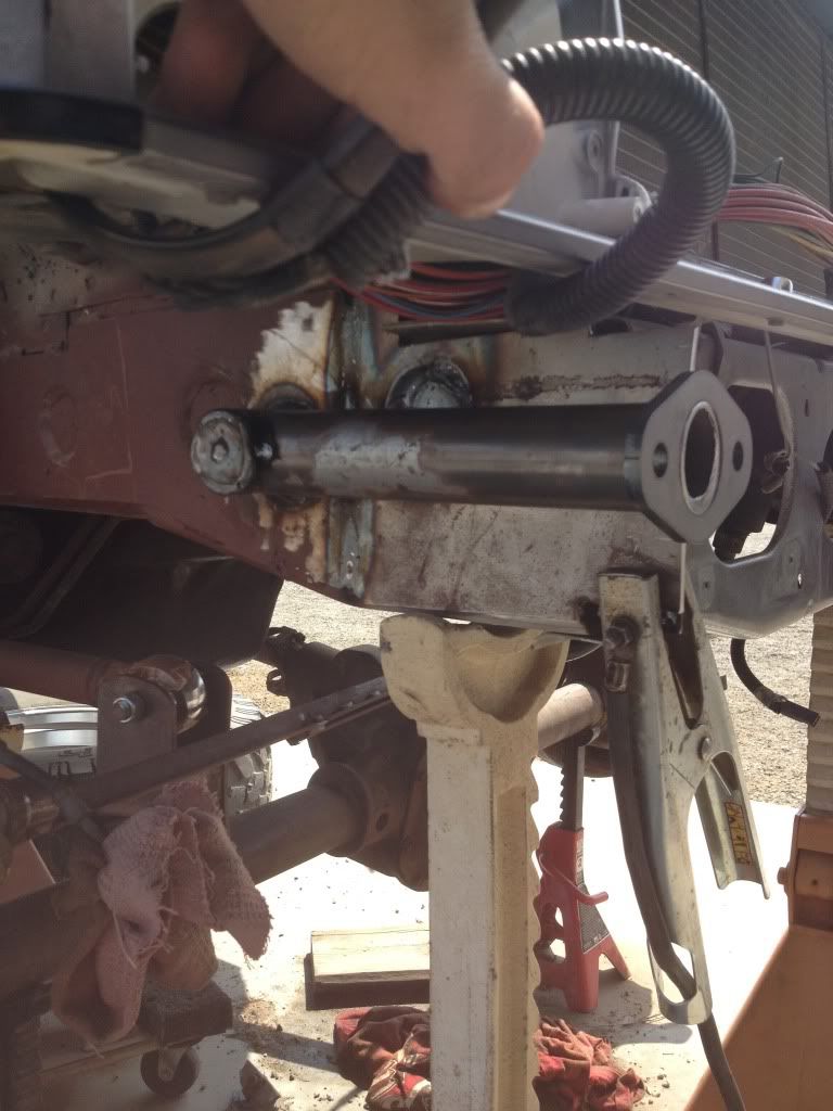

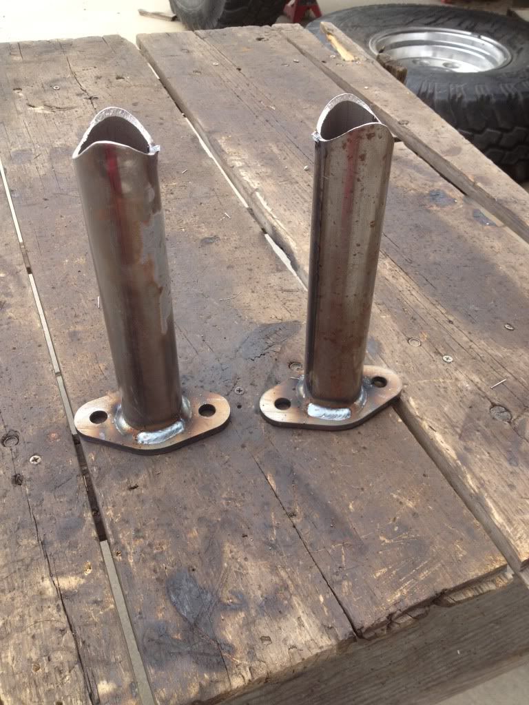

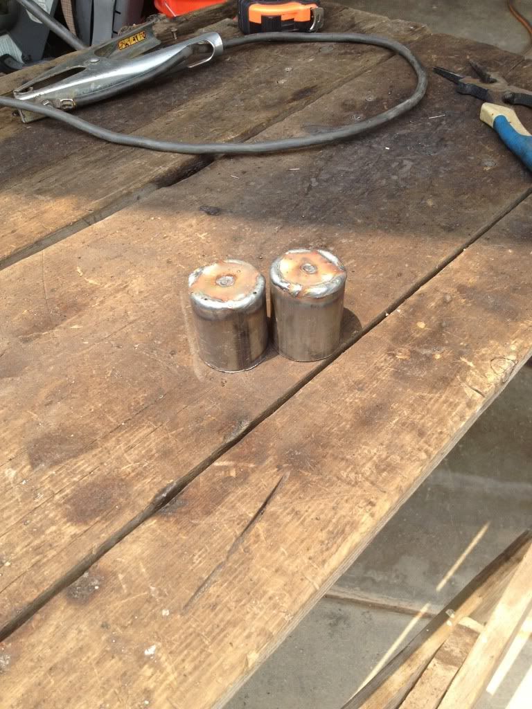

while im waiting to decide on what to do about the engine cage i decided to start on the front bumper, i started by cutting two 2" pieces of 1.75" tube and then cut out a couple of pieces of 1/8" plate with a hole saw to cap the tube
then i welded those on the frame and then cut and notched a couple of 9" tubes of 1.75" tubing and welded some tube flanges on them then tacked the tubes in place

You can see in this pic the bottom hindge arm is bolted to the fender and has the coil hinge at the top of the photo. The second link is a pic of the whole assembley and the end with the two bolt holes goes to the hood. It may take some time figuring where to bolt it for proper opening but I have these in my F250 and they're super strong and easy to work around http://thumbs4.ebaystatic.com/d/l225...NtiX0b1OdA.jpg http://www.ford-trucks.com/forums/at...1&d=1327544028
thanks for the info, i'll look into this

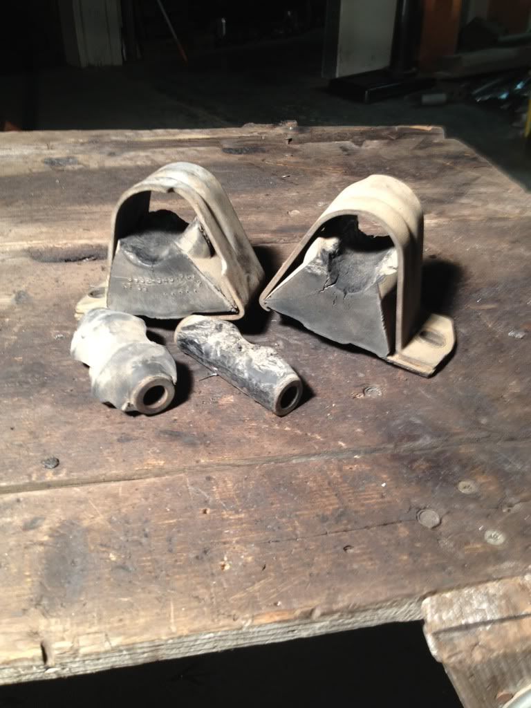

it was definitely time for some new motor mounts, both sleeves slid right out when i unbolted them

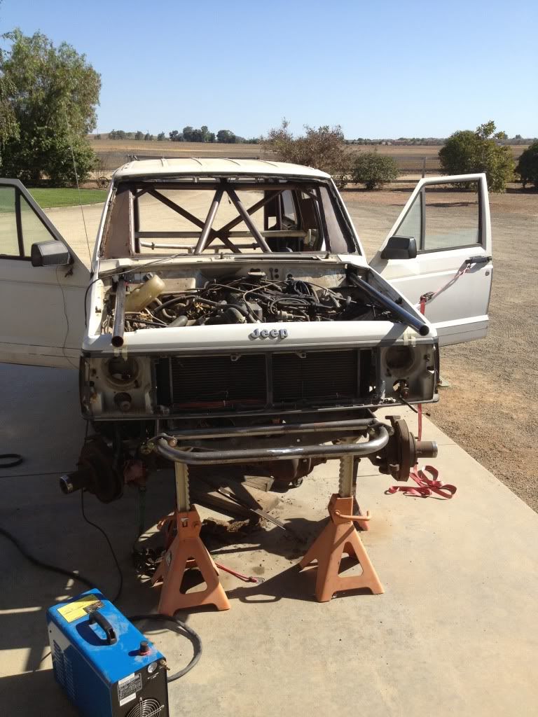

here's what i've come up with so far for my front bumper, i'm trying to do something a little different than the traditional tube bumper

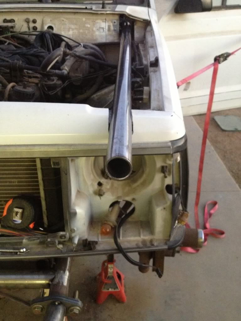

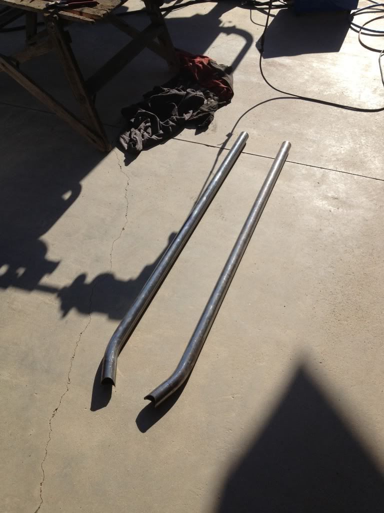

i bent up the 2 main tubes for the engine cage
mocked up

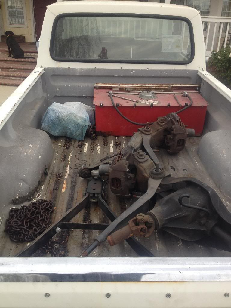

i picked up a 85 single cab long bed ranger the other day, it needs some TLC but the price was right. it came with a fuel cell and some dana 35 TTB's and a bw1354 manual t-case i can throw on there. should be a fun little project.
