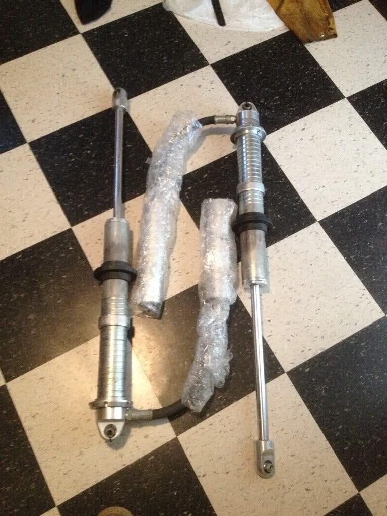

well you guys talked me into it
2.5 14" coilovers
i was talking to my brother about coilovers solving some of my packaging problems up front and mentioned he had a pair of 14" coilovers in his room but wanted 16's to put up front on his yj, so i took the 14's off his hands and i am going to help pick up the tab when he orders the 16's when he collects all the parts for his front 3 link

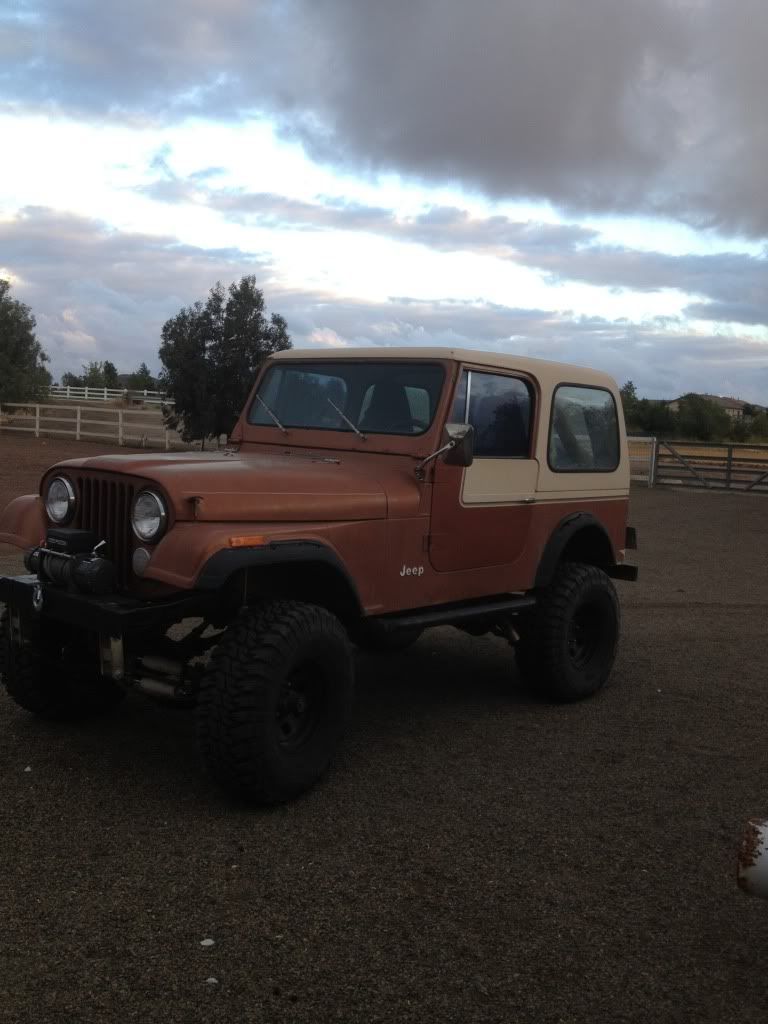

Well the jeeps gonna be on the back burner for now my brother and I just picked up a cj-7 from a guy that wants us to build him a simple cage, a roof rack, a rear bumper and rock sliders I'll try to work on the cherokee in between this new project

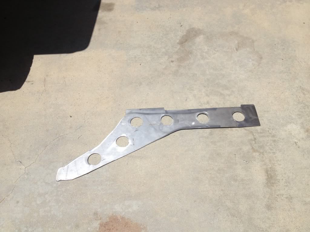

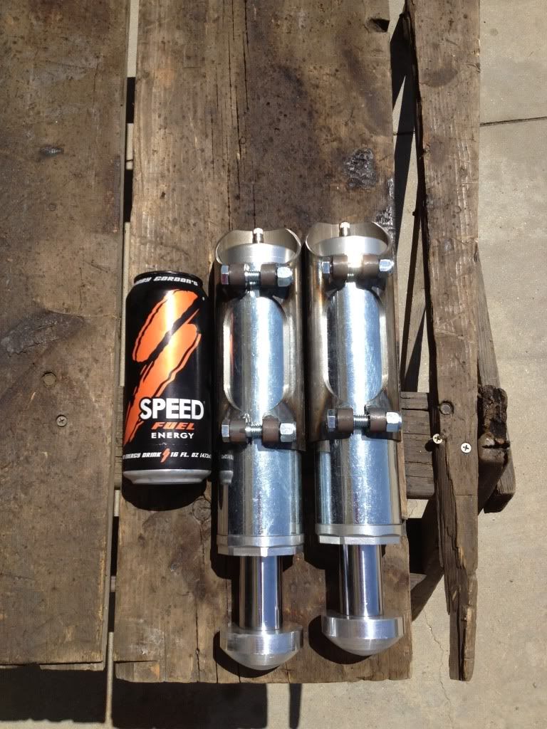

i took advantage of FOA's memorial day sale and ordered the rest of my shocks, i ordered 2.5" 2" stroke air bumps for the front and ordered some 2.5" 16" smooth bodies for the rear
i got the air bumps, the smooth bodies are still being built

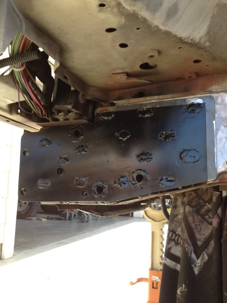

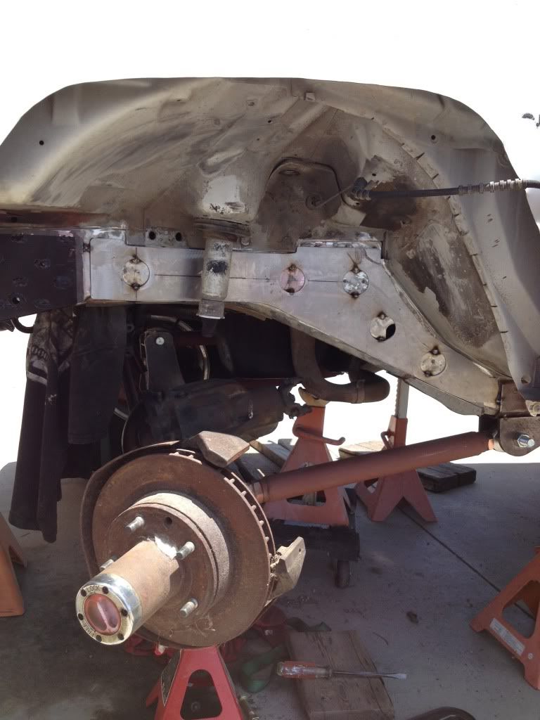

i couldnt start the driver side front frame plates because the jackstand was in the way so i finally got around to moving the jackstand and finally started plating the driver side
JKS SBS finally installed, the rest of the front frame plates should be built soon
once i'm done with the front frame plates im gonna get started on the engine cage

Wait those are bump stops?
ya, there hyrdaulic bumpstops. i wanted something with a definite stop in the front so my track bar wont go into the oil pan so i decided on these instead of polyurethane bumps. eventually the rear will have them too

i got the driver side frame plate built, now i'm gonna get started on building my trackbar mounts so i can get that out of the way then get started on the engine cage

How exactly do rear air bumps work? Haven't been able to find anything on them.
