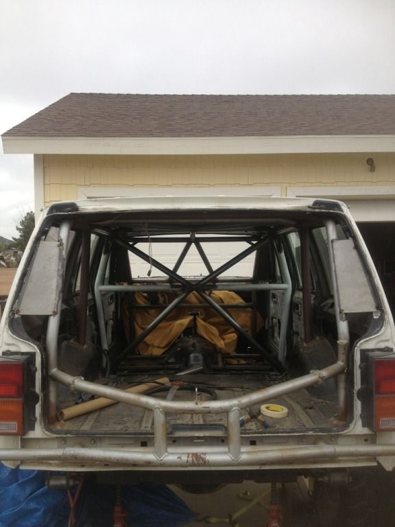

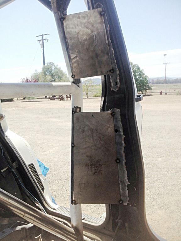

i got most of the cage to cab plating done, i used 16 gauge plate
B pillar
D pillar
then i started tying my seat mounts into my cage, im probably gonna run a tube across the bottom of the B pillar to have more tie ins for the seat mounts

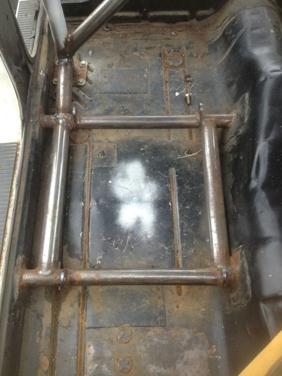

I got the seat mounts tied into the cage today
Lower B pillar
Passenger side seat mounts
Driver side

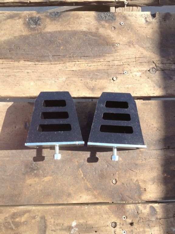

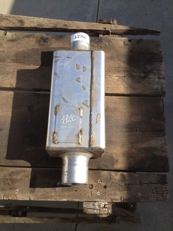

i picked up some parts today
i got some 4.5" polyurethane bumps for the rear
a spintech muffler

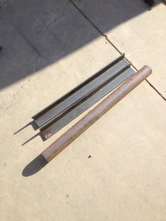

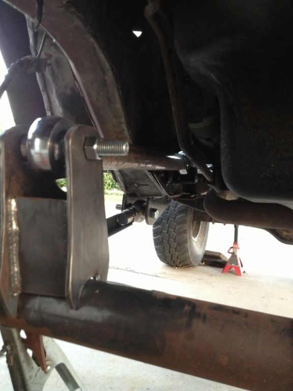

i wanted to make sure i didnt have any clearance issues so i made some mock up links out of some angle iron and used 1 3/4" hrew for the upper
i just need to build a mock up track bar and i can cycle the suspension

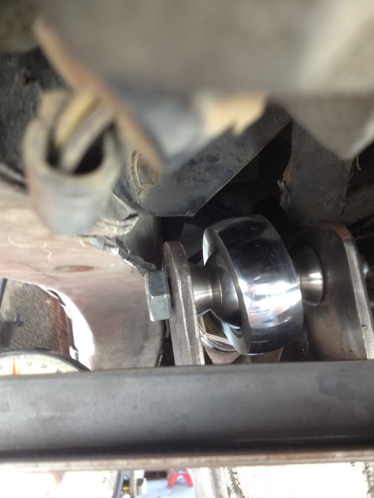

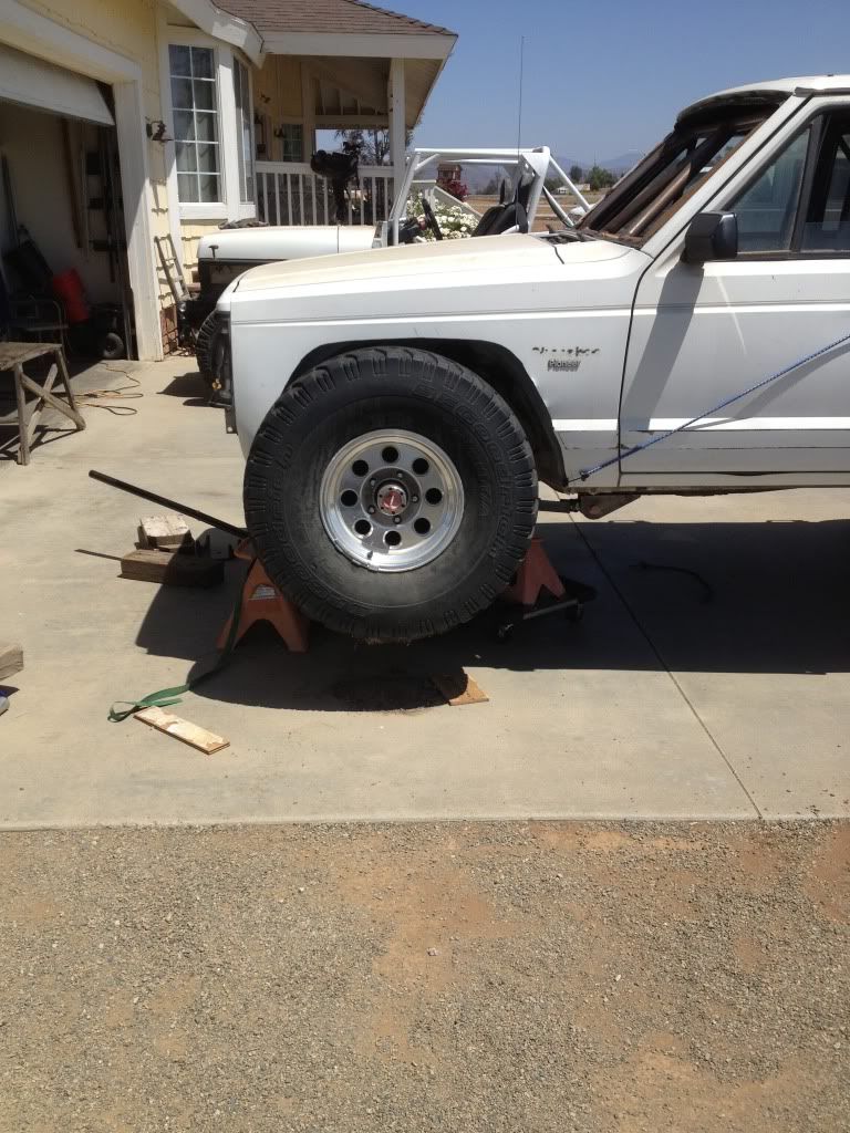

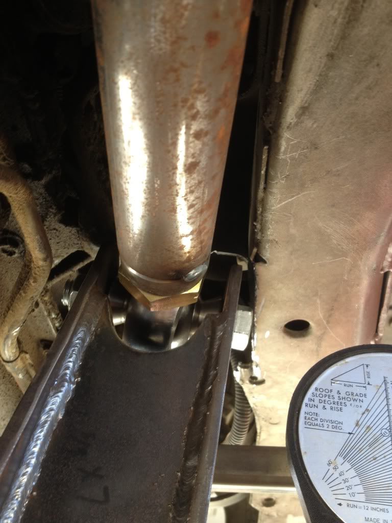

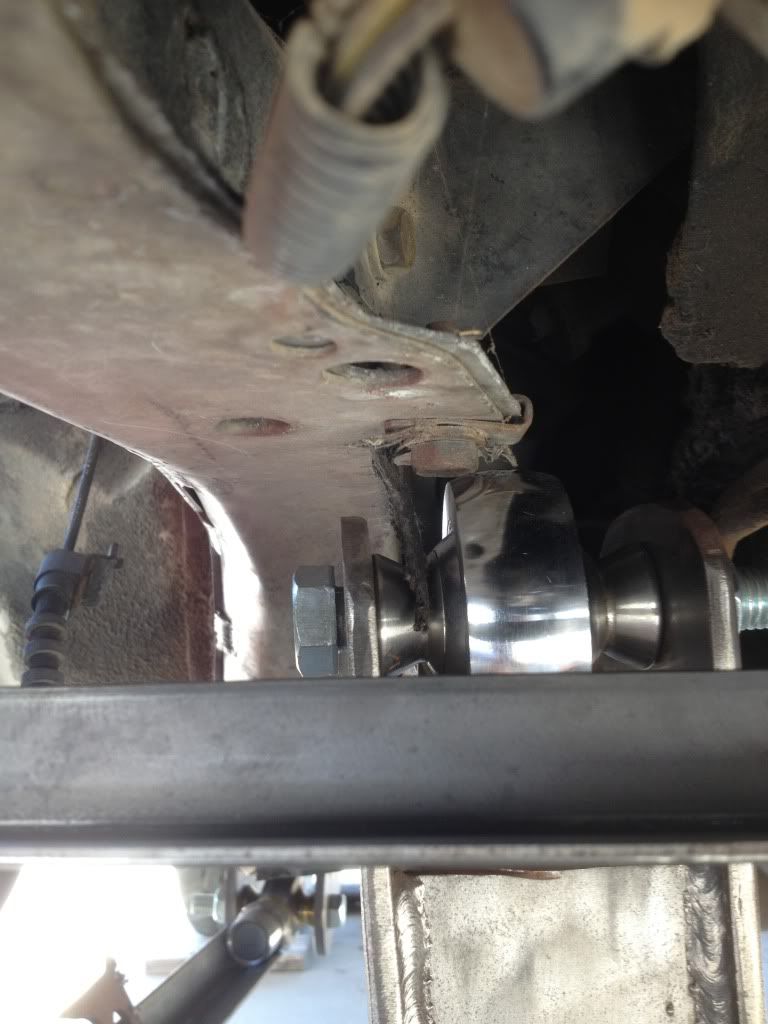

not much of an update but i got the mock up track bar all mounted and cycled the suspension today, everything cleared when i flexed the front suspension but when i tried to cycle the suspension to full bump i ran into some clearance issues with the upper link mount hitting the frame about 1" before full bump.
1" before full bump
heres where the heim makes contact with the frame, im gonna move the bracket over about an inch and cut off the part of the bottom of the frame that sticks out a little

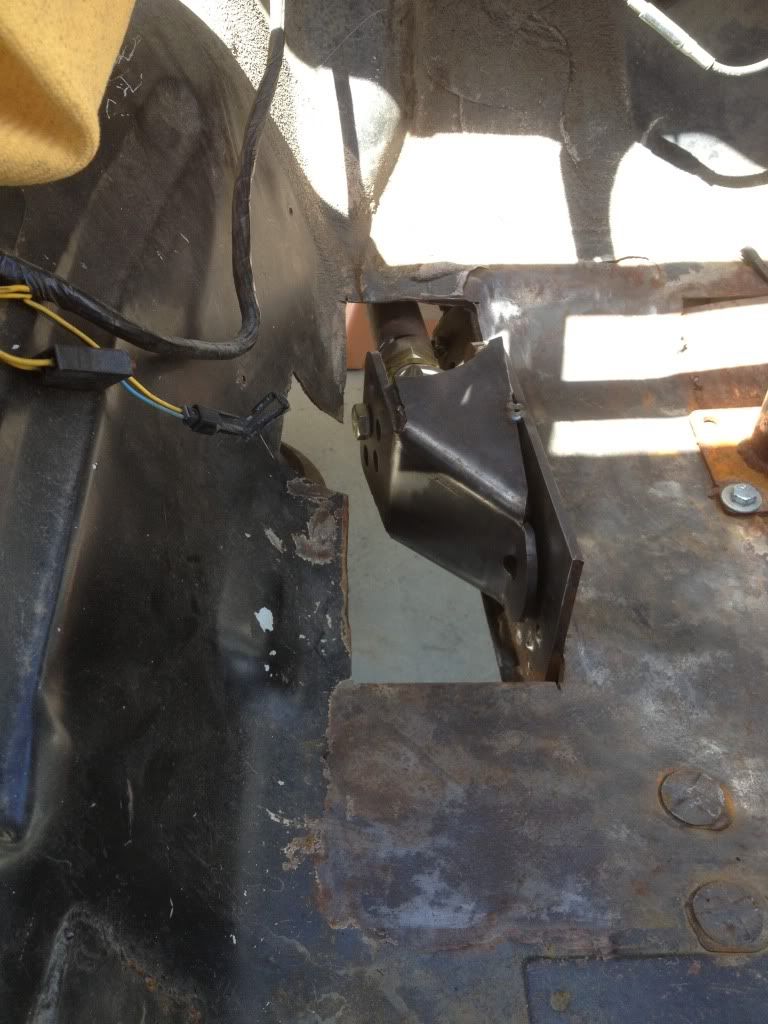

i got the upper link mount to fit today and got the 7" of up travel i was looking for
i should have the links built out of DOM tomorrow
i dont think i showed how i was mounting the upper on the frame end, i cut a hole in the floor and cut out a piece of 1/4" plate and drilled some in it and plug welded it to the frame and welded the outside of the plate to the frame
im gonna plate the floor around the link mount with some 10 guage steel so i had my buddy cut it out on his new cnc machine for a case of beer because i didnt want to drill all those holes ha

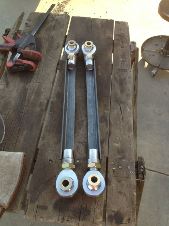

i got the links built today i used 2" .250 wall DOM for the lowers and 1 3/4" .120 wall DOM for the upper. the lowers are 24" eye to eye and the upper is 27"
primered, i should be able to paint them tomorrow
