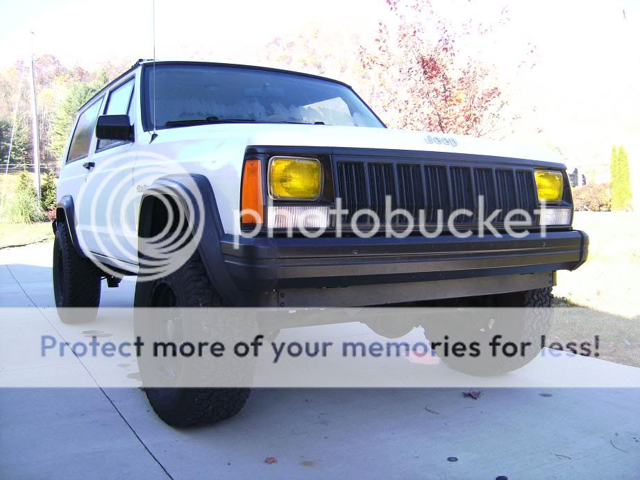

While I'm waiting actual parts to arrive I though I'd wash and wax her this weekend. Also tossed on some yellow headlight film I had laying around. Not sure if I like it, we'll see how well it wears on me. Looks like its possessed or something

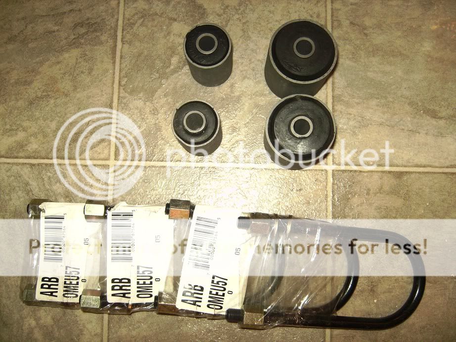

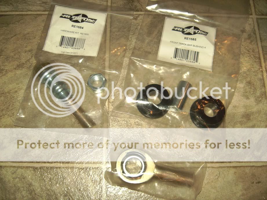

Ok so on to parts. I've been gone all week when I got home I did get the joy of going through the boxes:
Old Man Emu u-bolts and bushings. Bad news is there is some sort of nationwide back order and 3.5" OME springs won't be here from Austrailia until like the 10th of December.
SYE is here but in the theme of the week.....drive shaft is delayed. I have a hilarious message from Rubicon Express telling me and I quote "you have a freakishly long drive shaft". Apparently most stock shafts are 28"-29", mines 33" so it had to be specially made, hence it's another week away.
And then the parts to rebuild my used RE track bar. We'll see how long it lasts, I'm already thinking I should have gone IRO double shear or comparable.

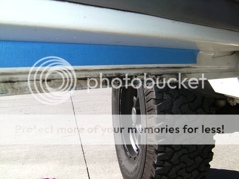

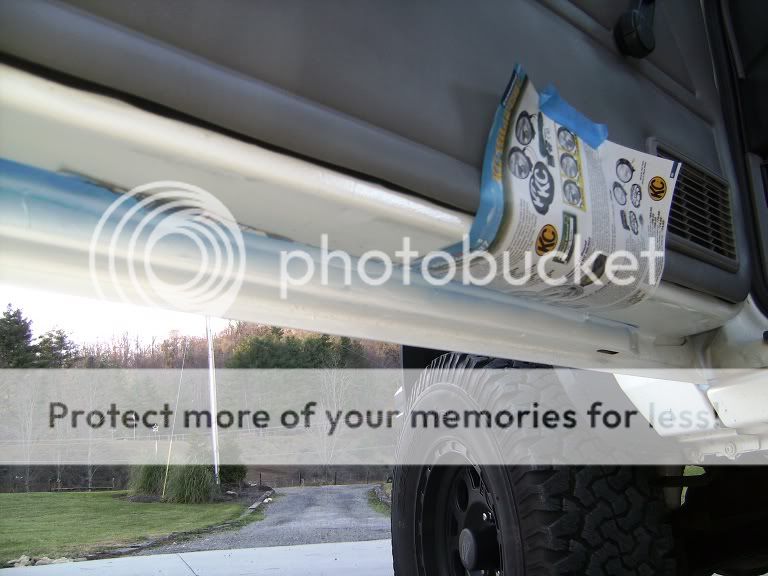

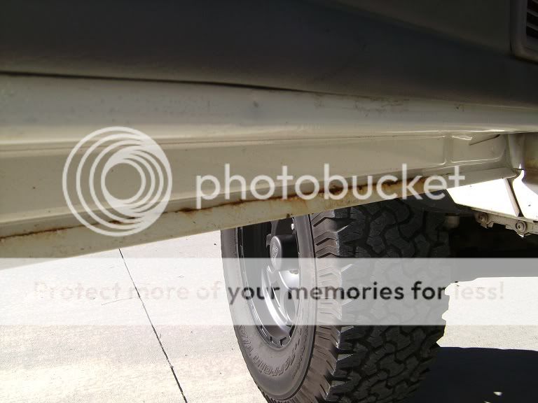

Nothing to exciting, got a little project done today that has been on the to-do-list since I got this thing.
Before:
After a wire wheel and prepped with rust converter/inhibitor:
Painted and sealed with silicone to prevent water from going back in there:
