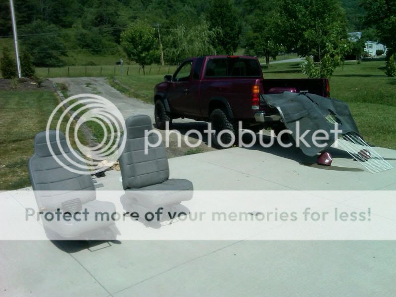

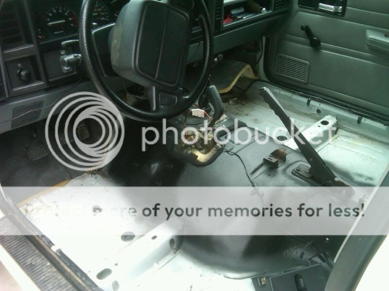

Iím actually a little late getting this thing started. When I got it the gas tank was shot, unknown to me, I thought it was just a bad sending unit issue since itís had a 4.0 dash swapped in for the tach etc and the fuel gauge didnít work. So after a new tank and fuel pump for all the rust it had eaten sheís back to running wonderfully. My mechanic and I assume someone left it sitting for some time un driven without much fuel in the tank. Basically everything had disintegrated around the fuel pump. But now thatís itís back up and running and while Iím saving for the 4.88ís Iíll be tackling some cosmetic stuff. Iíve already blown the interior apart and sealed a few leaks up on the fire wall. Used the new Rustoleum undercoating/sound deadener to spray the floors and put everything back together. But overall itís a very clean XJ.
The interior out and the undercoating/sound deadener going in.
Seats at carpet drying in the sun from the pressure washing/scrubbing I gave them. Smells way better in my Jeep now with everything all back together. Between the leak in the firewall and what I considered to be dog vomit in the floor board (hidden under a husky liner mat) it had a funky smell in the cab. Fresh as a daisy now.

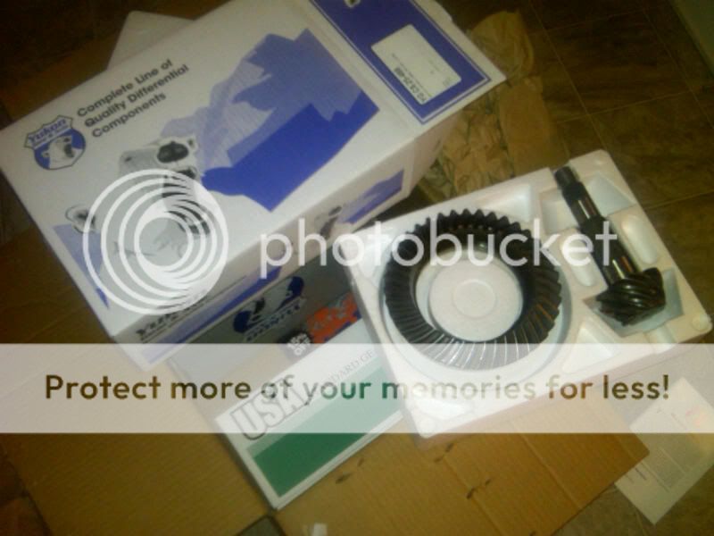

Just a small update, pulled the tirgger on the 4.88's today. That figure the forum surfers like to throw out of $1,000 for a gear install, $500 for parts and $500 for install, needs to be updated for inflation. Ordered all my stuff from Randy's Ring and Pinion:
Order Summary:
YG C8.25-488 $352.67 (Yukon Gear)
ZG D30R-488R $159.78 (USA Gear 4.88 because Yukon supposedly on a nationwide backorder for 3 months)
YK C8.25-B $116.32 1 $116.32 (install kit)
YK D30-F $147.28 1 $147.28 (install kit)
TOTAL: $776.05
And that's minus the carriers since I have 4:10's I was told I didn't need them. My wallet is on fire. My mechanic says it's going to cost roughly $300 per axle to get them installed. Gears will be here Wednesday, goes in shop on Monday for install.

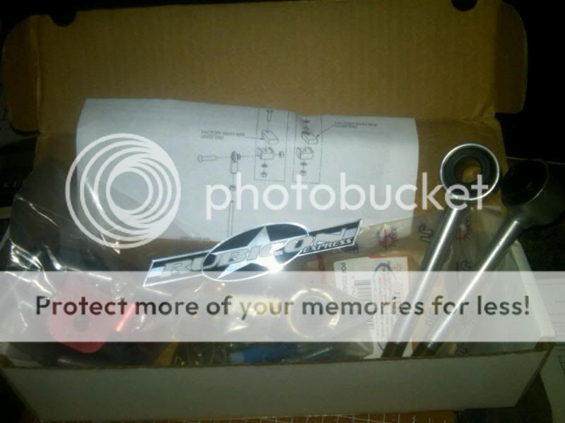

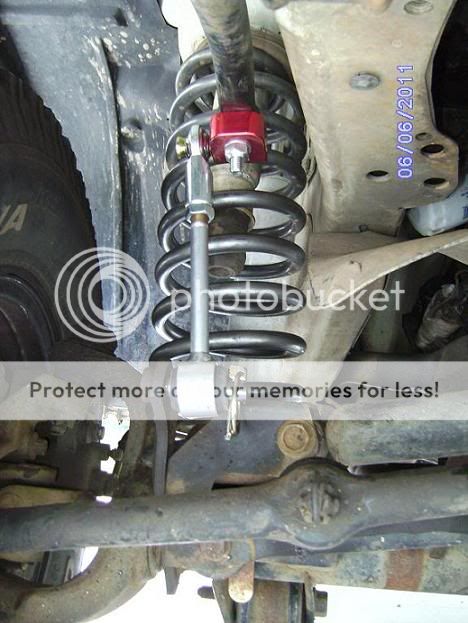

Also got the QD's on yesterday. Which in true Jeep fashion of adding one thing and needing 3 more to make it work right....I need to pick up an adjustable track bar. Since the axle is atleast 2" out of whack to toward the drivers side making the QD's not the easiest to disconnect on the passenger side. I'd have taken a flex shot but no reason to be impressed by an XJ on 31's flexing on a wall in his driveway.

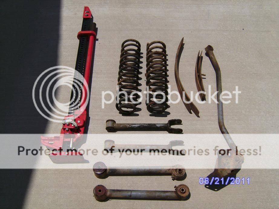

Well if you are like the Mrs' and saw where I said I was done spending money for a little bit you will be like her and point out that I've lied.
Found this on C-list yesterday, Supposed to be an RE 4.5 SF with AAL, yes it needs some, cleaning, painting, greasing. I'd like to use the arms and the track bar, can I do that with only 3.5" of lift currently?

Lift pictured above, bought it, then decided to sell it, then decided to keep it again. So I've started shopping for a sye, going back and forth on hack n tap with rebuilt shaft (iro kit) or a regular sye. I think I might do a regular sye, the tapping makes me nervous and still go with a rebuilt shaft.
