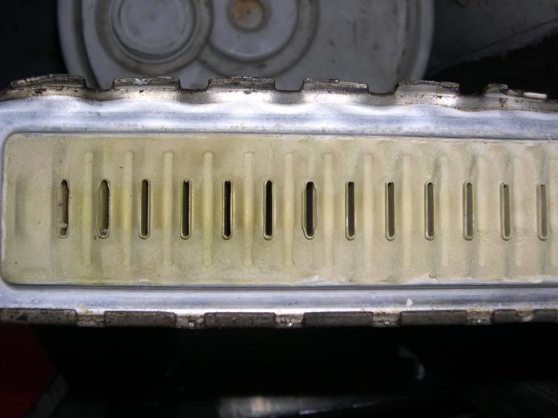

Just a word on these aftermarket "cost conscious" mulitple row radiators....
Here's a pic of a Champion radiator with the tank cut off from one of the Camaro guys. His car cooled fine on the street but overheated when autocrossing. Ruined one engine, Champion replaced the radiator, and it still overheated on the new engine. This was a 700hp-rated radiator on a car making less than 300 RWHP. The tubes measured out at less than 0.030" high, and he estimated that about 50% of them were deformed on the ends. For comparison, a stock GM single row tube is 0.070" and Griffin uses a 0.090" tube. With the junk our Jeep engines produce you can imagine what will happen to a setup like this if you don't go above and beyond what would typically be required for cooling system maintenance. Clog city.
I run a similar Champion on a 500hp SBC with no issue, but this shouldn't be ignored. Although spending big money on a radiator doesn't necessarily guarantee a better product, you can pretty much bet that the lower cost ones will have issues like this. Heat exchange is all about area and typically the low cost manufacturers tout their row count when in fact the way they manufacture them actually results in less area.
Stock GM for comparison.
