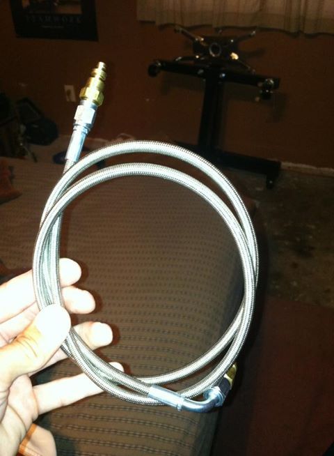

Also, my throw out bearing went out, AGAIN.... I decided that I wouldn't put another one in it considering this has been the 4th one to go out in the last 2 years. I opted to swap to an external slave cylinder since I had most of the parts already. For the plumbing of the 99 slave cylinder to my 92 master cylinder, I didn't want to go back to the nylon hydraulic line because I've had one crack before. I called advance adapters and they gave me a part number for a stainless steel braided line and fittings they have for a TJ but it would work on an xj. 716130TJH is the part number in case anybody wants to know. Its a little expensive and I probably could have just bought the fittings and had something made locally for cheaper, but oh well. I did however have to "modify" my master cylinder a small bit by drilling out where the brass fitting sits in to make it fit right. I was told that this can be avoided by going to a 93-96 master cylinder, but I chose to modify since I already had so much into the braided line. It came out great though. I would recommend anyone to go to the external slave if they're still running their internal throw out bearing in their early model xjs. My clutch feels like an entirely different animal now. It actually has pressure! Here is the line
