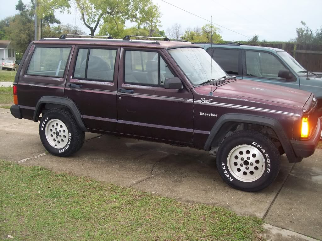

k so i finally got my xj running right. my dad had this xj and the throw out bearing went out in it, well he had trouble pulling the tranny and gave up on it. i offered him 400 bucks and made it mine. few days later me and a buddy towed it to our place to work on it. cause of work he havnt had much time. well yesterday i pulled the tranny replaced the throwout bearing, and went ahead and replaced the clutch. 5 hours later from start i had everything back together and ready to fire her up. well she diddnt fire. turned over and over but no fire. checked the fuel pressure its all there, so its 9 at night and im tired of working on this thing so i head in the house. this morning i went out in the shop and noticed i diddnt bolt the crank position sensor back to the bellhousing. bolted it back up and she purrrrrred.
so this is my xj
92 4.0 h/o 5 speed, 2wd

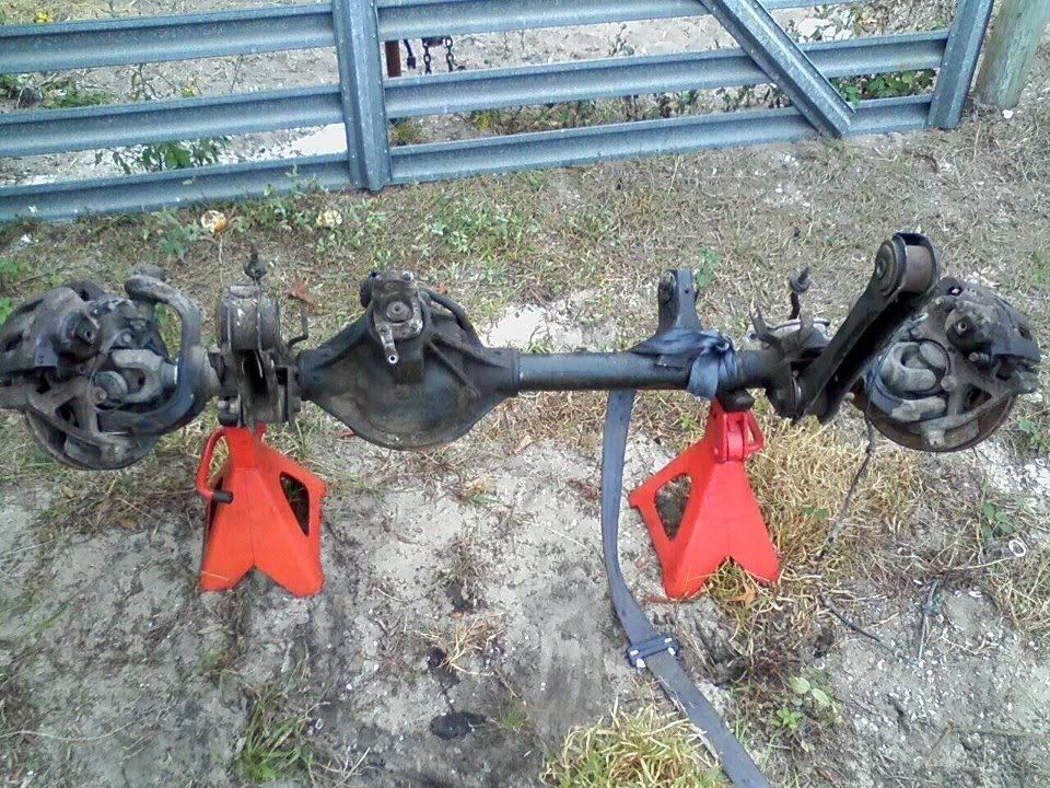

went to the only pick n pull left around here today looking for my 4wd parts, and found this
couldnt find a manual 4wd transmission and transfer case so i just settled for the dana 30 that i scored for $50. gunna throw it in when i do my lift in a couple of weeks.

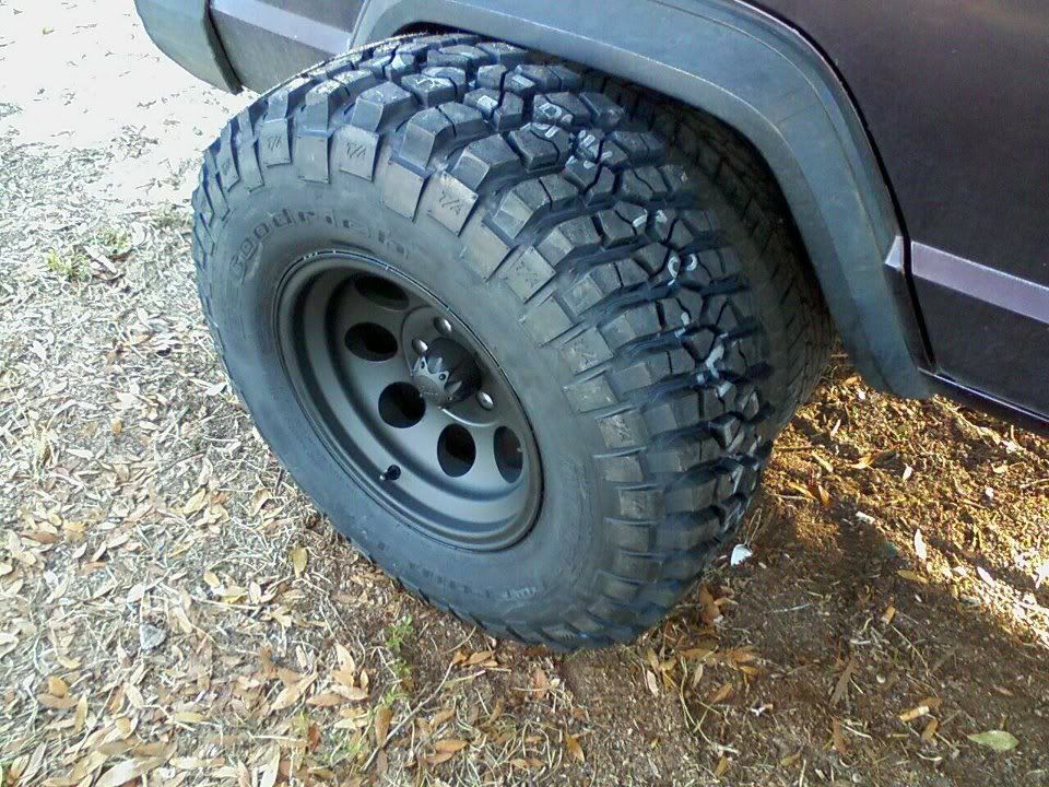

what rims you got there theyre slick?

they're pacer low gloss alluminum 15x8's

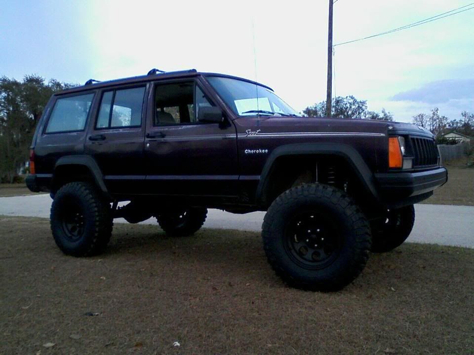

lift is finished. took all day but its in and ive got my dana 30 in the front. everything went pretty smooth except the rear springs. thought id never get them in but here it is
o and within 5 miles i finally experienced death wobble. so i guess ill get to that soon enough. need an adjustable track bar as of right now.

How do you like the KM2's? I keep going back and forth between KM2's and All Terrains just because I know the AT's will last 70,000 miles or so. How quiet are they at interstate speeds?

the kms's pull great offroad. especially for only being 2wd right now. they're not that loud really. if you have the windows down and the radio off u can hear them but nothing the radio cant drown out
