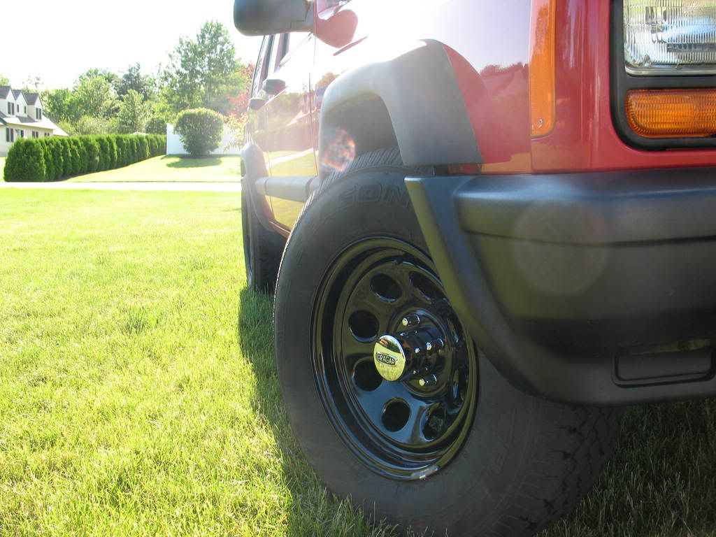

It won't look ridiculous with a 15x7 rim. I had them on my Cherokee with 235's and they looked fine.
15x7 on 4" Backspacing
You can see that the back didn't stick out at all

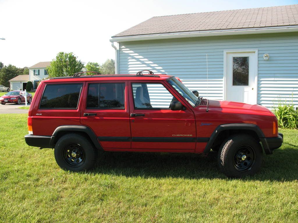

I have 4 inch backspacing as well rocking the 235's. I think it looks fine. I am not ready to get any sort of lift yet and did'nt want to put new tires on the stocker rims. I am not sure what it would look like if you have 225's which are about an inch smaller in diameter. The 235's tuck in nice.

same set-up here. 15x7 with 4"BS
White XJ on black wheels FTW!!!
