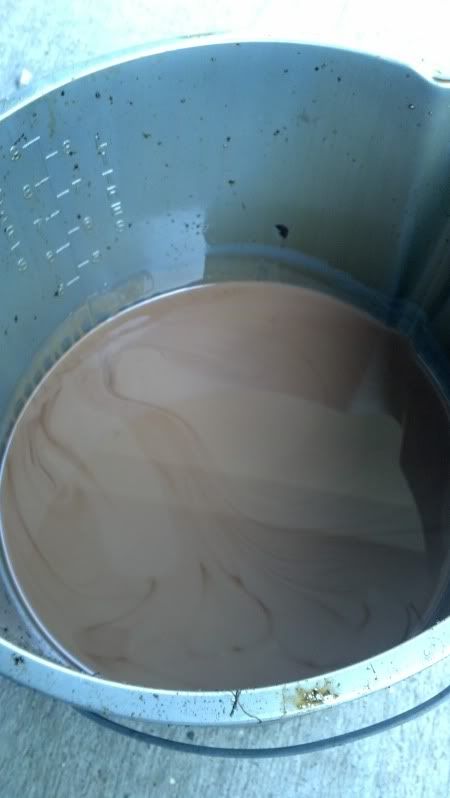

Perfect example of how your tranny fluid should NOT look. This is the second change since taking the jeep for a swim.

Nothing fun today just did some obligatory fixes.
Changed trans fluid again today (6th time). I seem to have finally gotten rid of pretty much all the water I took in a few weeks ago.
