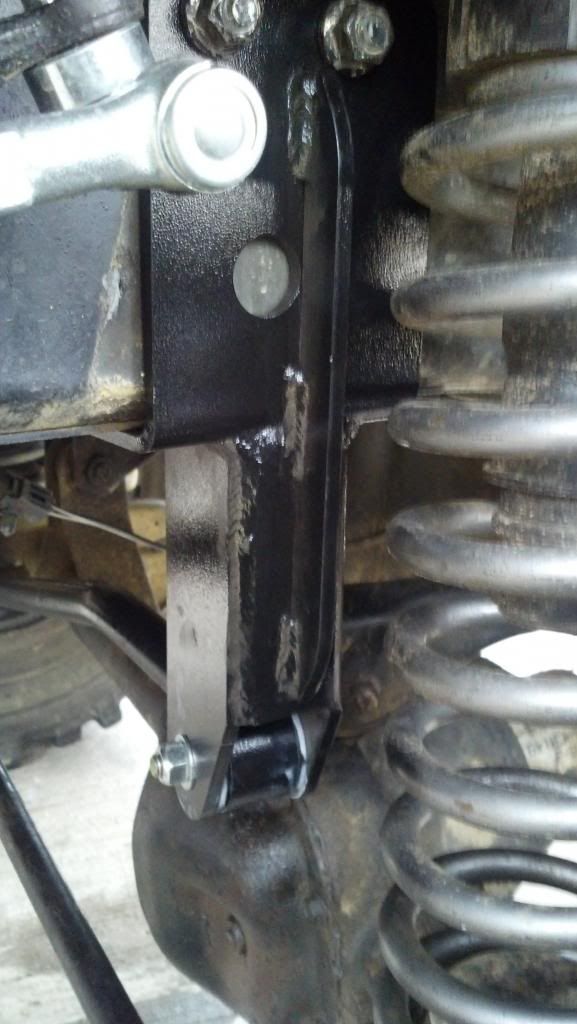

Adjustable track bar with a beefy drop bracket. Also installed some rc discos

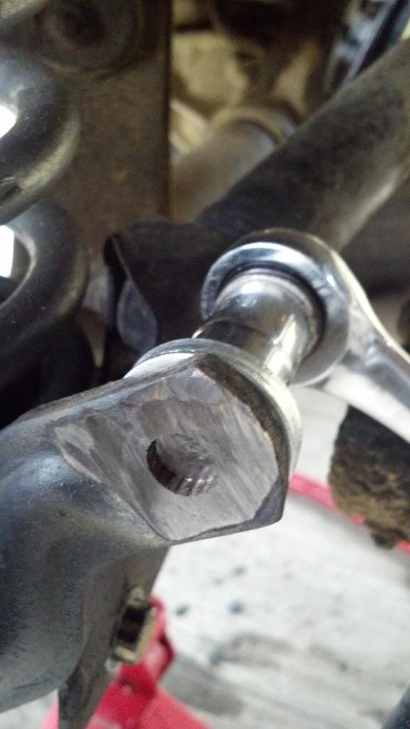

Ground the head off and created my own puller to get these splined sway bar link bolts out

Looking good!! That the RC doublesheer? Looks like what I ran on my last '99. I had to run a drop pitman arm to get rid of bumpsteer from how much lower it dropped the mounting point. All good otherwise!

Yep it's the RC double shear. It actually puts the track bar less than an inch higher than the drag link so a drop pitman arm would be counter-productive in my case. (Bought one anyway, want to buy it? lol) I have very slight bump-steer but nothing to be concerned with so I'm happy. The rig drives very well now.

Lol ok just checkin. I was running RC 4.5" coils and has noticeable bumpsteer before the pitman swap. Didnt really bother me anyway, mainly did it so I wouldnt have to hear the wife complain when she drove it haha.
