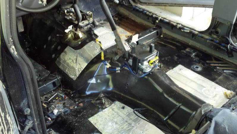

Tore the entire interior out today, scrubbed down all the plastics, pulled the carpet and put it all back together again. Didn't have much rust, just a little in the passenger's floor board. Going to give it a few weeks to dry completely and then I'll bedline it.
Oh, and did I mention I hate mud? Well....I HATE MUD! lol. It's in every little spot possible.

here's the small amount of rust I found. Not concerned at all just going to clean it up and paint over it.
