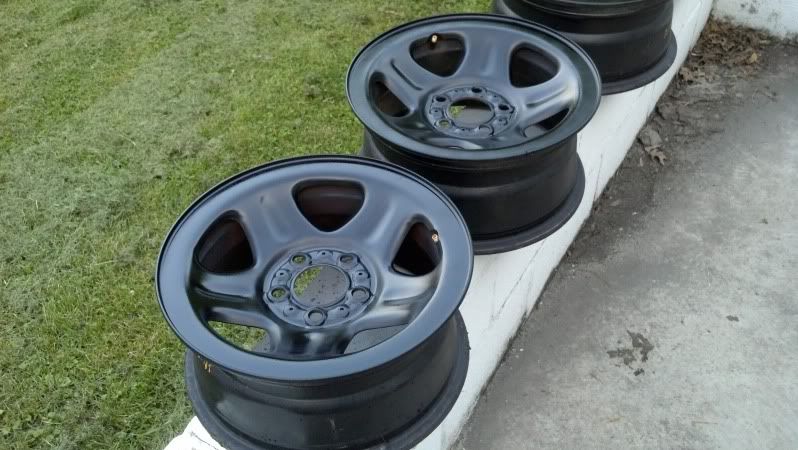

Didn't get very lucky at the junkyard but did find these bad boys in an old 94
Figured I would paint them black so I got the materials and got started.
Sprayed them down with Eagle One All Wheel and Tire Cleaner (the best stuff I've used so far) and scrubbed them real good then sprayed them off with water.
After they dried I put a wire cup brush on a drill and scuffed them up a bit.
Followed that up with some 320grit sandpaper and cleaned them again.
Here they are scuffed and ready to paint
I used Duplicolor High Performance Wheel Coating. It really seemed to do the trick.
Finished product after 3 coats black and 3 coats clear.
