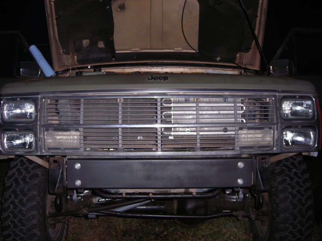

I got the last piece of steel for the rear bumper so I went and cut out the holes to the rear "frame" tubes. I think I might ask my father-in-law for a two more pieces of flat steel so that I can use the original 8 bumper bracket holes as well. As of now, I was just going to use two of the hitch bolts but I just don't think thats strong enough. What do you guys think?
Here is just a rough layout of how its going to be. I am also wanting to cut the ends of the bumper at 45* half way down to add some looks to it.

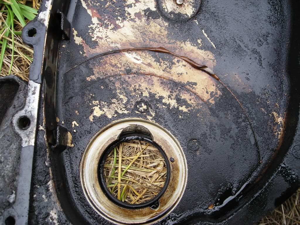

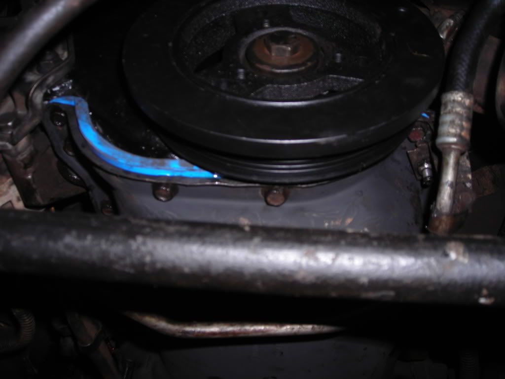

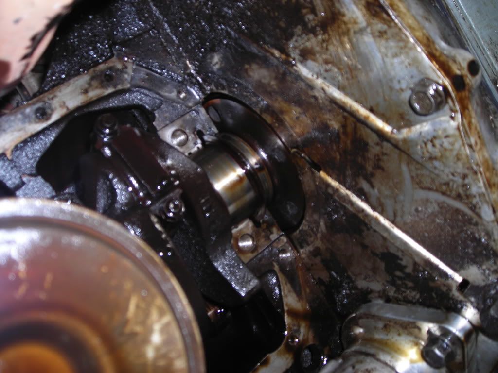

Well today was pretty good, I got the rear main seal replaced, which went together great. Just found out was missing one oil pan bolt. Also the RMS was hard as a rock so I'm hoping that the new one should help.
Afer installing the RMS, and the pan was off I needed to replace the timing chain cover, timing chain cover gasket and seal, and the harmonic balancer. When I first purchased the Jeep the harmonic balancer was bad and wore a hole through the timing chain cover. We didnt have the money at the time so I put some JB Weld on the cover to hole that was wore through. Below you can see the old cover with teh JB Weld compared to the newer cover. Also you can see that the old cover was actually broke around the seal. I installed Fel-Pro gaskets on everything today and actually that is all that I bought for all my gaskets. I used the one piece for the oil pan which was GREAT to install!
I also through a couple coats of some Rustoleum primer on the pan since I cleaned it out and had some time for it to dry while I was changing the RMS. Some of it got scratched off but maybe I'll through some more on there tomorrow now that its installed.

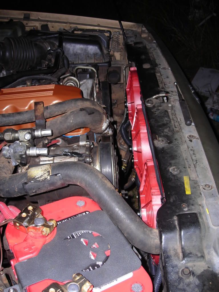

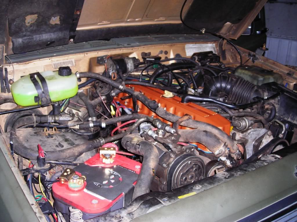

Today was quite productive! I first took off the valve cover, cleaned it all up and coated it wit some high temp paint to make it look a little better. I picked a metallic burnt orange for some reason but it actually looks pretty good IMO. I cleaned the gasket surface pretty good as well.

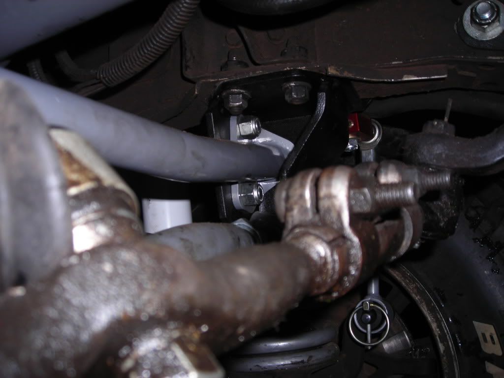

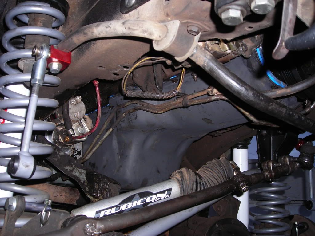

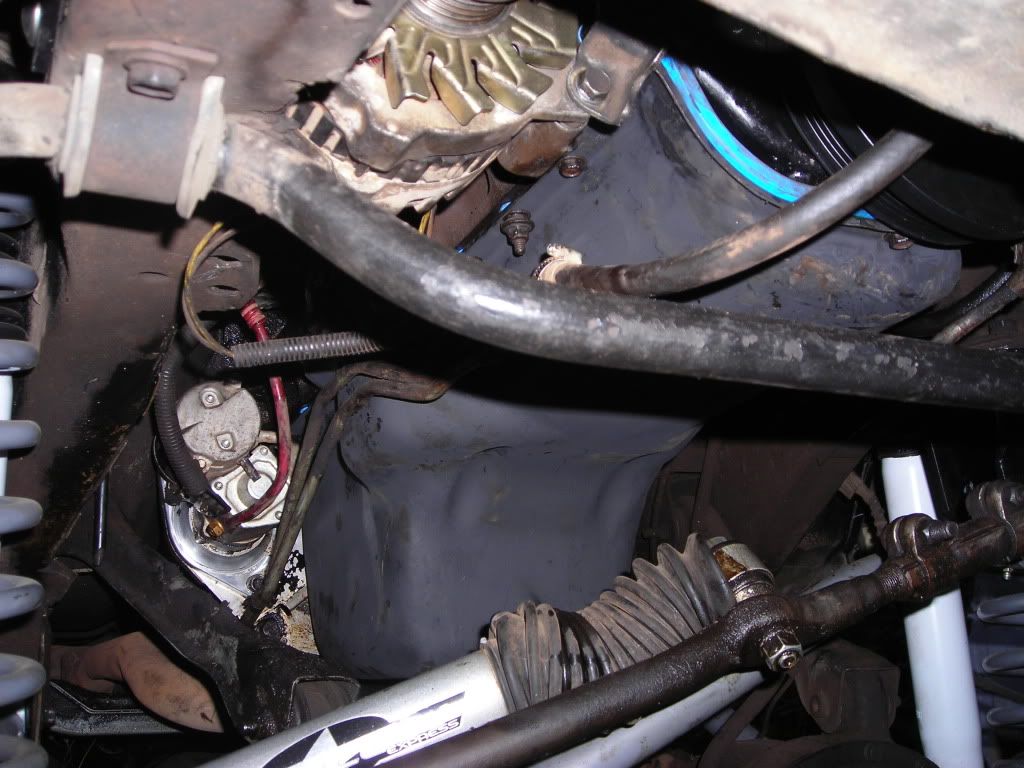

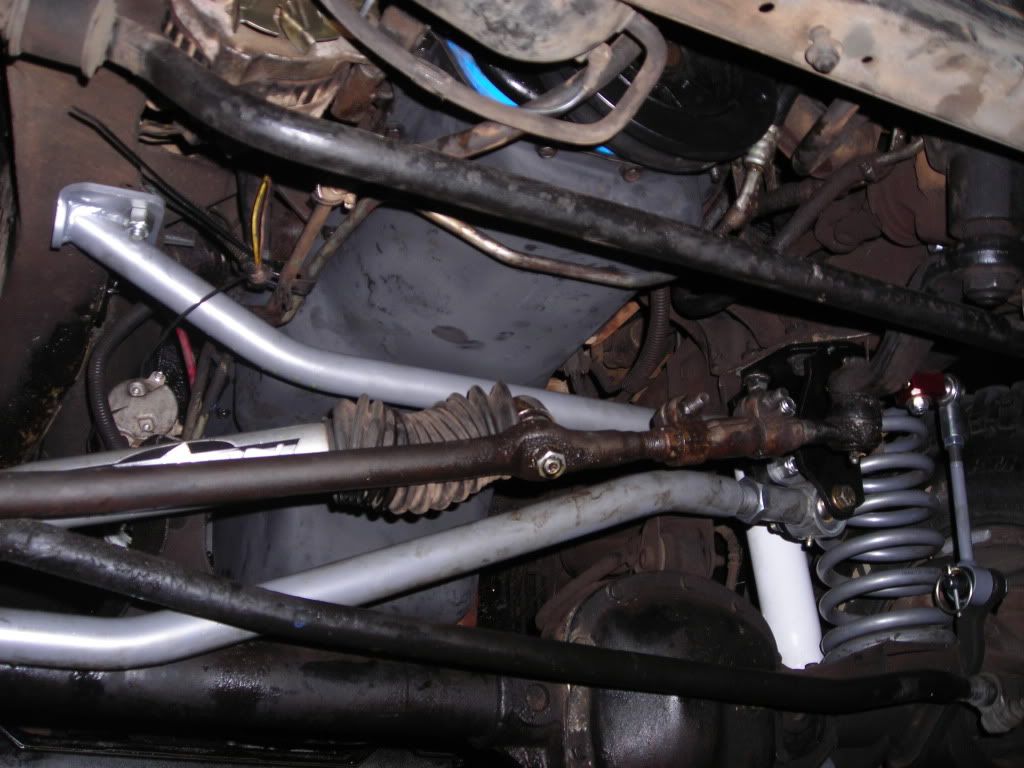

While the paint was drying I installed the Rubicon Express track bar brace, which wasn't as bad as most people say online. Just dont tighten all the bolts as you put them in, tighten them all together and try to put the bolts through all at the same time. If you get what I'm saying lol.
I removed my stock injectors and installed the Mustang type 3 injectors. I like the one piece design and plus having the 4 holes instead of the 1 hole just makes more sense.
After the injectors I jumped into the FF Dynamics Triple Threat electric fan conversion kit. The install of the fans went great and they look awesome! Oh I also removed the a/c condenser because there was no more coolant left in the system and I don't care to have it on there since I am going to be doing the OBA system in the future. Back to the fan kit. I contacted FF Dynamics and told them that I wanted to alter their setup and have all three fans run when they need tofor the radiator, but then also have one fan (the driver side fan) run when the tranny cooler temp rises above a set temp because it sits right behind the tranny cooler. They recommended me getting another one of their wiring harnesses and using it in conjuction with the other one. So that is the way I have it hooked it, its going to be so nice! I also installed a switch on my dash to shut off all power to the three fans for when I go through deep water.

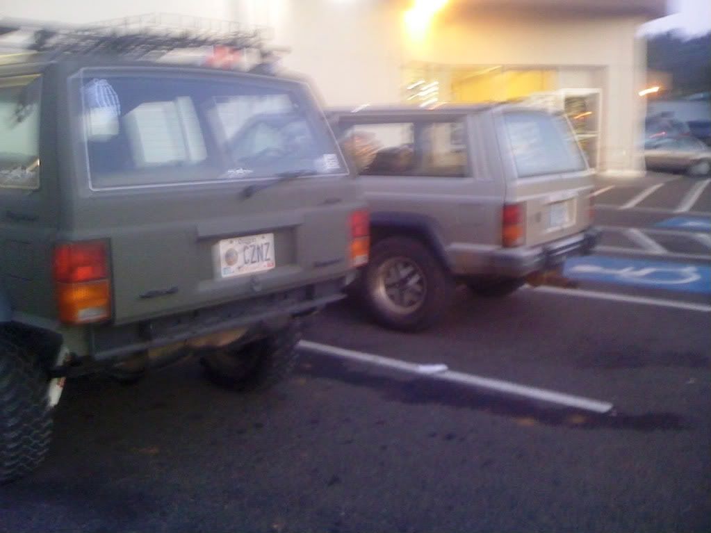

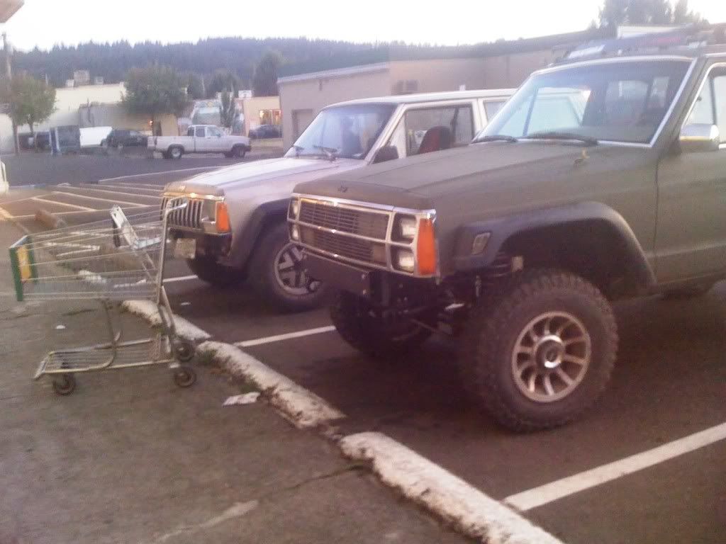

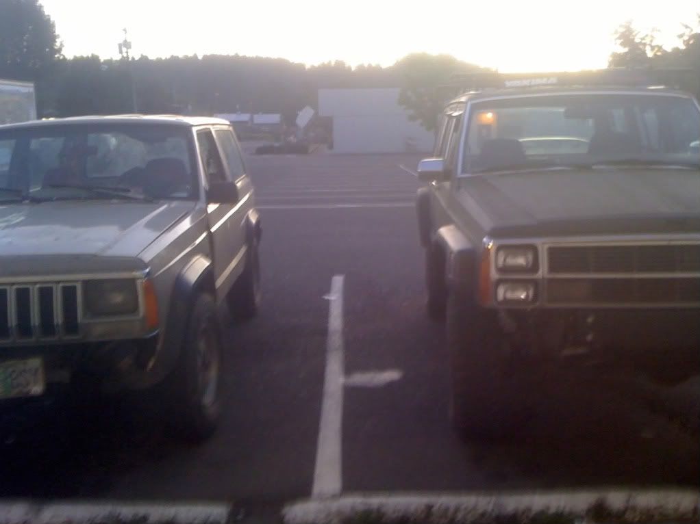

I drove down to the store lastnight and parked next to a stock XJ just for the chance to compare it hehe. Here are the pics:

lol if the owner of that stock one saw yours next to his he would be annoyed!! nice rig!
2 jeeps, ones fine, no mods the same as the other apart from the others has been hit side on by a damn landrover discovery!!! and now has a bent chassis!! grrrrrr!

haha, actually i pulled up right after they parked It does make a 3.5" with 30" M/Ts look pretty big though lol
