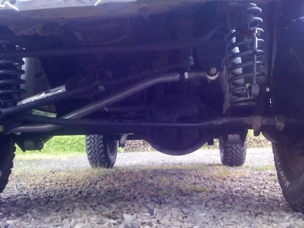

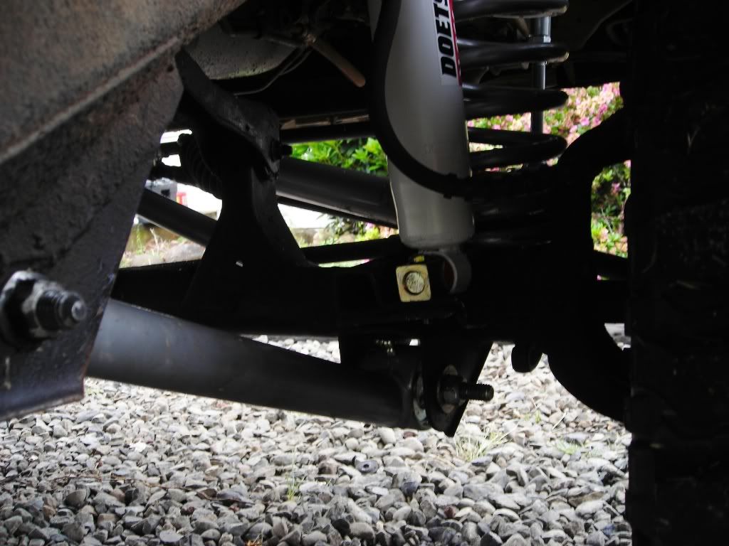

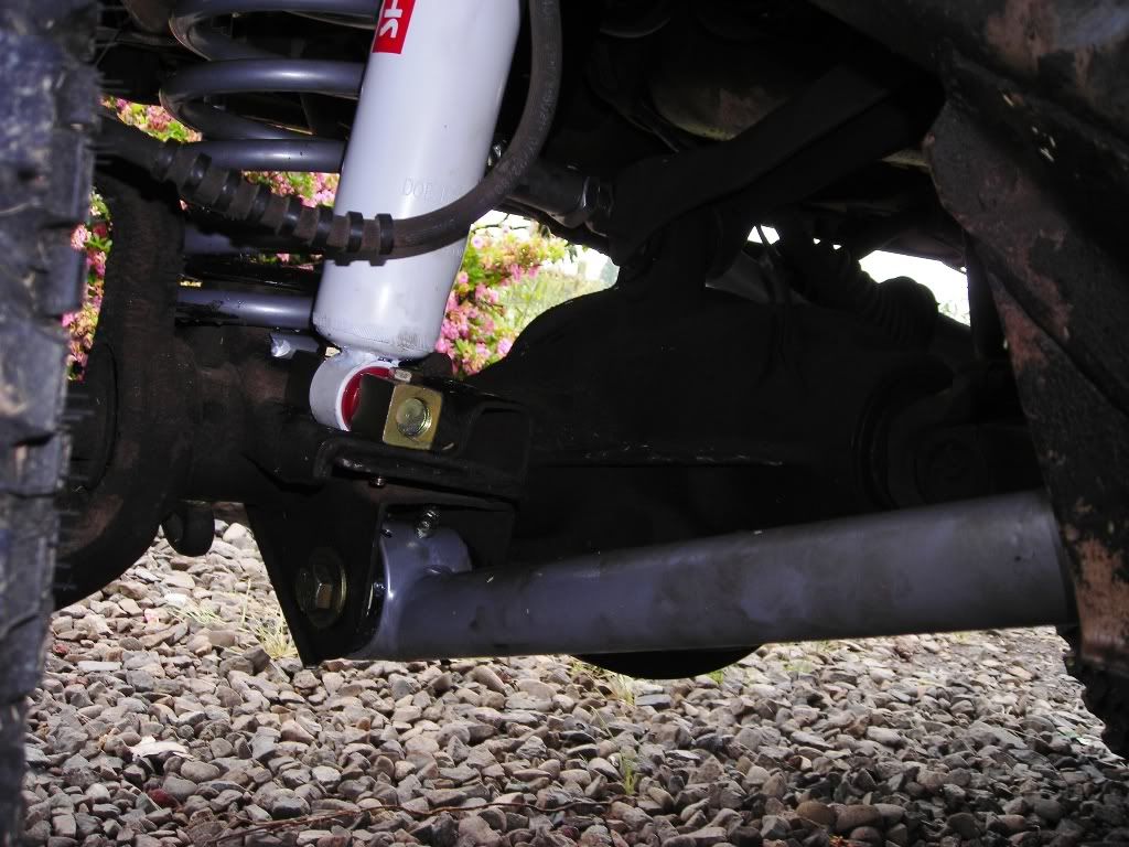

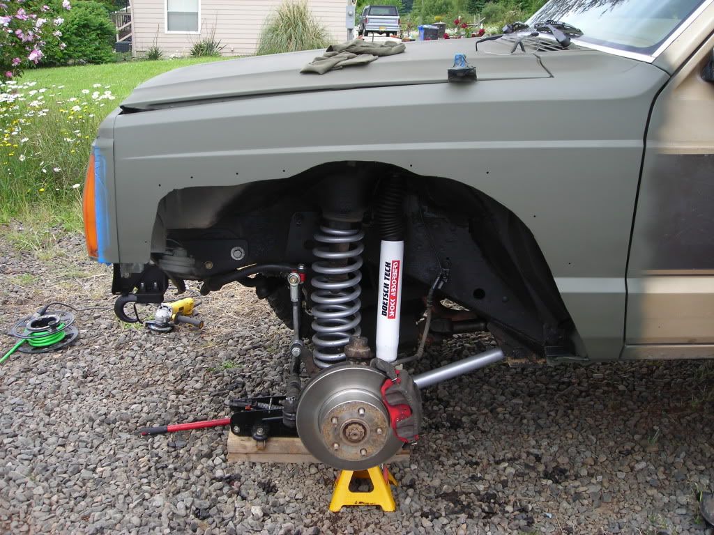

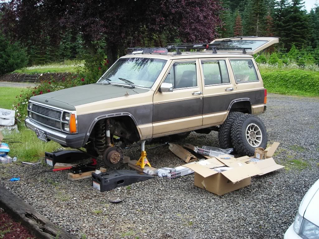

So the update is that I have installed the RE SF lift with the full spring packs and it is great! I had NO rusted bolts, I pre soaked everything in the aceton/atf mix that was mentioned before so maybe that helped. I have some more pics on my camera but I cant find the stupid thing so I took some pics with my phone. So far i've installed the RE kit with the GEN2 discos, the DT 8000 shocks, front and rear JKS BPEs, the RE adj track bar and mount (haven't done the brace yet because I have to remove the oil pan soon and didnt want to waste more time, so thats soon.). I installed a 96 Grand Cherokee V8 tie-rod (HUGE difference) since I noticed that my tie rod ends were bad and I found one at a JY for $13. I cut the front "fangs" out of the front fenders and am getting ready to cut the fenders out for my TJ flares, and I also sanded/grinded out some rusts spots and primered those so I can finish the O.D. green paint job. Today I picked up a '88 XJ gauge cluster with the tach and installed that, also broke my STUPID speedo cable. Oh I also picked up a 4-Runner roll bar for the back.

So I still have a lot to install, so once I find my camera I will show some more pics and plus I will try to take more pics as I install the rest of the stuff and work on the motor a little more.
I was a little worried about getting the DT8000 shocks because of what others say about that brand but from what I have experienced with the 8000's is that they seem great. They are a little stiff but I would rather have that than a bouncy ride. To me the ride pretty much feels the same as my stock setup with the helper springs in the rear, I was actually a little surprised with how there wasn't that big of a difference. I'll tell you what though, the shocks are extremely beefy, and a LOT heavier than the ones they replaced. The shafts on them are HUGE and the extra bump stop that comes on the shaft is pretty sweet. I haven't got to take it out on the hwy at all but thats just because I haven't got my alignment done yet, I've drove down the back roads at 60mph where I live and bombed around my yard a bit.

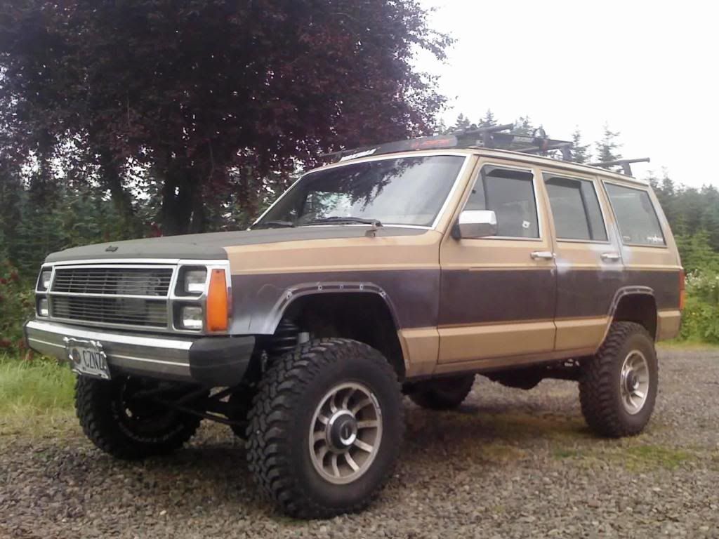

I finally found my camera so here are the xtra pics that I found. Since these pics even I've installed the C4x4 tow hook kit and C-Rok steering brace kit. Pics to come on that.

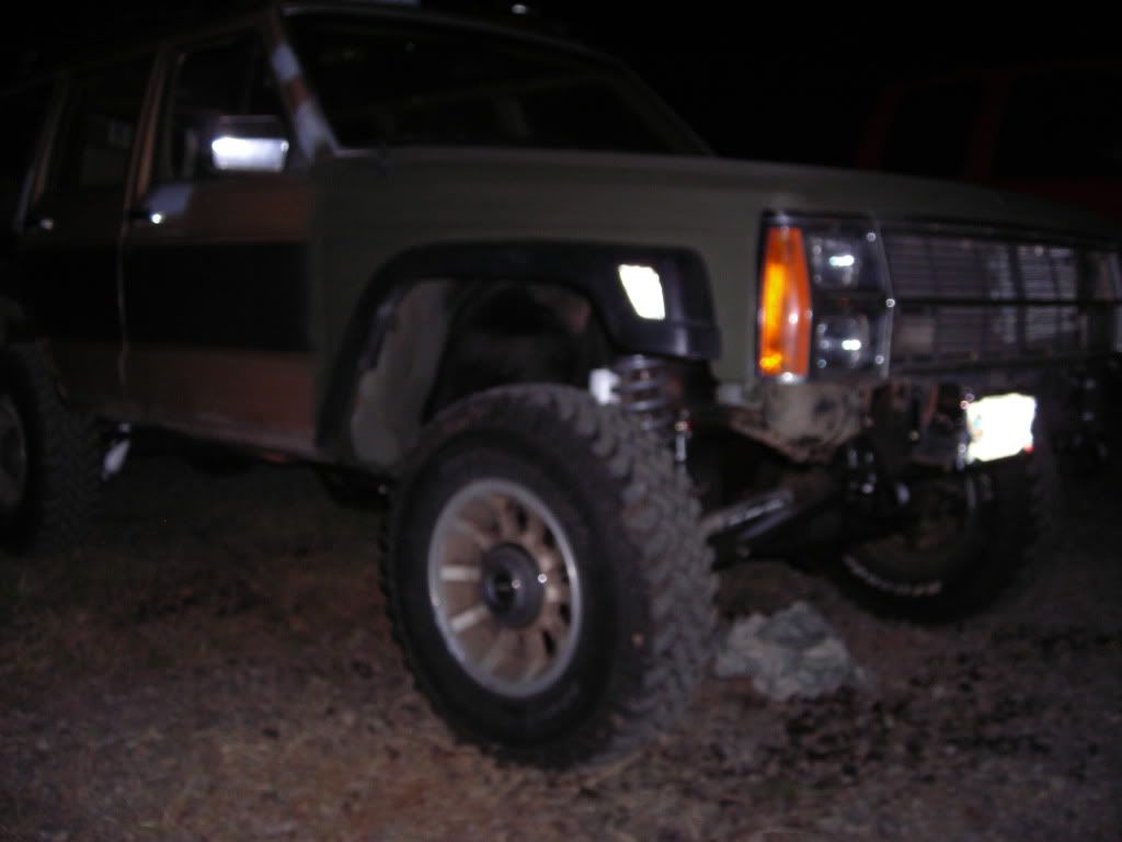

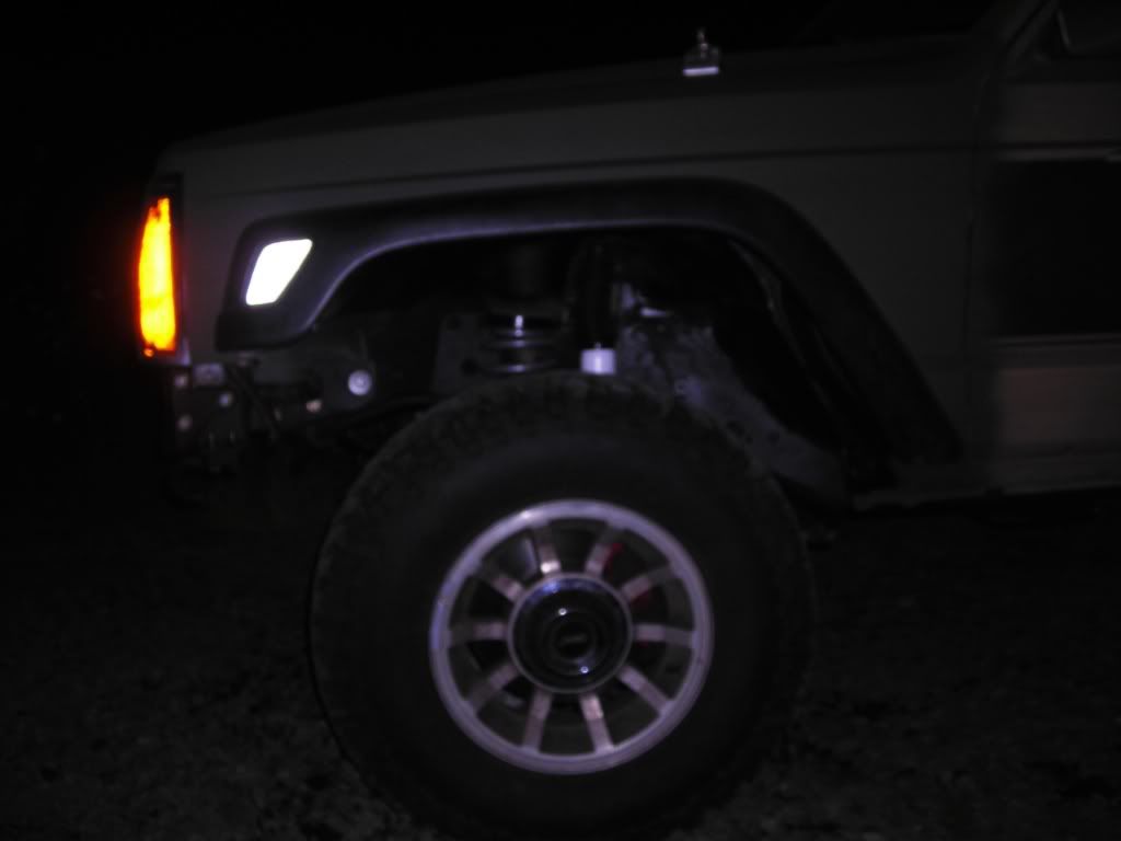

So i got the front flares cut out, painted and screwed the front flares on. Here's a couple pics I took tonight, I'll take some better ones tomorrow once I get the rears done. The reflectors look white but thats just because they are reflecting lol They are actually a smoke color which looks almost matches the paint, its weird and looks great. Hope you enjoy and let me know any suggestions or comments.

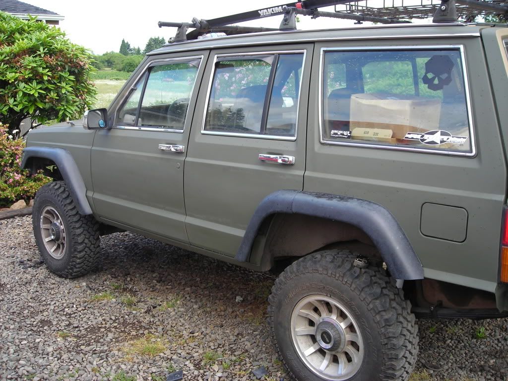

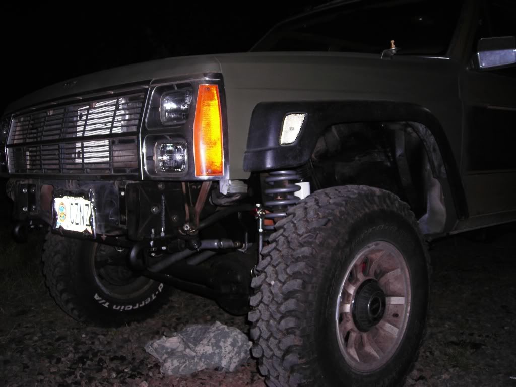

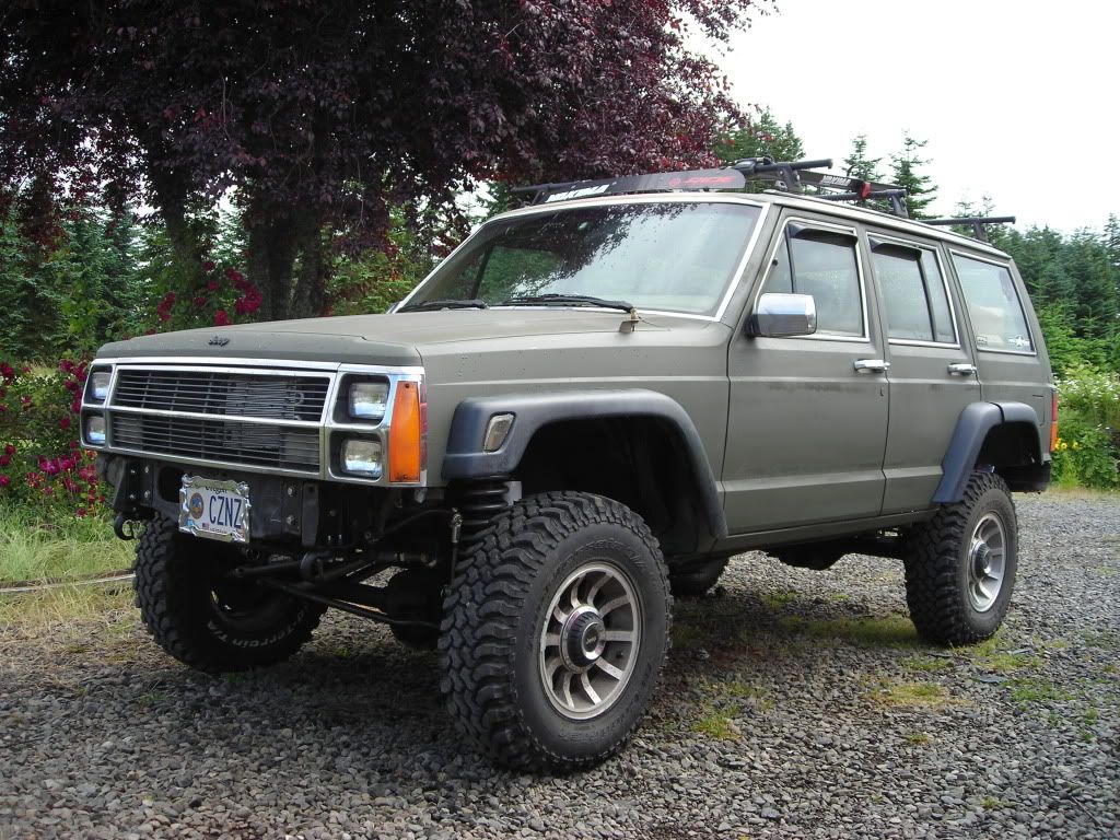

Here's some quick shots of the driver side after it being all done. And for all you inspectors out there haha those are runs in the paint, it just rained last night. haha But you can obviously see where I ground off the pin striping with a course wire wheel. I didnt think it was going to stand out that much but in all reality it will be getting scratches soon anyways. lol
And i think it looks kind of goofy with the 30x9.5 BFG's on there now that I have the TJ flares but I did them because I plan on running larger tires very soon. And didn't want to deal with it then. Hope u enjoy, plus any comments or suggestions are welcome.

Looking good, but looking closer at your picures I do see a problem. The lynch pins holding your sway bar links to the axle are backwards. Turn them around so the offset part of the pin is outside. This helps keep them from falling out. I have lost several and keep a few from a tractor supply store in my Jeep, just in case.

Thats funny you mention that! My buddy did the driver side sway bar install and I did the passenger so after he left I went over and double checked it all and noticed that as well. Thanks for the info about where to get those though and having the spares, good idea!
