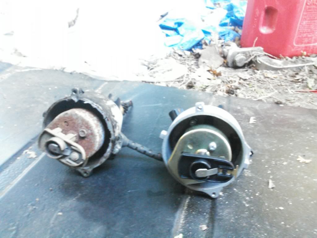

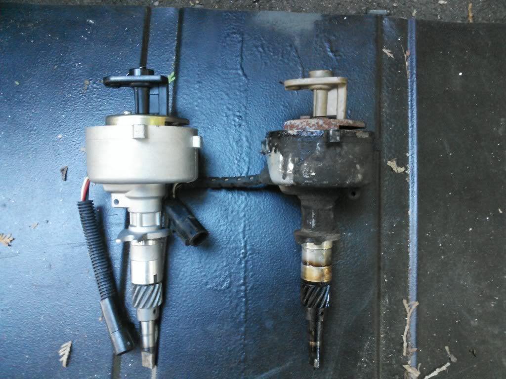

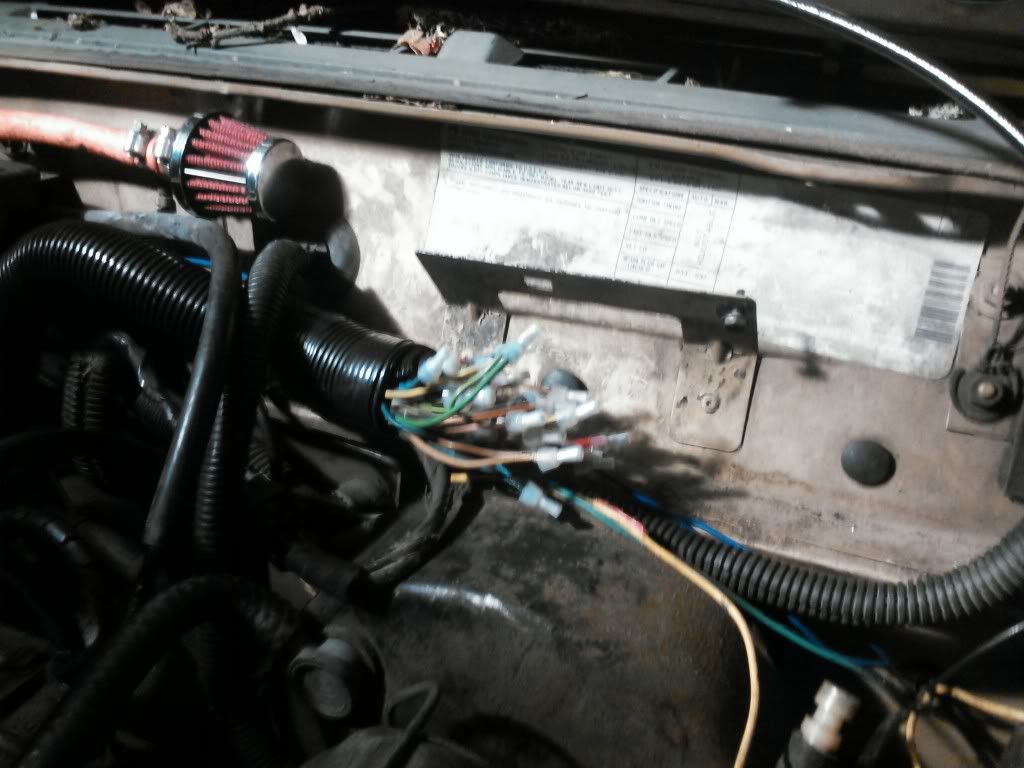

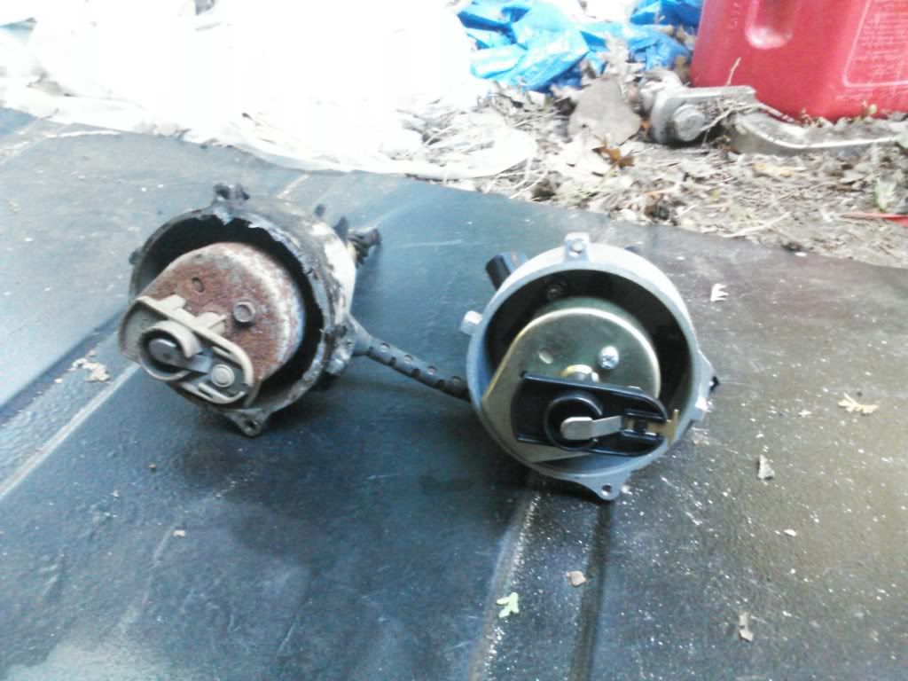

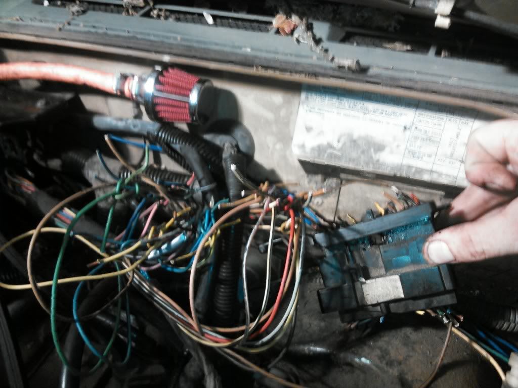

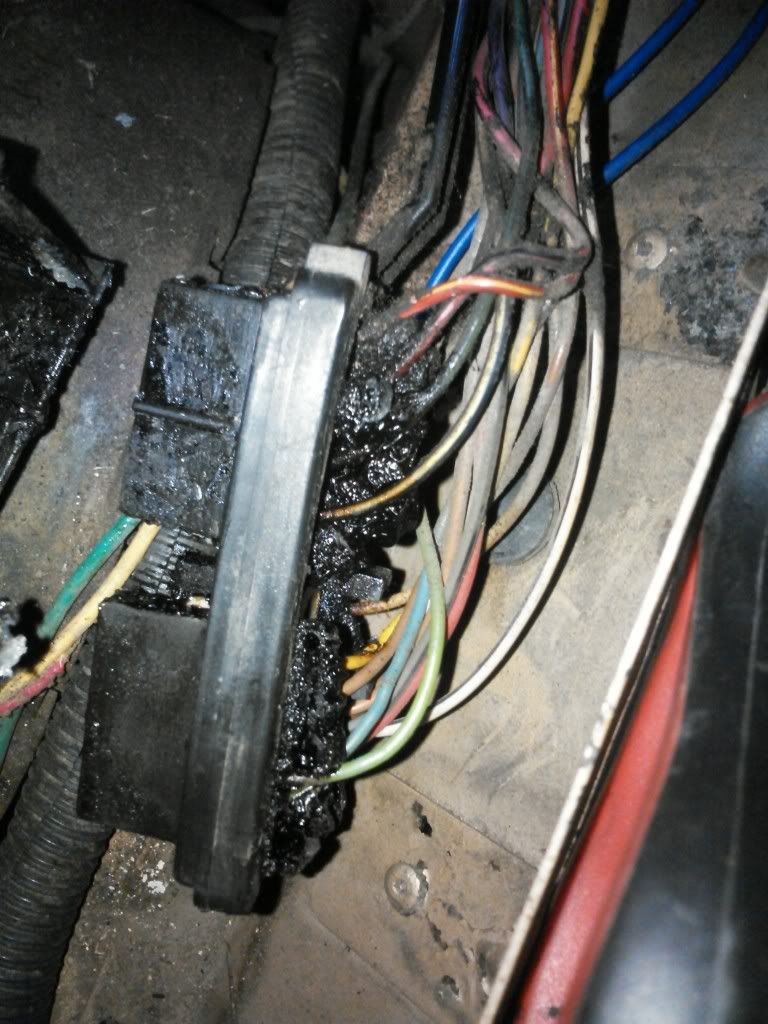

So after getting some help from TJWalker, I decided to order a new distributor for $48.79. A new CMP sensor was $41? From what he said, and what I read on the ol' interweb it sounds like the closest to what I'm experiencing. Plus, I don't think having a new distributor could be a bad thing. I have to also admit that I have definitely brainwashed my gf enough to where she actually thinks getting new parts is better than used! And she thinks spending more money for upgraded parts is worth it!! lol
Anyways, here are some pics over the last few days (56k users beware! BWAHHAHAHAA). I know nothing is cool about wiring pics BUT it was a very tedious job cleaning all of that crap up AND it's my build thread!

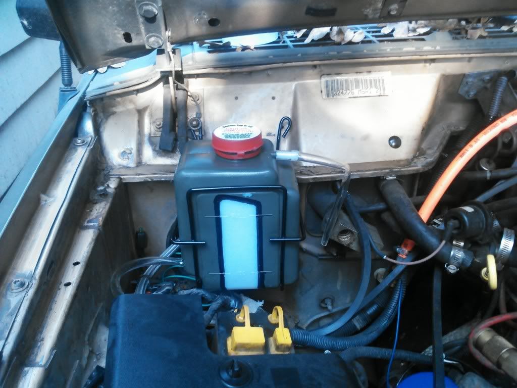

I also picked up an InterDynamics big coolant reservoir kit. The bottle I had before looked horrible and wasn't even mounted lol So I mounted the bottle holder thingy on the upper passenger side of the firewall. I'll get pics tomorrow

I ended up replacing, and indexing (which I verified a few times), the new distributor and it seems to be just cranking over, but not igniting. I need to get a fuel pressure gauge, but I did press the gas pressure release valve and there was definitely pressure. haha The fuel had enough pressure to shoot the side of the filter box, and you can smell the gas in the chambers.
Here are a few pics from the last few days

She's alive!!! I found out that the crank position sensor had grounded out on the back side of the header! I ended up cutting, and soldering it back together.
I also ended up installing a brand new distributor because the cam position sensor went bad. Which I'm sure can't be bad since I do have right around 300k miles. Haha
