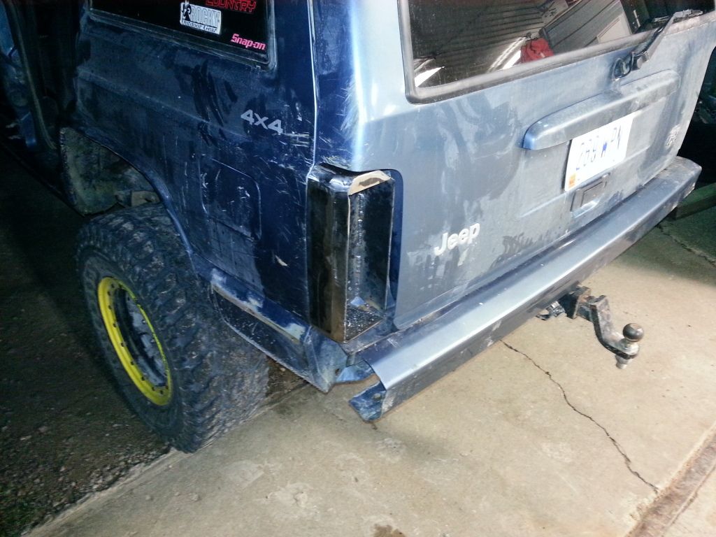

So who wants to laugh at my attempt in making taillight boxes.

Looks good from my house. Are you just welding together cut pieces of sheet?

Well it's a little thicker than you run of the mill taillight box material. Maybe a lot thicker.... its what I had laying around so I used it.

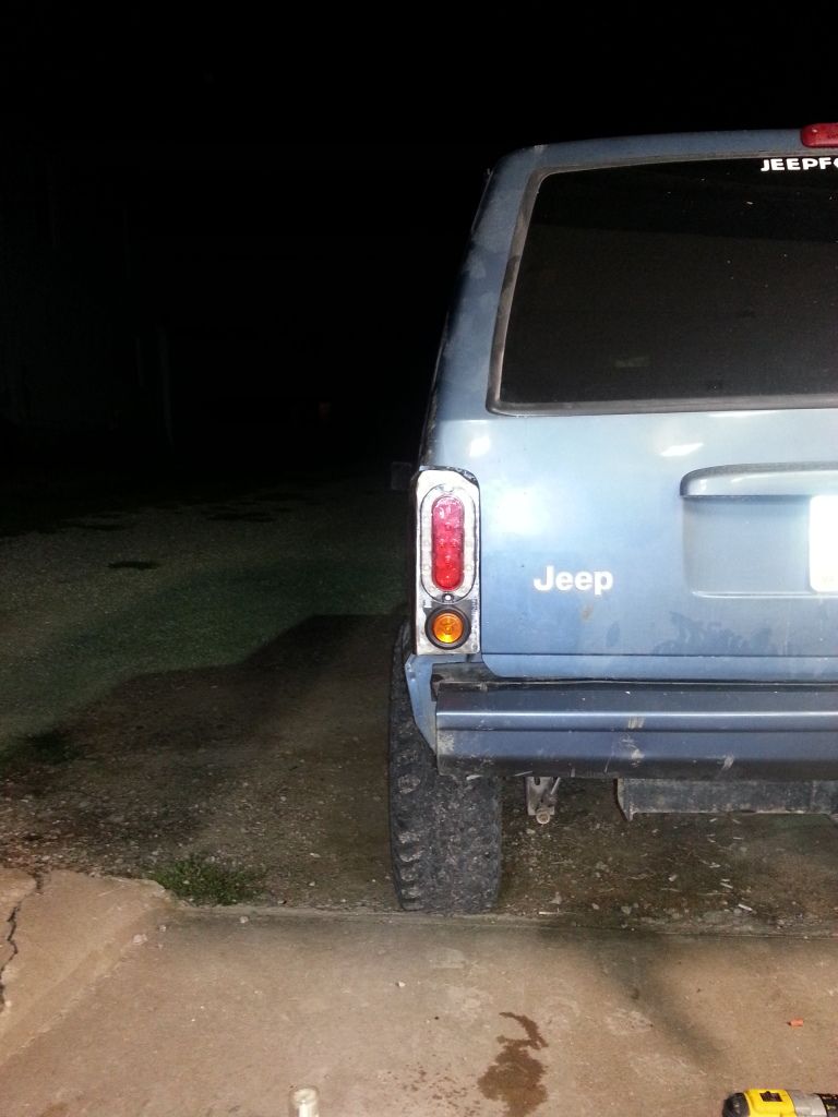

All but paint and wires done on the drivers side.

Looks good, dude.

Looks good, dude.
thanks man! I put a lot more time into them than I thought I would.
