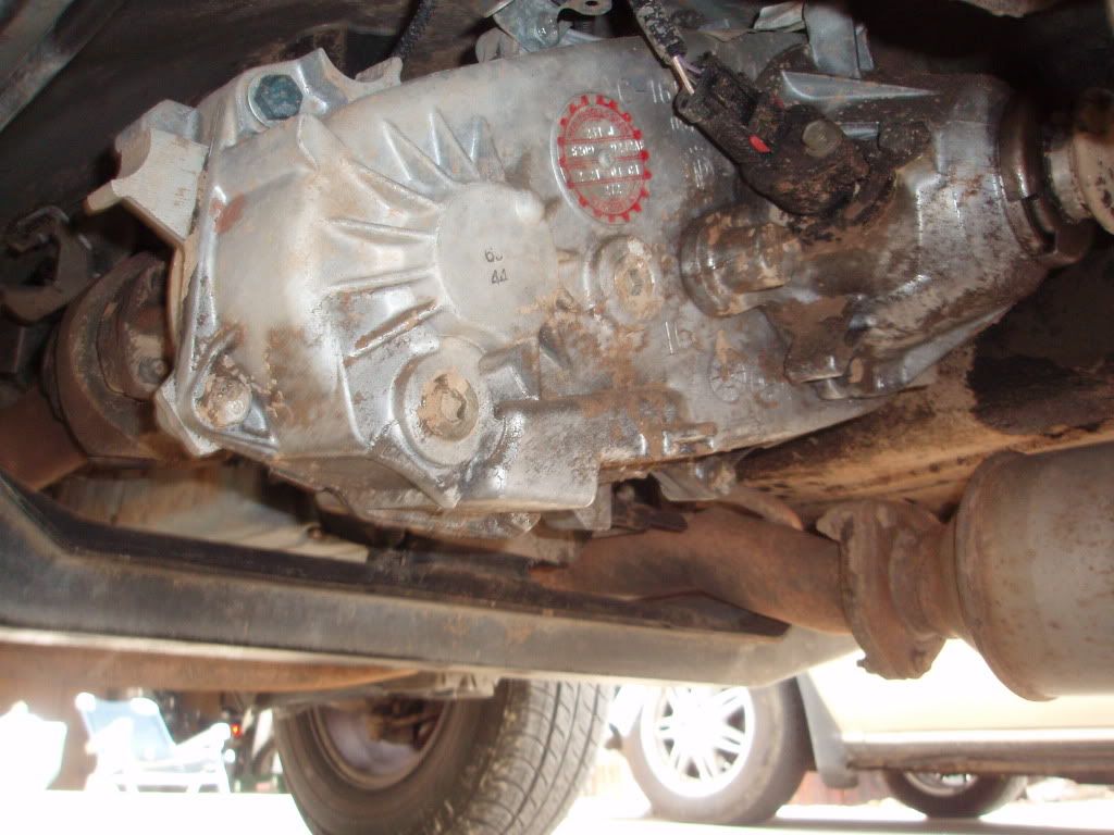

looks like i found a T-case leak.. Not sure yet

post #22 of 119 Old 06-19-2009, 06:28 PM
HankyDanky
1989 XJ Cherokee
Location: Scottsdale, AZ
Posts: 595
Originally Posted by connor0770 View Post
and now i have a ? basically there seems to be oil leaking all over my transfer case???? how should i go about solving the problem?
I would just buy a new Jeep... Those oil leaks can get nasty real quick...

Posts: 6,221
oil leak? All I see is dirt man. My '90 XJ had so much oil on the T-Case that it didn't even look silver anymore. It was more brownish-black. Nice XJ and i'm thinking about painting my front plastic parts also. The glue for the trim is kind of a pain, but its really worth it and I'm so glad I did. People compliment on how clean and straight my body panels are because it looks better without them.

post #25 of 119 Old 06-19-2009, 11:01 PM Thread Starter
connor0770
Location: Cameron Park, CA/ Reno, NV
Posts: 3,496
hahah no trust me its leaking oil. not alot but enough to worry me... and i think me rear axle is leaking a little also. think i might be changing that 2moro.

post #27 of 119 Old 07-26-2009, 04:50 PM

If you are leaking fluid around the speedometer gear housing all you need is a new o-ring. Just remove the one bolt and the little clip the bolt goes through and pull the housing out. There is a o-ring that goes around it right where it goes into the t-case, replace that o-ring and stick it back in, put the clamp on and put the bolt through it. No more leak.

post #28 of 119 Old 07-26-2009, 05:53 PM Thread Starter
connor0770
Posts: 3,496
sounds to easy to be true. alright ill prob end up doing it next week, when i have time. thnks
