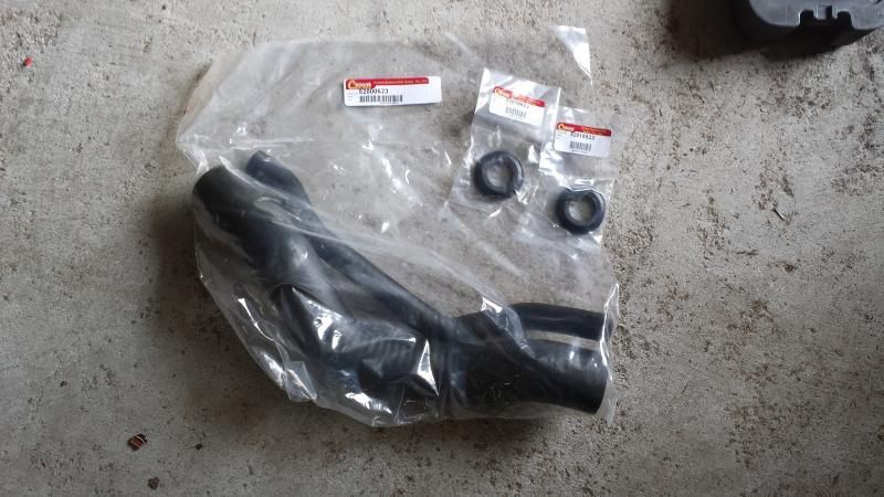

Placed another order at RockAuto today-
Radiator
Radiator cap
Lower hose
Upper hose
Water pump
180* T-stat
Water pump inlet tube
Coolant recovery tank
Both L&R calipers
Pads
Rotors
Still need to get a fuel pump assembly and more rubber fuel line. And I need time to install all of this...

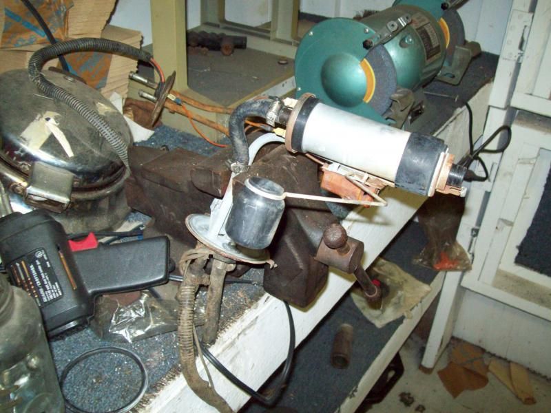

Picked up the pump assembly today. It is from an '87 so it is shaped different, but the power plug is the same and the lock ring looks the same, so I think I can bend it to the shape I need and make it work.

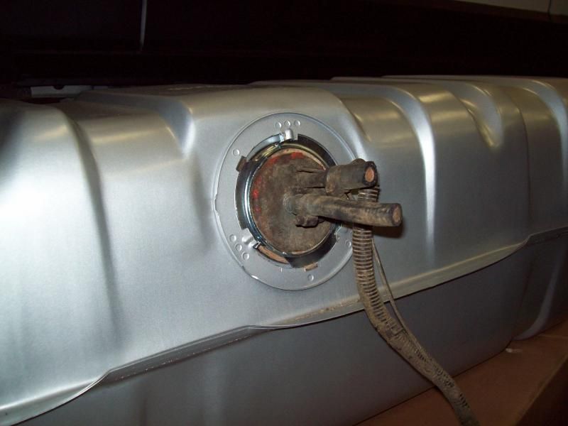

post #24 of 77 Old 08-15-2014, 10:09 PM Thread Starter
biggn235
DAS Man
biggn235's Avatar
2014 JK Wrangler
Location: Hotels
Posts: 1,646

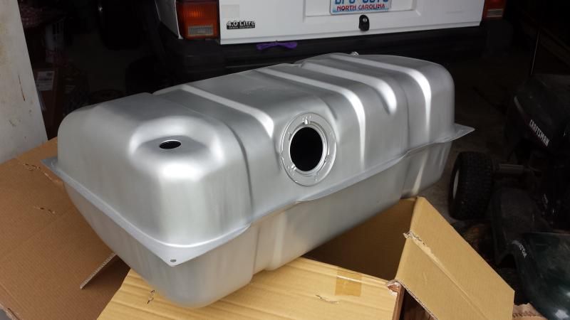

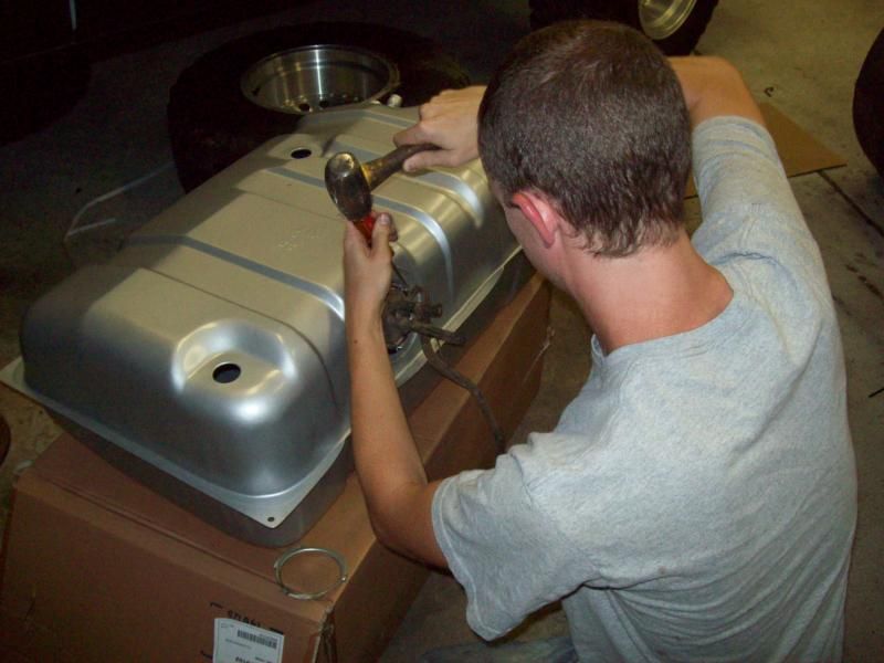

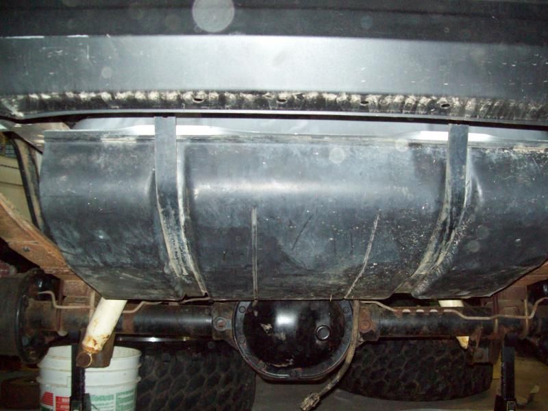

Bought some fuel line today and got to work.
Put the "new" pump assembly in a vice and bent it to match the shape of my old one.
New filter and hose installed on assembly and installed.
Getting these stupid filler and vent hoses in was a pain in the ***.
But it's in!
Turned the key and she fired right up.
Video of it idling. Purrs like a kitten.

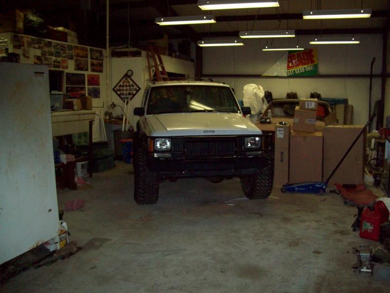

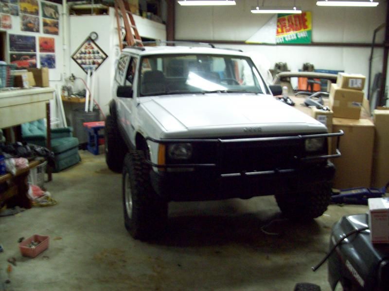

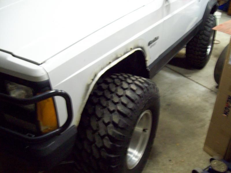

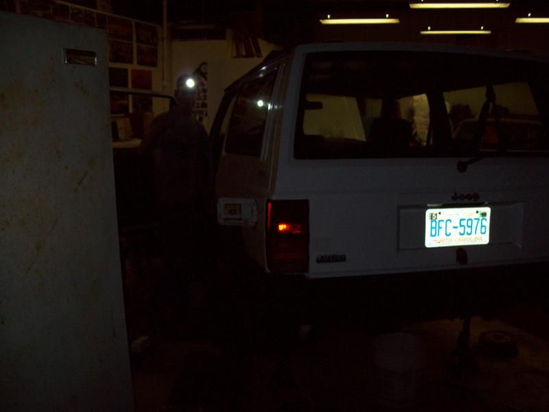

Backed it out of the shop, turned it around, and backed it back in. Ready to tear down the front tomorrow.
Ripped the fender flares off.
Hopefully I'll have all this installed tomorrow and we'll be ready to start some fun mods. Maybe.
