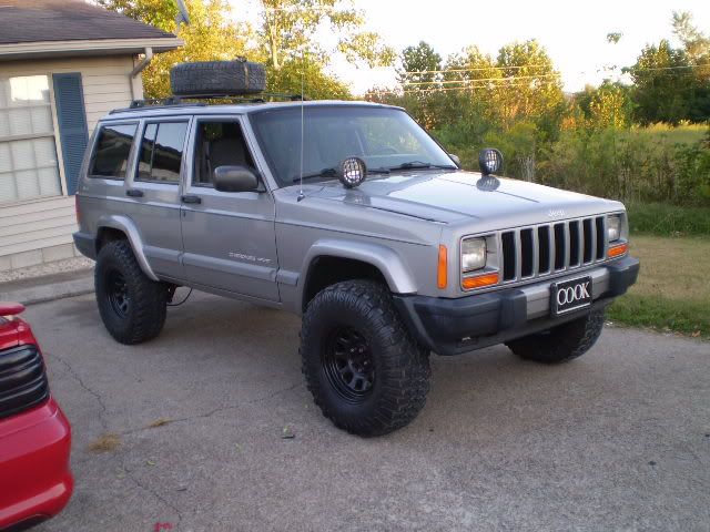

Yet another similarity in our build paths lol. My 01 was setup for DD duty, with a 3inch on 31s, no BS cutting n hacking. I am trying to make my 98 a slightly improved copy of my 01. Heres the 01, saggy add a leaf n all.
