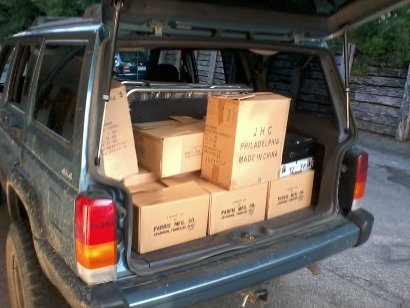

Haven't done much lately, I've been moving into my new place and still working 45 hours a week so no progress or changes have been made.
The XJ pulled a trailer great though and carried all of my possessions across town by itself.
Load after load.

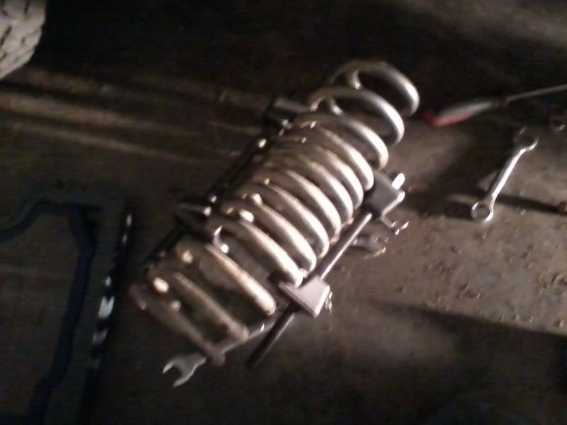

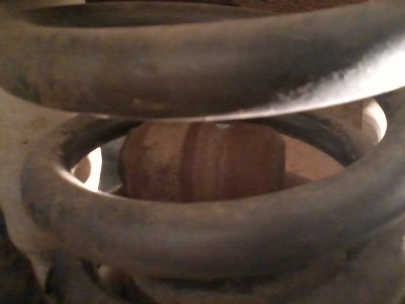

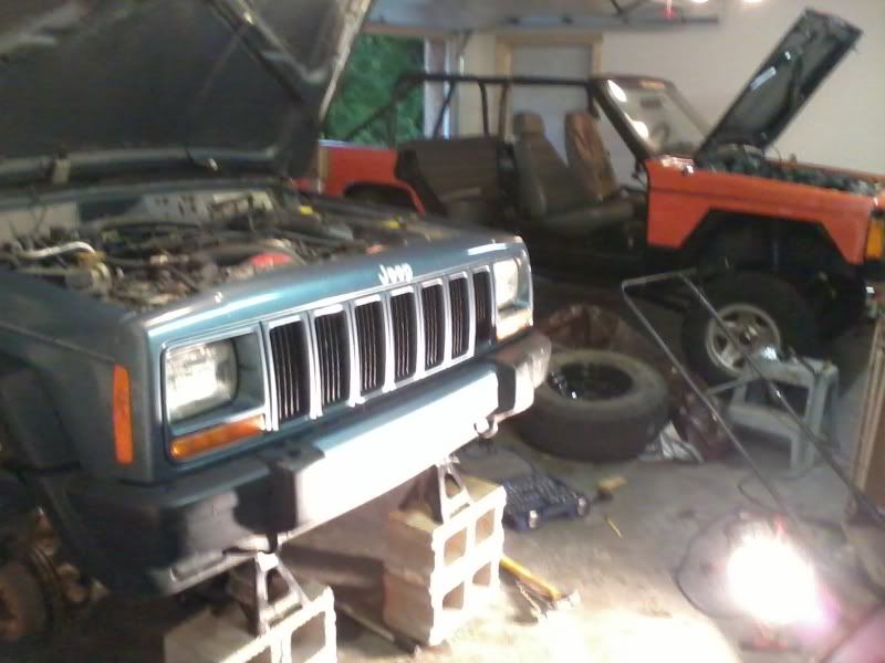

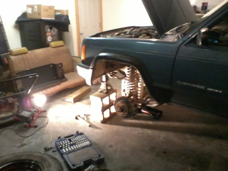

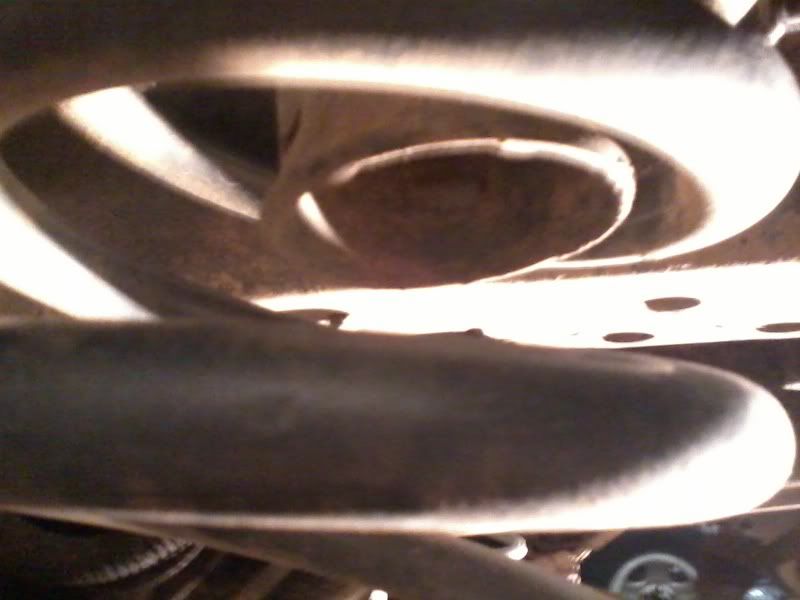

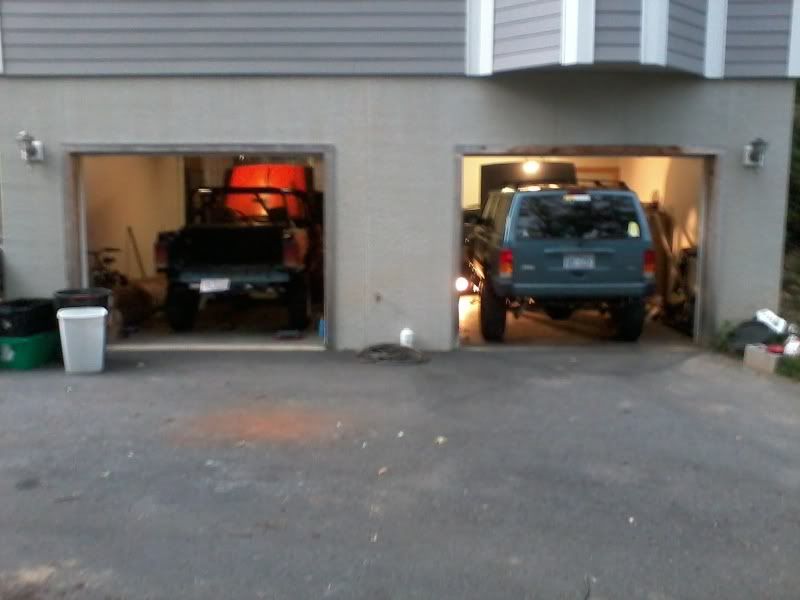

Got tired of the prerunner look and decided to get rid of the spacers and the track bar drop bracket yesterday.
Before I got started good I had to get everything back together really quick and move into the garage because of rain.
Love having a garage!
Front coming apart.

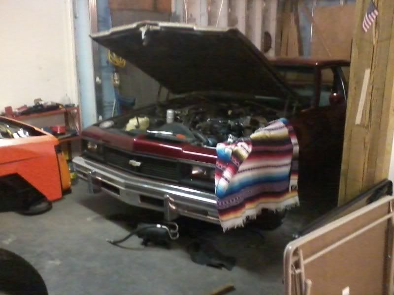

The '79 watching me work.
I don't think this bumpstop was doing anything.
Coils compressed yet again.
I still don't understand what is going on with my lift. The front still sits higher than the rear, even with the longer Daystar shackles. The leaf packs are brand new, not add-a-leaf, and there is no weight in the rear of the Jeep. I don't know, it's not by much but it's enough for me to still notice. But whatever, I'm tired of messing with it.

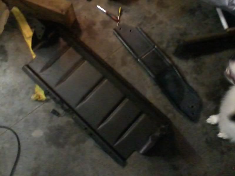

Got these today.
Not bad for 50 bucks. The front skid has been reinforced with angle iron and it is hefty. The transfer case skid is a factory part but it's better than my non-existent skid. Both are powder coated black and are solid, not even surface rust.
Will be installed tomorrow.

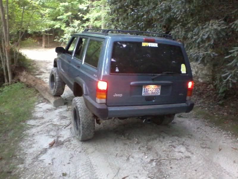

We actually ended up going anyway haha. It turned out to be a quick decision at about 7pm last night to just man up and do it. I took a couple of pictures, nothing special but I'll post them up a little later.
Right now I have a question- what do you guys think I should do; new 31s and keep the body of the XJ stock, or 33s with trimming and Bushwacker flat flares?

Wheeling pics from last night
