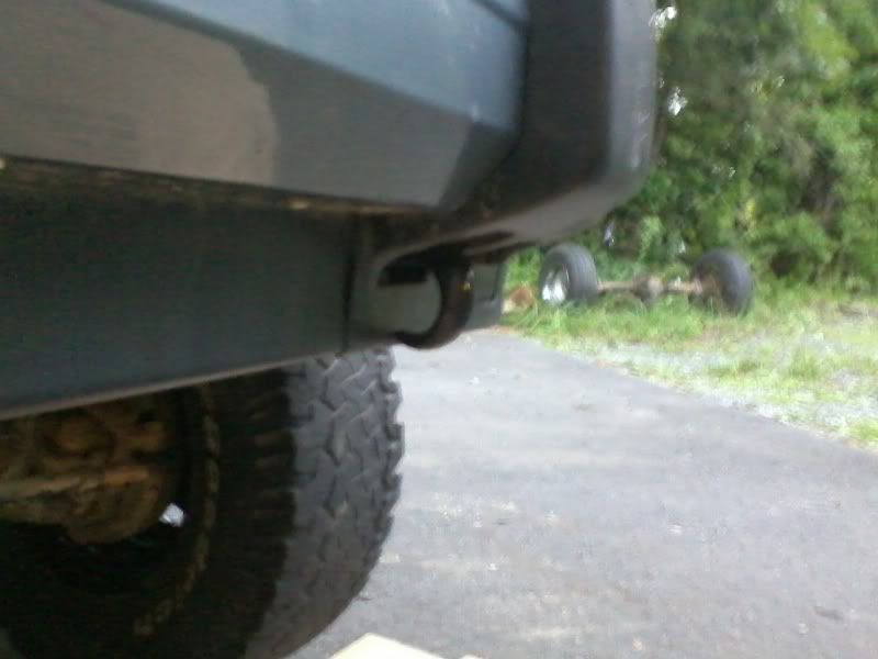

Had to modify the shackle mount slightly, it was too big for the hitch. Apparently Crown Automotive doesn't have very good quality standards if you have to grind it to make it fit. Whatever, nothing to complain about, I made it work.
Using the Angle Grinder of Death I removed enough material on all four sides to make it fit inside the receiver.
Hit it with some Rustoleum paint, and it is ready to go.
In. Rear recovery point is complete.
Looks good from the rear.
Stephen giving the shackle a strength test.

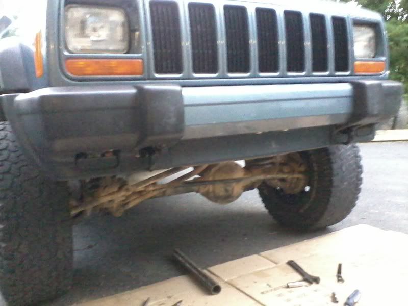

Spent the first part of the day cleaning the Jeep up really good.

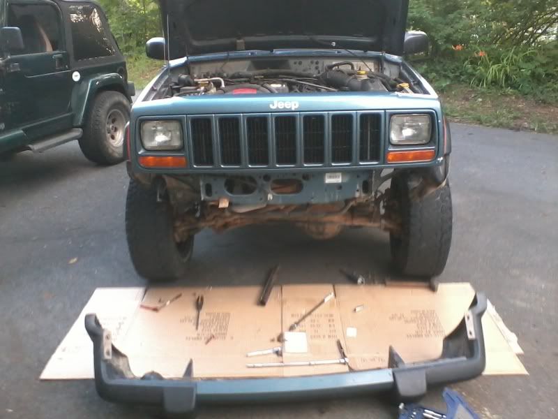

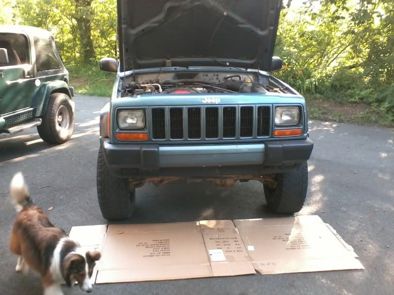

Then this evening Stephen and I got the front tow hooks on.
Getting started.
Bumper off.

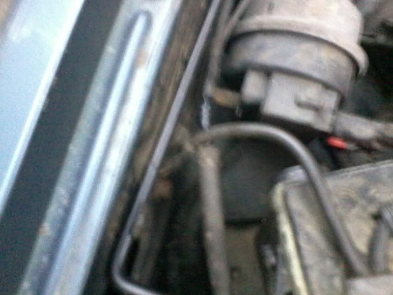

While I had the emissions line disconnected I re-routed it under the ground line to keep it away from the hood prop clip and out of danger of being pinched again.

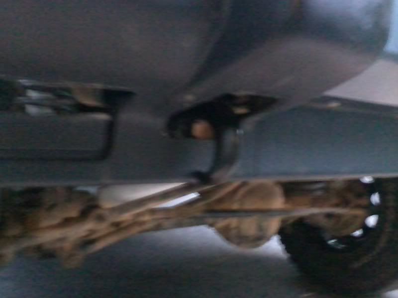

Front recovery points are done.
All finished, took about an hour.

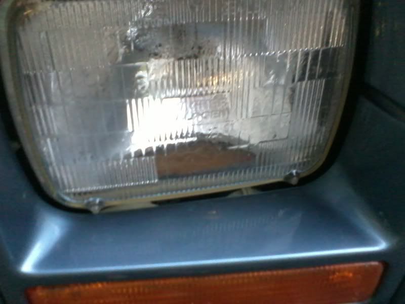

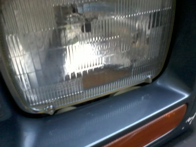

I also noticed today that I have water and mud inside my headlights haha. I'll replace them eventually but they still work fine for now.
Ridiculous.

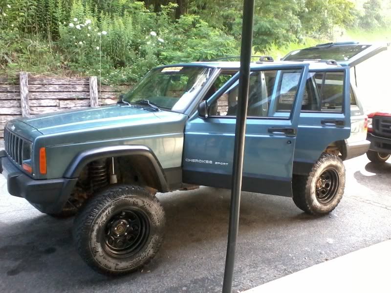

I'll be getting the DuraTracs as soon as I finish saving up the money. Should be by the end of this month, if not maybe a few weeks into August. As for my lift it is the 3" Rough Country Series II kit with full packs, combined with 1" Daystar greasable shackles in the rear and 1" solid spacers in the front. Realistically I'd say the rear was lifted just under 4" and the front was lifted just over 4". I'll eventually get a slightly smaller spacer for the front to help level it out a little more, but for now I'm satisfied.
