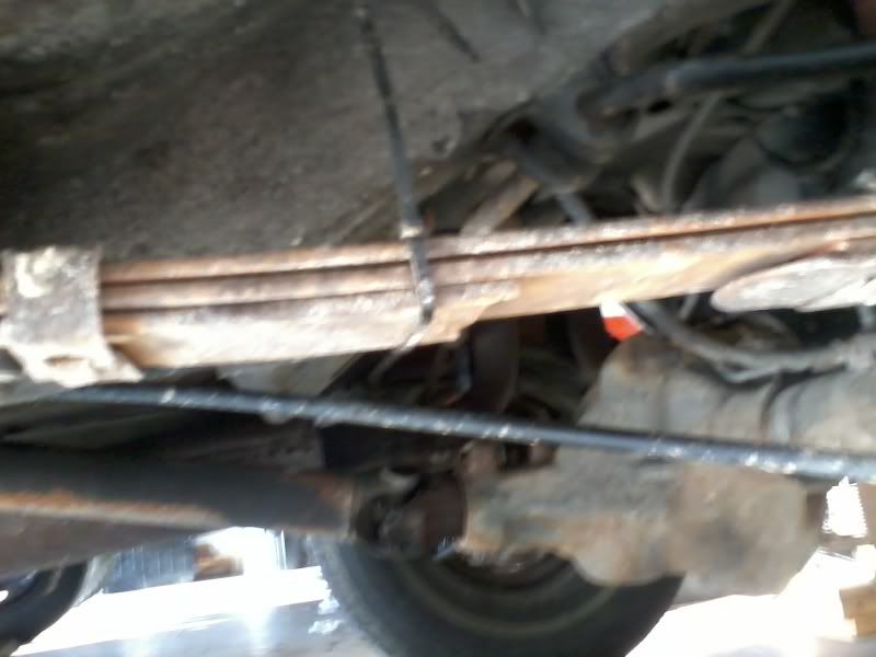

I ziptied the broken leaf spring so that it would stop flapping around while I was driving. I could hear it even with the windows up and couldn't stand it anymore.

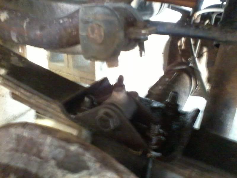

Stephen cutting the leaf and torching the shackle bolts. HUGE shoutout to him for all the help, I definitely couldn't have done it without him.
Even though I had been soaking the nuts and bolts for days with PB, they were so rusted and corroded that they simply wouldn't come out like they should. We had to get radical with some steps and it took much much longer than it should have to finish the rear, but it is done except for the shocks. I have to get the upper shock bolts out since all 4 broke.
This is a picture of my factory shackles, the shiny part is all that was holding them together, they were unbelievable rusted out.

The upper shackle bolts were completely trashed by the time they came out, and the weld nuts inside the body were busted and laying inside the rail. I took the rear bumper off, cut out the access hole, and got a new nut on the end of a new Grade 8 bolt.
