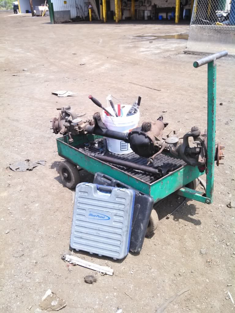

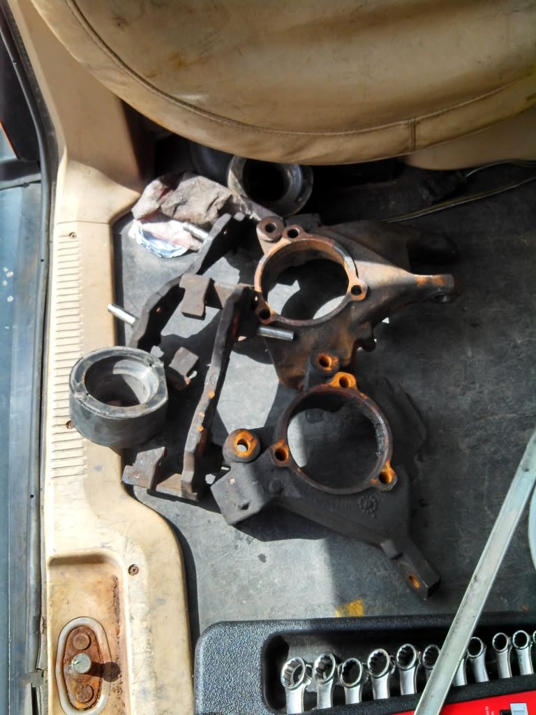

Went to Harry's u pull it. Couldn't find a non crazy rusted 30. I'll just reuse my other one now. Got wj knuckles, wj caliper mounts, chrome trim for the bean, and 2" spacers. All for $60 I'm pretty happy with that.

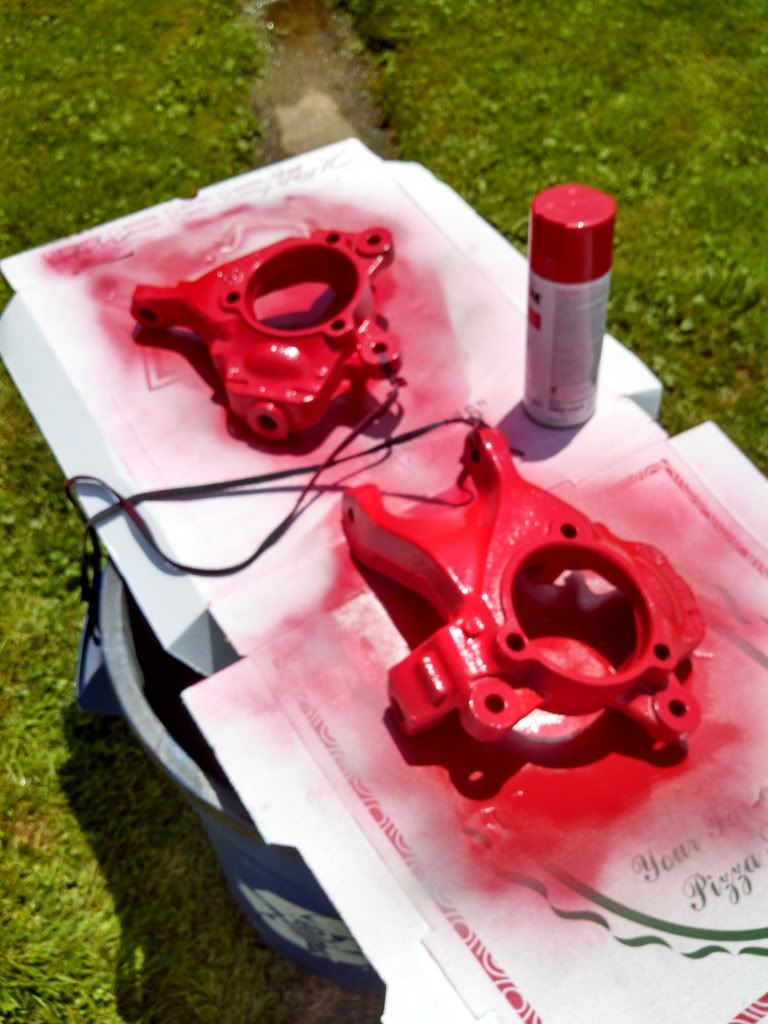

Decided to try something different. See how it looks

post #1459 of 2292 Old 06-16-2013, 01:31 PM
Weeder1
Location: Lakeland
Posts: 1,099
I like that. Ive been wanting to do the swap lately.

Paint the diff red.

What did you paint that thing with using a brush?
Joshharris98xj is offline
post #1467 of 2292 Old 06-26-2013, 07:12 PM Thread Starter
Spokes
Location: Plainfield
Posts: 6,333
Yeah just brushed it on good and thick.
You know those are the teves caliper mounts right? They are know for warping, the later akebono mounts are a better design.
I would also highley recommed boxing in the passenger upper control arm mount and adding in mini skids to the axle you are building up
And another note, It has been pointed out allready but you CAN NOT run without a stubshaft, just want everyone to be clear. The hub failed becasue there was no stub shaft in there to support the bearing.
