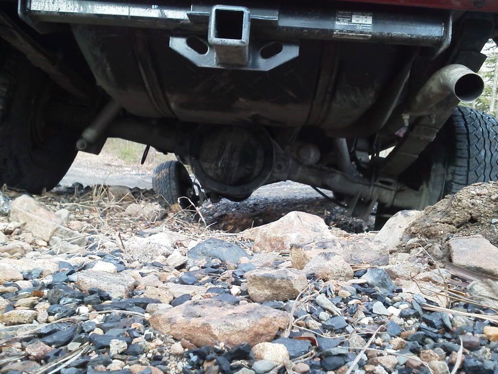

Forgot to post this pic from last weekend though it was cool.

Durt_Diver
Location: Provo
Posts: 2,421
i almost mistook that for a d35
*slap!* haha nope.
