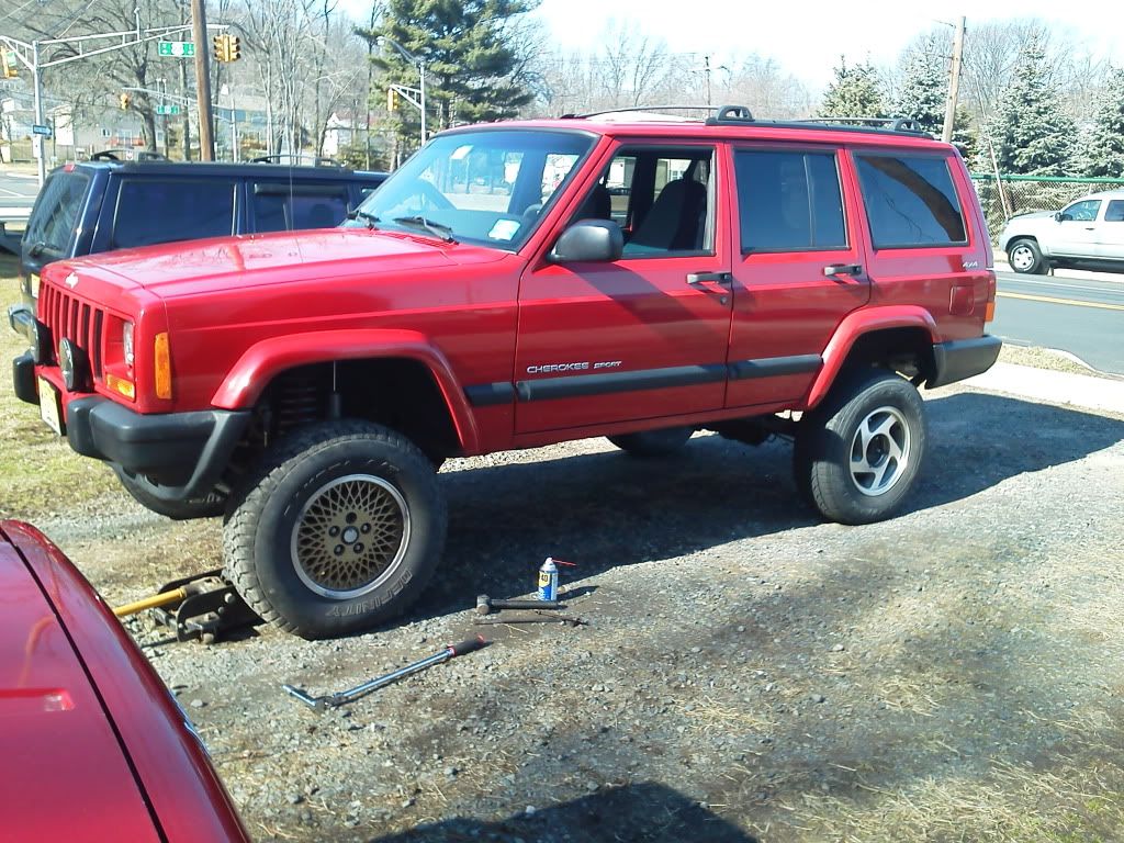

The jeep looks good with some mud on it. And it seems like every jeep can't go into 4 lo.

I ****ed with the linkage all day today. It's bent some how guess PO bent it somehow do I have to either get a new braket or pull old one off and bend it. The bushings were shot and my local jeep dealer can't get them!? Any idea where I can get bushings??? Ugh haha
Jeep has a bad wobble at 52-62 new wheel bearings front end is tight. So I figured maybe the tires were bad. So I threw my dads definty Dakota's on there off his 90. No shake with his tires so mine are junk. :/
I actually like te gold!!

My linkage was bent from when my motor mount went bad, I just grabbed one from a junkyard. There is a tcase bushing kit part number 05014148-AA. I remember seeing a place online with the kit but I forget where.
Edit: jeep4x4center.com has it. Part# 5014148AA for $21.99

Yeah why not just keep those rims and tires on there from the 1990 since it doesn't get used until you get your new tires? Also whats with the LOW RIDER position in driver's seat?!?? hahahahahahahahahahaha!!

King - there my dads and he doesn't want me using them. And idk what your talking about, the seat is close as hell And almost straight up haha I sit super close to the wheel. I was cleaning the inside so I did move the seat maybe that is y it looks far back? Idk but I the furthest thing from a gangsta lean hahah I deffinatly a white boy haha

Hahaha, idk it just looks from the picture that the seat looks really reclined. I laugh every time I see some Honda or something with the seat reclined over half way back, how is that comfortable at all? Or safe?!??

You really should keep atleast a jeep rim on it and not fords. It looks way better with the gold rims and I don't really like them in genarel that much. I can see the light and it is almost the jeep with a lift a tires it wants to be lol but looks a lot better with different rims
