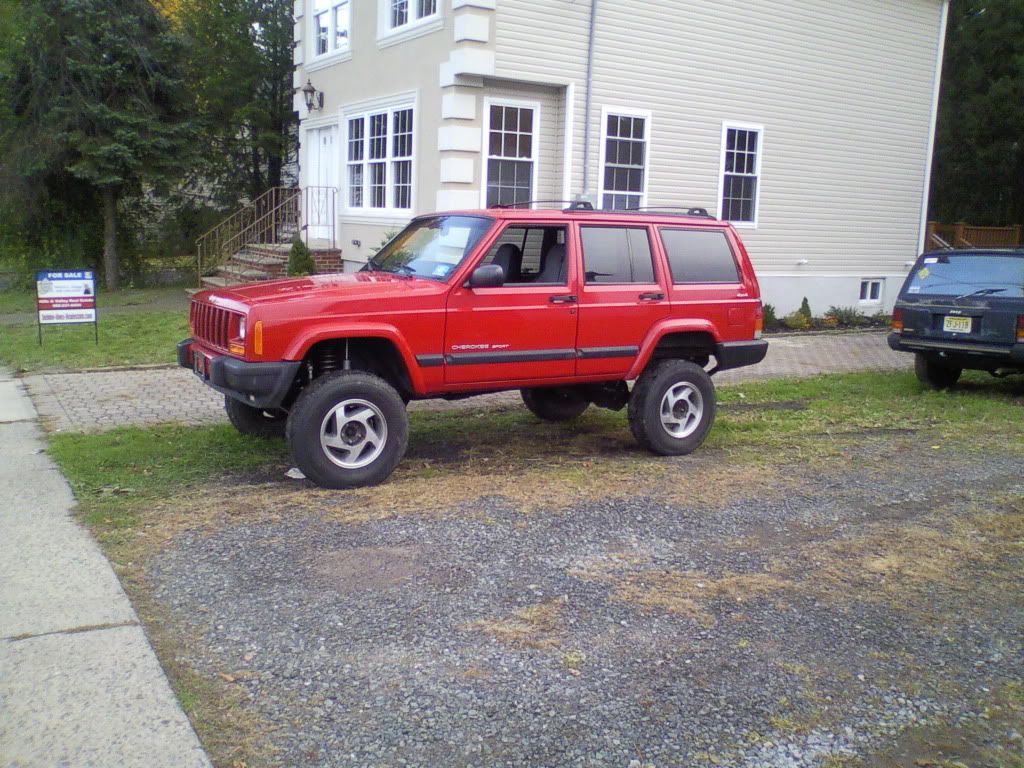

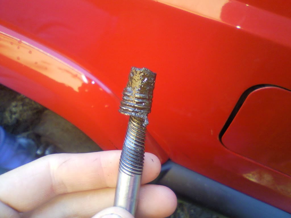

well here is the bolt that we had to cut outta the leaf spring... pain in the *** gettin it out! bolt was hardend so it was a pain to drill. but thankfully the easy out worked and didnt snap!
and here it is!!! lift is complete. rear is stiff as hell... but i got an alignment so its all good. the rear DS angle is like 75degrees def need to get the SYE installed... i went to install the t-case drop and the 2 bolts busted havent even tried to pull the studs out yet... might just install the SYE in the jeep and drill out the bolts and thread in new ones.
