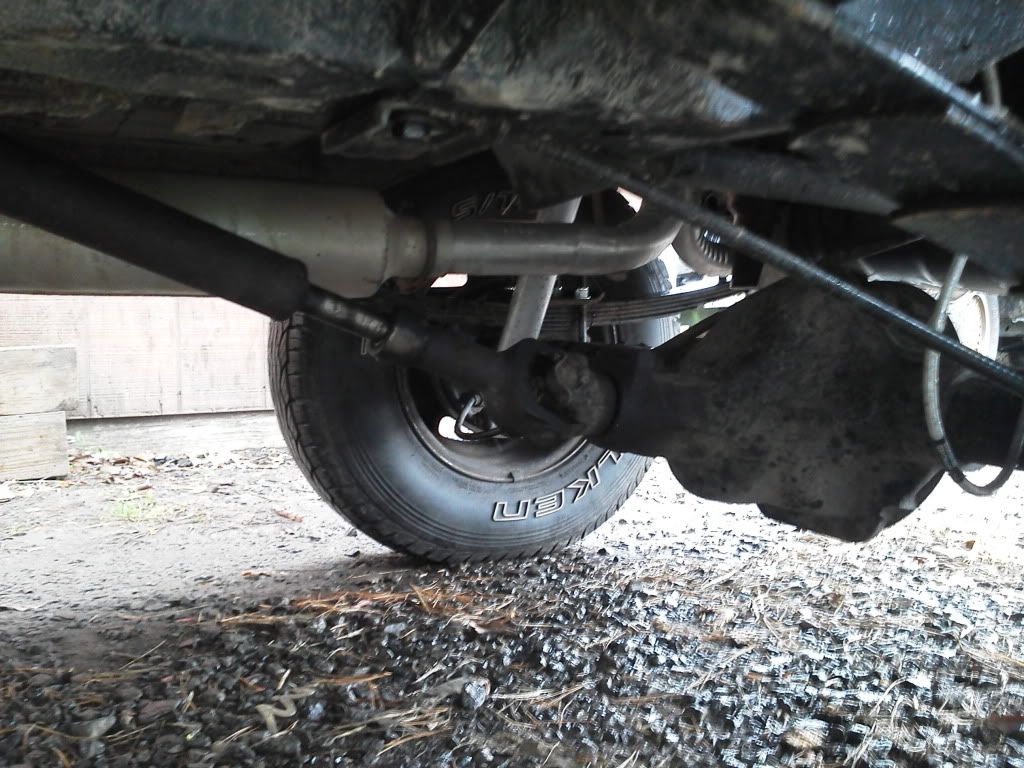

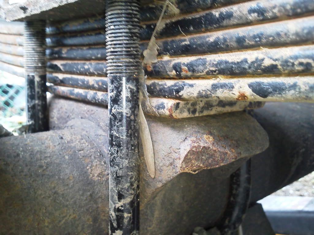

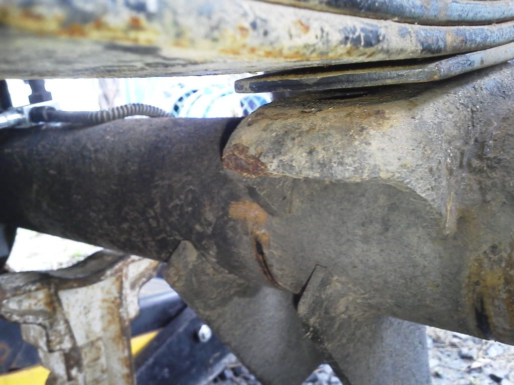

i looked at shipping prices, UPS wanted almost $500 to send it al back!!! so needless to say im keeping the lift. i just finished rotating the little shims on the leafs, now they are facing the right way.
before:
after: (didnt tighten u-blots yet) that is how much it will shim it.
Before:
After:
its better, but i think it still needs to me shimmed more. the jeep DEFINATLY rides better now that the leafs/rear dont have that added stress on them. much much much better!!
the front still gets a slight death wobble and doesnt feel right. im thinkin the track bar bracket is egged out causing the track bar to have slop. also wondering if i need a new pitman arm drop to help equal out all the steering components.

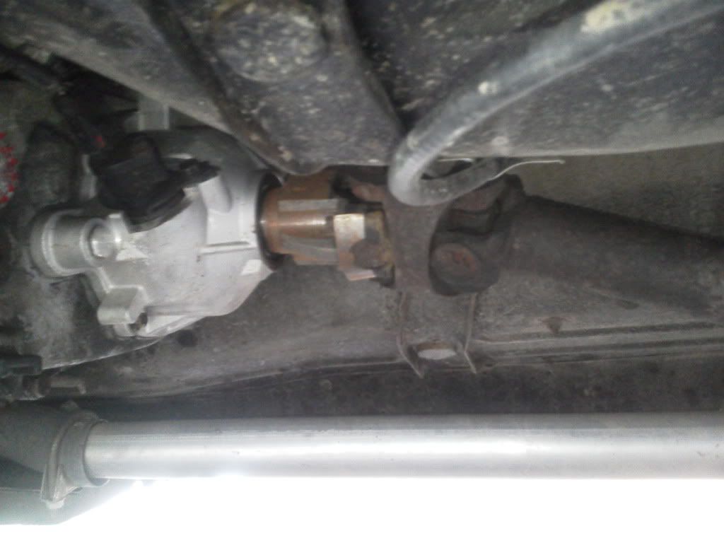

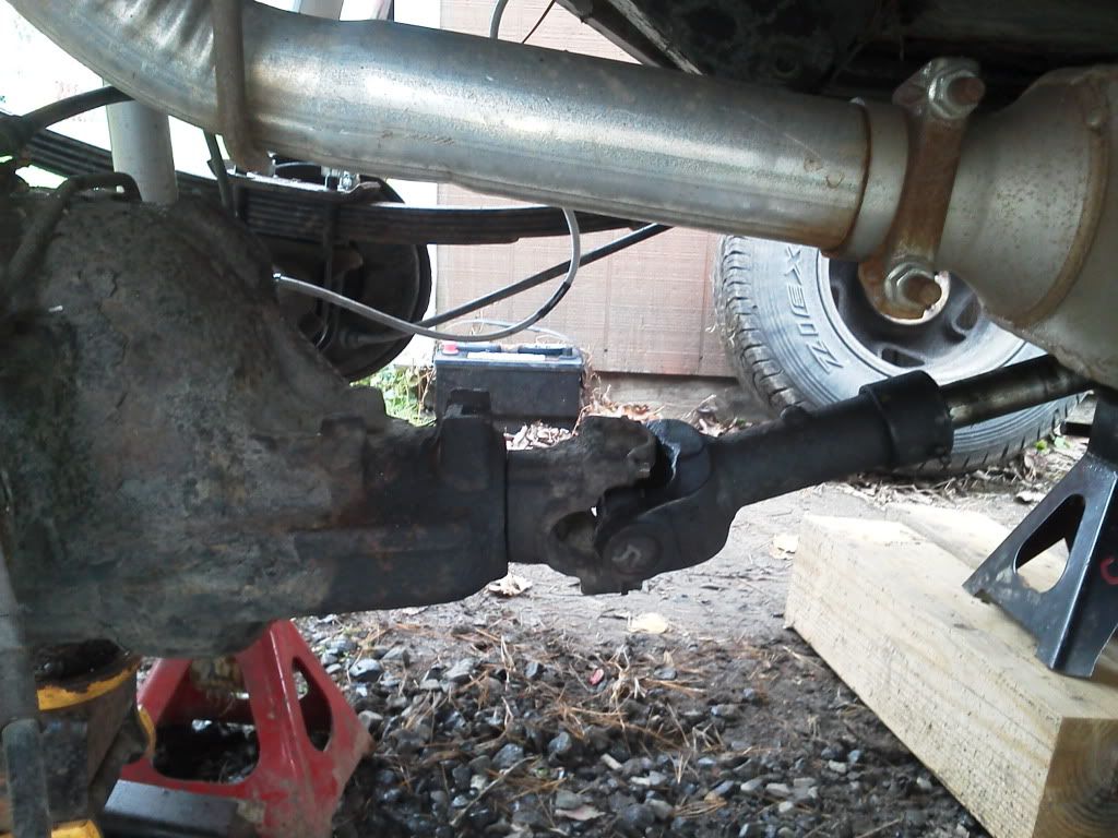

here is the DS angle at the SYE... think i may have to install the t-case drop or a longer shaft to help reduce the angle.

What degree shim are you running?
what ever came on the RC leafs...
Red 00 XJ lifted
Build -->
Blue 00 XJ Hella stock
"Lima bean" 91 XJ 5spd
Spokes is offline
post #344 of 2292 Old 11-29-2011, 11:19 AM
pumpkinXJ
Posts: 378
It might not be enough for the height its sitting at. when they sag it should be fine.

yeah but for right now its not working lol any idea what * shims i should get? the angle at the SYE kinda worries me.
