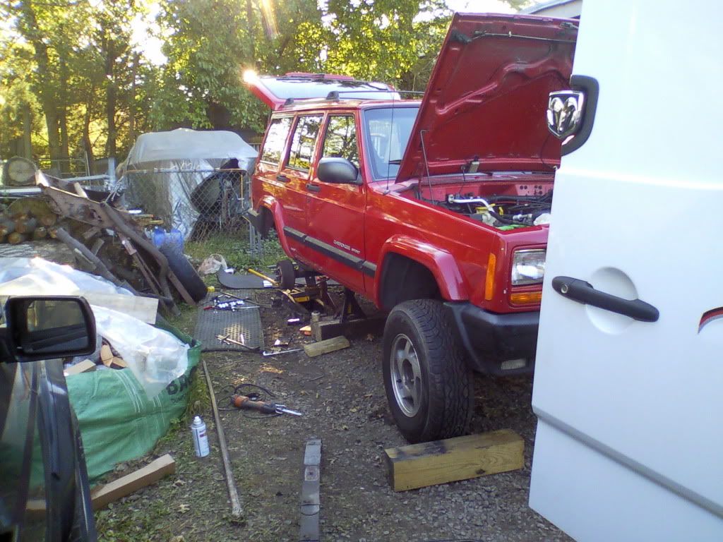

today got the front end done. and one rear leaf. the pass side came out really easy and went in easy... but the driver side the bolts/sleeves were siezed together. couldnt back out the bolts... so i had to cut the bolts. cant owrk on it tomorrow so thurs ill get the little bit left out and hopefully finish it up thursday. but we will see

that is my dads 90. he bought it for 600 bucks and gave it a rattle can paint job and some tires and its sweet... but the trans just blew at the end of the summer. so for now its just sitting there
