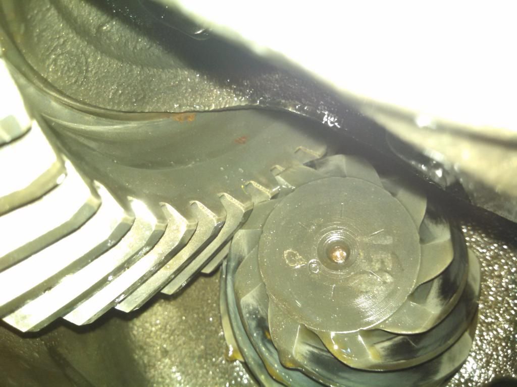

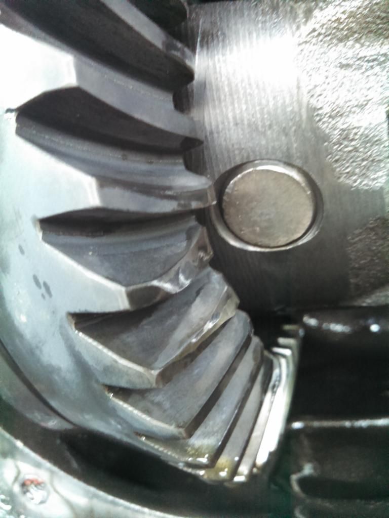

I pulled the rear diff cover tonight to change the fluid in the rear and see if i could figure out why its making a noise... pretty sure the gears were/are too tight. the pinion is discolored and look how they half *** shaved the gears... ****ing pissed!!!

Did you break it in properly?
Put some
Paint on that and rotate, I would love to see that contact pattern.

They did not tell me how they would recommend i break them in. I did drive them about 15 min at varying speeds. It sat for about 3 hrs than drove it about the same distance and than it sat over night.
Im not gonna paint em cause ive already wasted like $60 on freaking diff fluid over this ordeal.
This is the last message i have coming from the owner of A to Z fab.
"We installed what you had to the correct specs. If you supplied a bad set of bearings or a bad set of gears, and Motive is notorious for this, there is nothing we can do. Our most recent set of bad 8.25 gears were Motive and I will not purchase them again for a customer. I apologize, but that is the honest truth. The slight grinding of the tooth to get the stock crosspin installed does not create an issue and is extremely common. Please let me know whom to speak with that has installed 4.56 gears in an 8.25 c-clip axle so I can find their secret. If they are grinding the pin they are mentally challenged as that can indeed cause issues.
-- Zach Vaughn.
AtoZ Fabrication, Inc.
570-385-3931 "

This is the whole convo as of now.
Zach,
I pulled the rear diff cover off tonight to change the fluid and to inspect the gears... honestly what with what I see I would like my money back and be reimburse for the gears. The rear pinion has blue coloring all over it. And the guy shaved WAY to much off of my ring gear to clear the pin. I would much rather bought another carrier than have 2 half gears. Im sorry to be a pain but this is just unacceptable. I am still getting a pretty noticeable humming noise while driving and it is only getting worse.
- Jordan
Jordan, I am sorry that you are not happy with the install, but since we did not supply the parts and the gear pattern and specs were checked twice there is nothing more that we can do. The gears and bearings that you supplied were installed to the manufacturers instructions, including the grinding to fit the carrier pin. Unfortunately, it seems that some manufacturers have issues with their 8.25 gears and/or install parts. We have had humming issues with two sets over the years. On both of those cases we had to return the gears/install kits and have them replaced under warranty. Without us supplying the gears and install kits the best we can do is to install what was provided to the best of our abilities.
P.S. Please inform me whom Maggie Platko is so that I know with whom I am communicating with.
Thanks.
-- Zach Vaughn.
Zach,
I just read through motives gear install process and there isn't a single thing about grinding the gears? I have also spoke with multiple people who do gear installs and none of them said they would EVER grind the gears. They would simply get a new carrier. I did not know that a new carrier would be needed and I much rather would have had you call me and tell me there is an issue with clearance before you go and grind away.
This is also why I took it to you, a shop so it would be done right. Not have it be an issue like it is now.
-- Zach Vaughn.
My plans for now is to get an 8.8 under is ASAP. i wont have the coin to regear it right away so ill have to run 3.55 or 4.10 for a while and ovbisouly no 4x4 til the axle is regeared. hopefully i can do it before winter! The axle is getting worse and I just had to retire the limabean from the road So now red is my DD again and i have a ****ed up axle under it. I would really like some input on what you guys think i should do? Sue??? I mean in total with material, labor, and misc parts i am around $1500 into the gears. $600 to buy them, $600 to install, Fluids, RTV, Etc. I mean this isnt some cheap ordeal. I really am frustrated over all of it and it simply sucks.
The other issue that worries me is that the front probably is off too. granted the front doesnt get the stress of the back it still has me concerned.
thought and input are appreciated.

post #2035 of 2292 Old 09-01-2014, 05:04 PM
Teej
Location: Whippany
Posts: 1,172
I know one of the two needs a new carrier at 4.56. I thought it was the 30 but idk. Did you have a new carrier for either?

post #2036 of 2292 Old 09-01-2014, 05:10 PM
IDIdiesel
Location: pittstown
Posts: 769
Suing might cost more than the hassle is worth. A to Z will fall back to the fact that you supplied the gears and say it was the reason for failure. SInce the bean is off the road...what axle does that have? Maybe swap that under Red for the time being. You know its a good axle and will bolt right up in a matter of a few hours. Bean is gonna be built bigger so no need to keep its rear axle under it. Toss Red's axle under Bean so it can still roll around

post #2037 of 2292 Old 09-01-2014, 05:10 PM Thread Starter
Spokes
Location: Plainfield
Posts: 6,333
I put a carrier in the front, yes. The rear i did not realized needed one until now, but still that doesn't justify him to grind the gears.
