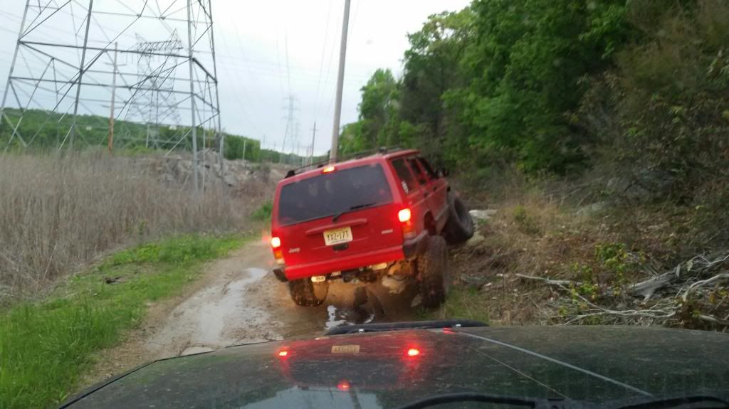

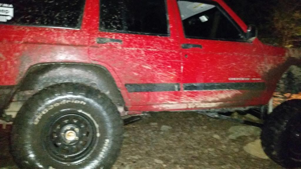

Did some wheelin with Teejay last night. The arms do 100X better offroad than the RC crap. Now i just need to get the back to work a little better
If you follow me on IG youve seen this before but idc i like it so here it is again haha and if you wanna follow me its @jordan250r

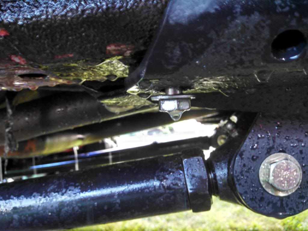

Was washing the jeep off good in order to go rear main and valve cover gasket and noticed this... idk if the bolt backed out or pulled somehow. Gonna monkey with it eventually lol

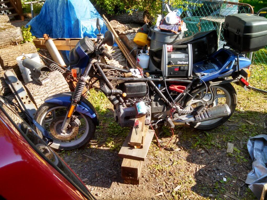

Been messing with this damn thing trying to get it going. Germans over engineer stuff way to much! Really have the itch to buy a new 600 crotch rocket, R6 or cbr600rr. but that means cutting into my jeep money... hmmm.

Thanks. Still gotta do the seals and radiator and figure out why that bolt came down. Than gonna have it regeared soon. Than hopefully I won't have to mess with it for a while lol

Discovered that the crossmember bolt that was hanging down low was stripped out so now i need to figure out what to do with that? Thinking just tap it to the next bigger size and lock tite, or drill it out a little and through bolt it?
