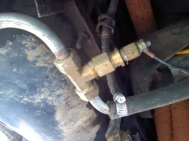

The gauge seems pretty simple, i guess for the cooler itself ill just need some flex hose and run it into the new cooler and not the one in the radiator itself?
For the cooler I ran it from Trans> Radiator cooler> Trans cooler> back to trans.
Getting the fluid up to operating temp is important and running it through the radiator will help get it up to temp.
Gauge install is pretty simple, you just have to decide if you want to put it in the line to the cooler or out of the cooler.
I put it out of the cooler going back to the trans, IMO its more important to know if the fluid is getting cooled enough or If I need to stop for a bit. Reading before the cooler just doesn't give use full info IMO.
I put in a CSF 3 row 4 years ago and no issues, I would recommend it to anyone. For sure put a new water pump in while you have it all apart, a new Stant OE pressure radiator cap is also a good idea.
Ok will do, do you have any pics of how you ran the trans lines?

Only pic I have is where I put the sender... but I ran the cooler lines threw the oval hole in the front header panel to get in front of the radiator, I put the trans cooler in front of the mechanical fan so it will always have air flow.
