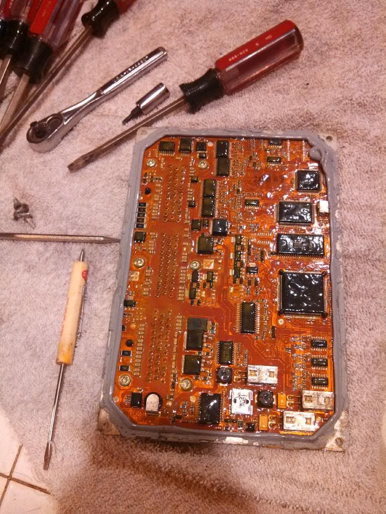

i think the ecu is the problem. cause when i throw the other ecu i have in the relays and fan dont do anything. the gauges still dont work and i get no bus still but i think that is from it not being flashed to my jeep. tomorrow gonna see if i can get it flashed.

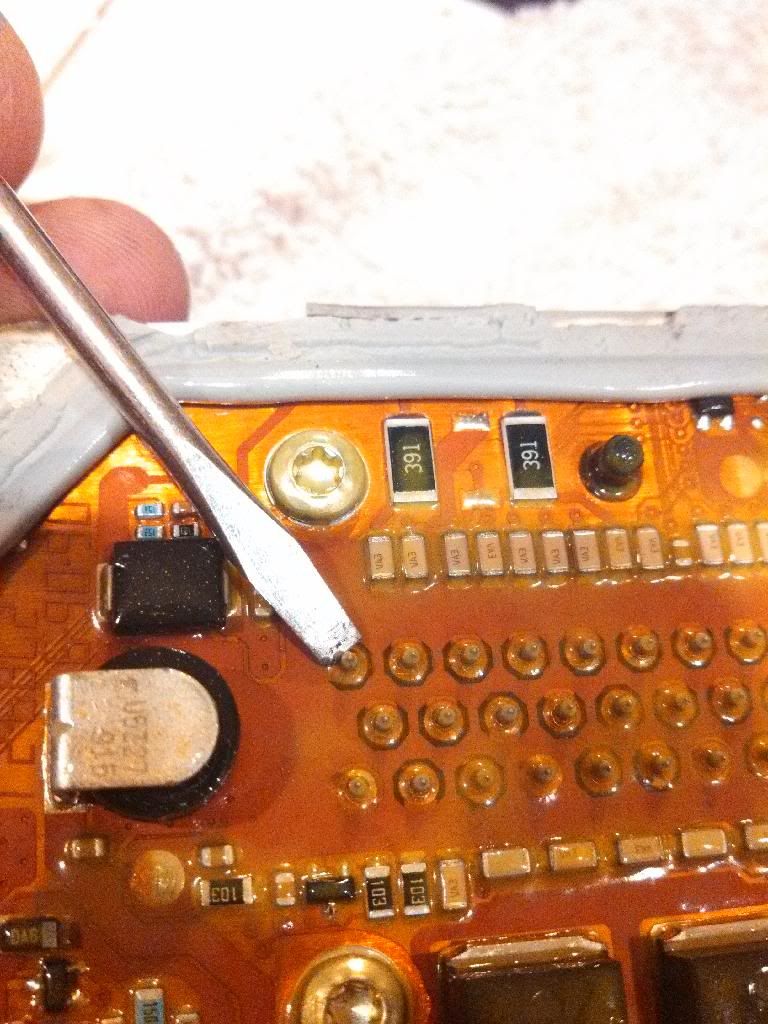

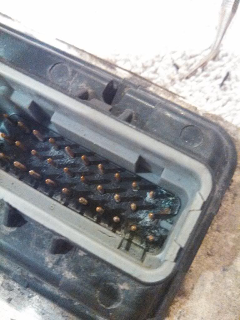

this is the one that was out of my jeep. notice the corrosion. and the missing prong
To be honest I have never unplugged the tranny in a xj only on other vehicles. Take a look around if you find it unplug it and try I fire the thing up. You could be on to something there but it's hard to sliver that little amount of corrosion would cause the issue.
ill look around. it makes sense that the ecu is bad cause with the other one in the relays and fan dont come one cause the short isnt being caused... if it was wires rubbed or something the ecu wouldnt have an effect.

Good mechanic friend did some researching for me and found out that the prong that corroded off my ECU is the power feed to the PCM from fuse 22, 15a under the hood. looks like another ecu matching numbers or reprogram the one i have SHOULD be the ticket.
