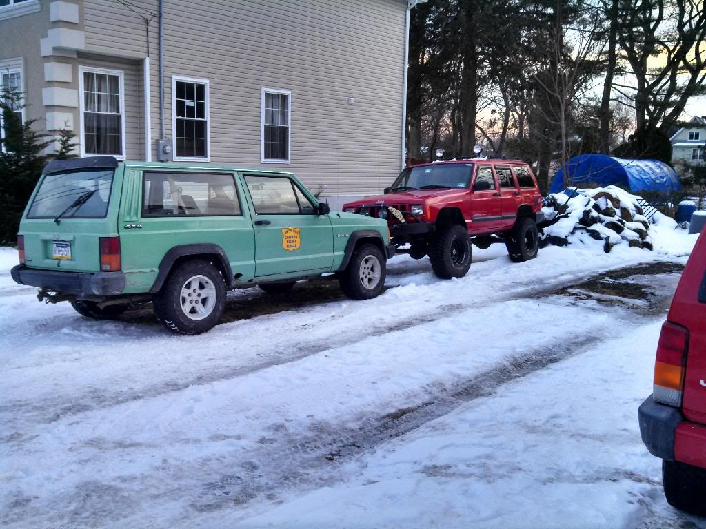

Haha anyways got red jeep running again!! Put in another cps. Nothing. Started checking connections and found some corrosion so cleaned that up than check the ECU the 3 connectors were all corroded and the one is missing a prong? But once I cleaned the real good the jeep fired right up!!! Started it probably 50x today just to make sure haha
Gonna put in the steering tomorrow and I'll be set for now lol
Reunited again Lol
