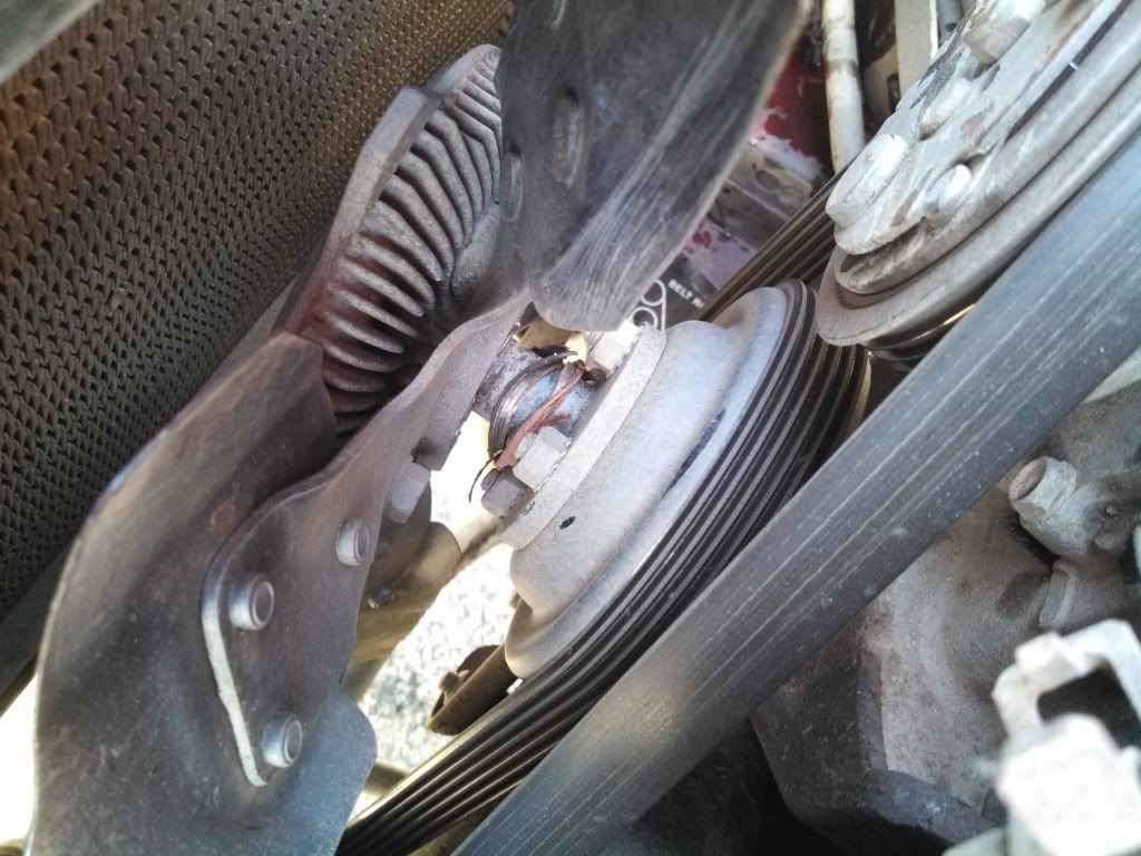

Jeeps been having some weird vibrations over 2500rpm. Thought it was the exhaust, well driving down the highway at 70mph I found out what it was when my mechanical fan blew apart. Thankfully it didn't get my rad.
Pulled over and pulled it off and drove 2 hours with the fan. Thankfully it was low 70s so the jeep didn't get hot. The power/mpg without the fan was much improved so I ran to a local JY and grabbed me some Taurus fans, unfortunately they only had '99+ Taurus' there so I figured it still better than nothing. Got both for $10 with wires! Lol couldn't say no! Wired the one fan in, I just ran power from batt, 30a fuse into a 30a switch and did it plain and simple for now since I needed the jeep running ASAP. Jeep runs a little warmer than it did with the mechanical fan but the power is 10x better. There are 3 wires coming off the motor and only found out this morning that its 1 power and 2 ground for hi/low. So I'll less with it later today. If I can get it to run on High hopefully that'll cool it more. Also need to rig a shroud up that will help more also. But for now it's drivable, now just to fix the ****ting steering!

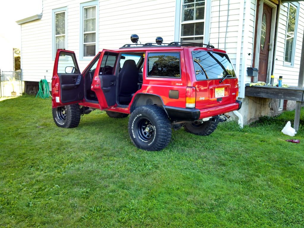

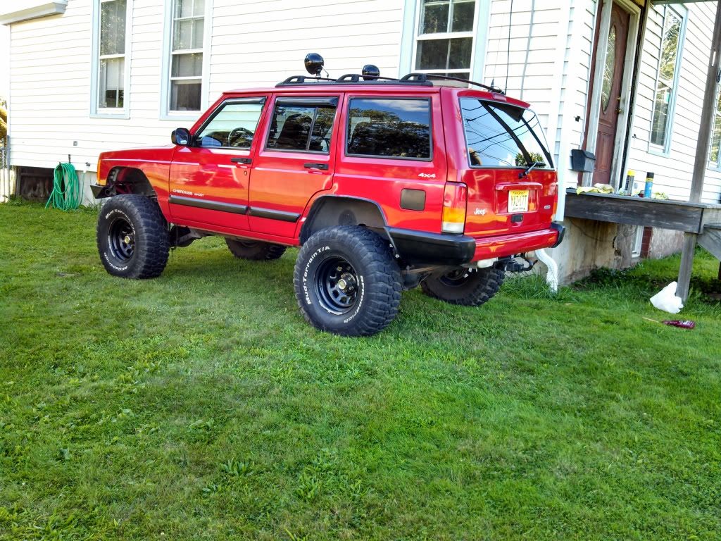

It was easy. Air hammer the pins in half, knock em out doors come off lol I have full power everything. We cut the hinges to make em like a wrangler. I just lift and drop. Passenger side has a little sag but it did before I did this. I'm gonna get some bushings and should solve the problem.

I just drilled mine out a little more and used bolts instead of pins. I still need to do the rear doors, but left them on until I get the tube doors made, because I haul the dogs and kids a lot.
