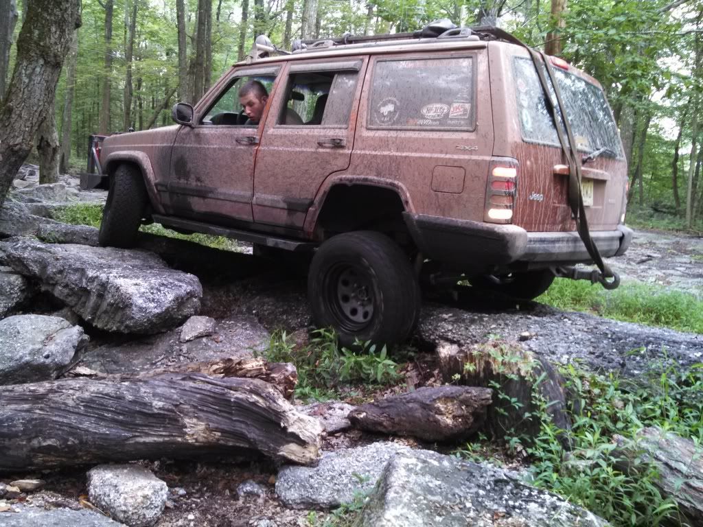

Broke in the new axle. Was going through tall grass and slammed a rock with the pumpkin. thankfully didnt bust the cover think the bolt took most of the hit

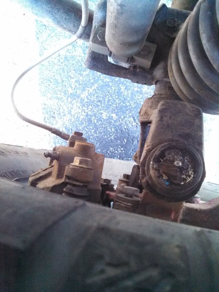

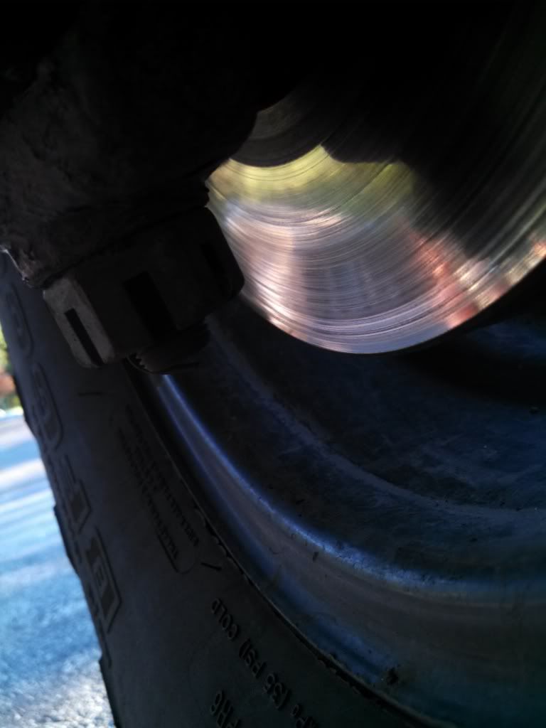

Just looking the jeep over and noticed this! Caliper bolt backed out glad i caught it!!!
and noticed the new rotors are already getting grooved
Mine did the same thing, took me forever to figure out what was making that clunking noise lol.
Yup clunk is gone. I thought it was the rear brakes. Guess not lol
