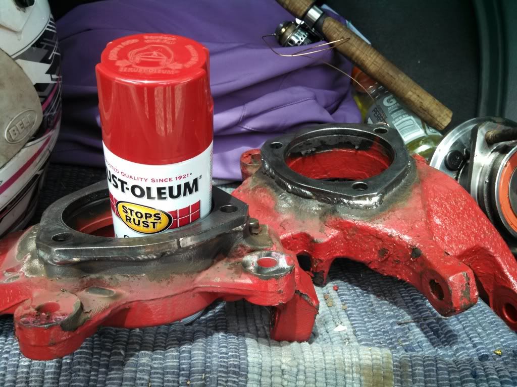

Did you replace the lower XJ balljoints for WJ balljoints and is there a reason your not using the WJ style steering setup?
Also can't really tell from the pics, but you did weld the spacer on right?

I used both upper/lower wj ball joints. And I'm running stock steering for now cause I'm not made of money haha
As for the spacers they aren't welded on. They cannot move or anything as long as bolts are tight. Its not mandatory to weld em.

I have to disagree, without welding the spacers on part of the vehicle weight is now on the hub bolts instead of all of it being on the knuckle directly.

I'd weld them, chance are you'll be fine without welding them but hey do ya really wanna do this all over again?

They must be welded on! In stock form the hub drops into the knuckle and the bolts are in tension holding it all together. With the spacer, now the hub drops into it and without it welded to the knuckle your putting the 3 bolts in shear load to hold it all together...
You are asking for a bad failure by not welding the spacer on.... like when you run without a stub shaft in......
98 XJ lifted/Locked/Geared

True. Honestly it probably would be fine but for extra strength I'll weld em.

A to z fabrication welded em up for me. Good to go now. Just need to get rotors back!
