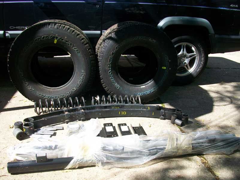

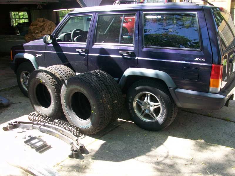

ok so iv been savin up some stuff to put on but I need the pieces to finish, pic's of my stuff so far ; Good Year RTS 31 10.50, new leaf springs from an upcountry jeep model and new coil's from an upcountry model i believe the upcountry model sits 1/2 inch or so higher from factory , and some 1.5 shims some coil isolators some reinforcement plates and mopar rock rails, what do you think of this stuff and what else will I need to fit them tires ?

Wow I am so glad you posted those 2 pictures. I been dreaming of a kit for a while now. I don't offroad, just drive on trails to get to rock climbing sites and what not, and i have no idea what size my stock tires are on my jeep, and how much bigger 31's are... 31's look like a fine size now that i see that.
