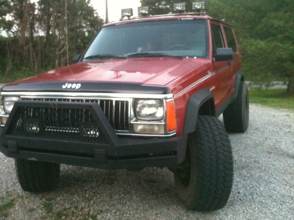

Anybody done this or have any pics. What would you have to do I've never used any bed liners. Would under coating be a good idea also?

Did my front bumper and rocker panels worked pretty well. Really easy.
