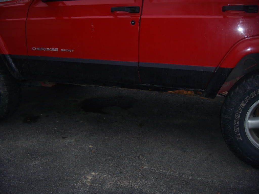

Monstaliner wasn't around when I did my rockers. I bought a U-Pol Raptor kit, comes w/a spray gun and a 2 part bedlining system, enough for 110 sq ft. Below used 1/4 of the supplied material to do both sides.
It only sprays on @ 35 psi so it doesen't take a big compressor or anything and the kit was $110 to my door, from TPtools.com . Hasn't faded in 2 years, the prepwork took the majoritiy of the time but the results are worth it.

^^^urs looks awesome. I may have to buy that kit. Thanks for the infi and pics. Exactly the look I wanna go for....except my XJ is green.
