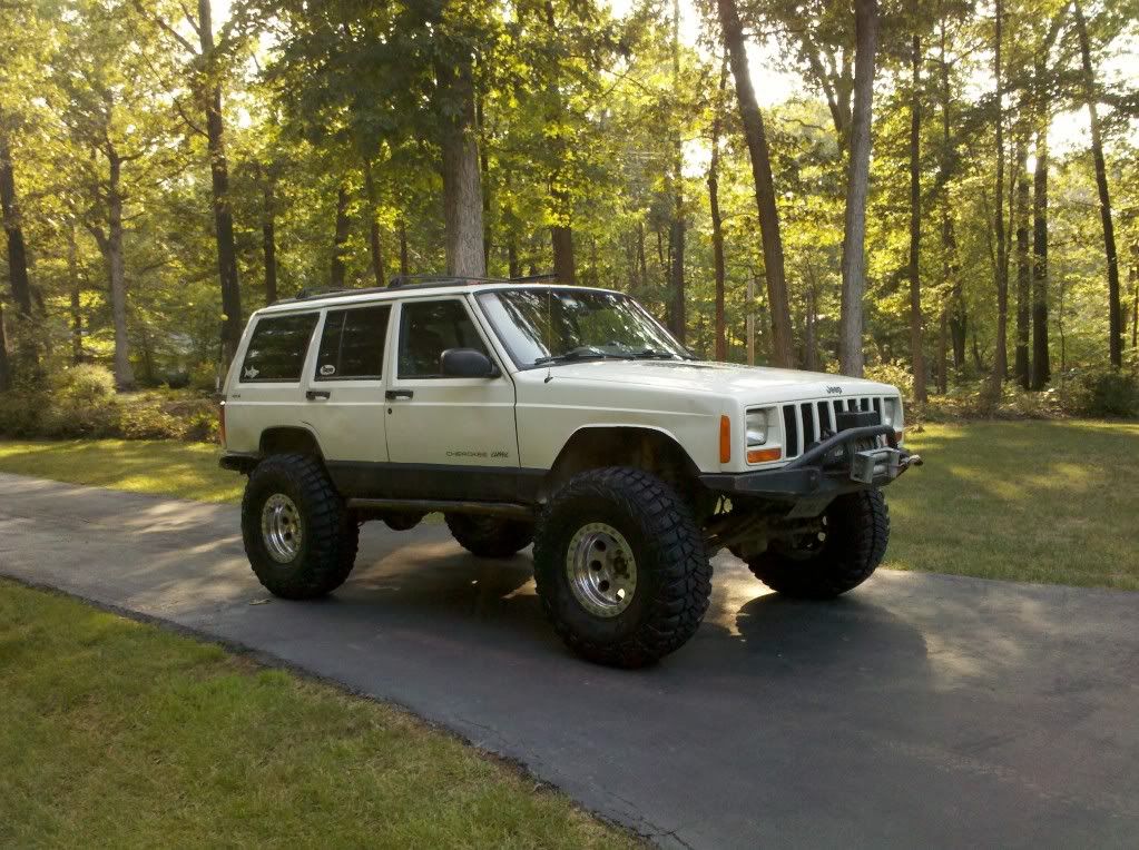

post #7 of 22 Old 08-15-2011, 08:19 AM
96jeepchero96
Location: Taft
Posts: 37
Here's mine. I used the roll on stuff. And did a 2 coats.
